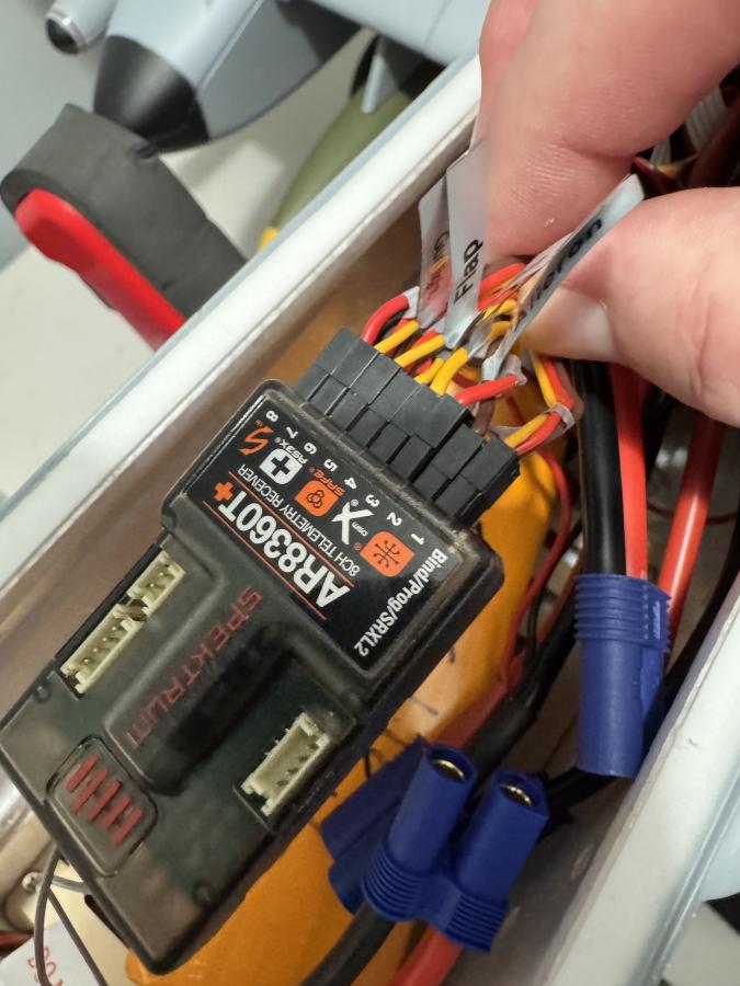

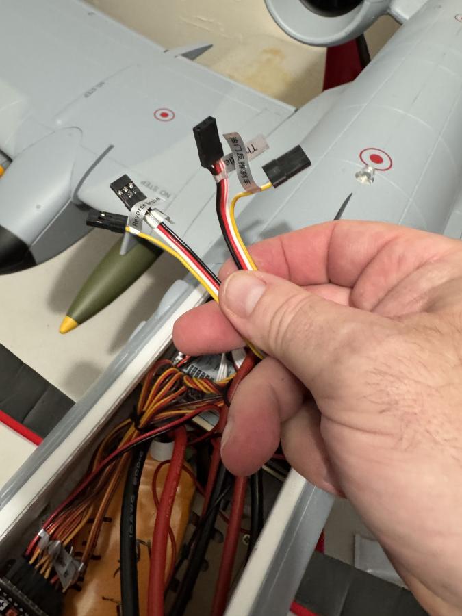

      Okay she’s all put together but I can’t get any throttle action. The ESCs are beeping at me (about once every two seconds or so). I’m sure I’m missing something basic but I’m confused why there are three throttle servo leads photo below). The diagram in the manual shows throttle in the 3 position to the rx which I found odd. I tried both positions (1 and 3). The UBEC is plugged into the last port on my receiver. Tried calibrating the ESCs. Still no luck.
      Everything else works fine. Gear, controls, lights. Any help is greatly appreciated!

        That diagram in the manual where is says port 3 for throttle is a misprint. Don't pay attention to it. Those two cables you're holding are the 2 throttle leads. They should be "Y'd" together and put into the throttle port (channel 1) of your RX. The yellow single wires are the reverse throttle signal wires. If you use reverse, those should be "Y'd" together and plugged into an empty channel that can be controlled by a switch. To get yourself that extra needed port on the RX, plug the UBEC lead into one side of a "Y" on ANY other channel. Once you get the throttle working on both motors, THEN do the throttle calibration.

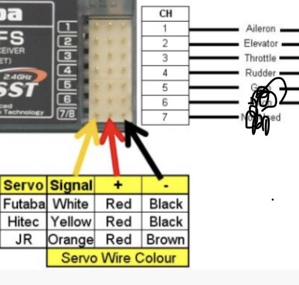

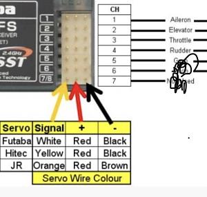

          And what you have in Ch2 is upside down.

            Thanks xviper!!
                I just went to check the wiring on mine and the AIL, ELE and RUD channel leads are all single wire ends, so regardless of color, all those single wires are "signal" wires, so it appears his ch. 2 is AIL and it looks like it is correct.
                Double checking my wiring, I see that Aros's throttle/reverse wiring is on a single 4-wire cluster with 2 end plugs one each, while mine are separate. In the picture Aros put up, he needs to peel back the single reverse wires a bit and put a Y to connect both. On mine, I have 3-wire throttle AND 3-wire reverse leads, although I suspect only the signal wire is needed and the others is to make sure the end user doesn't put them on backwards.

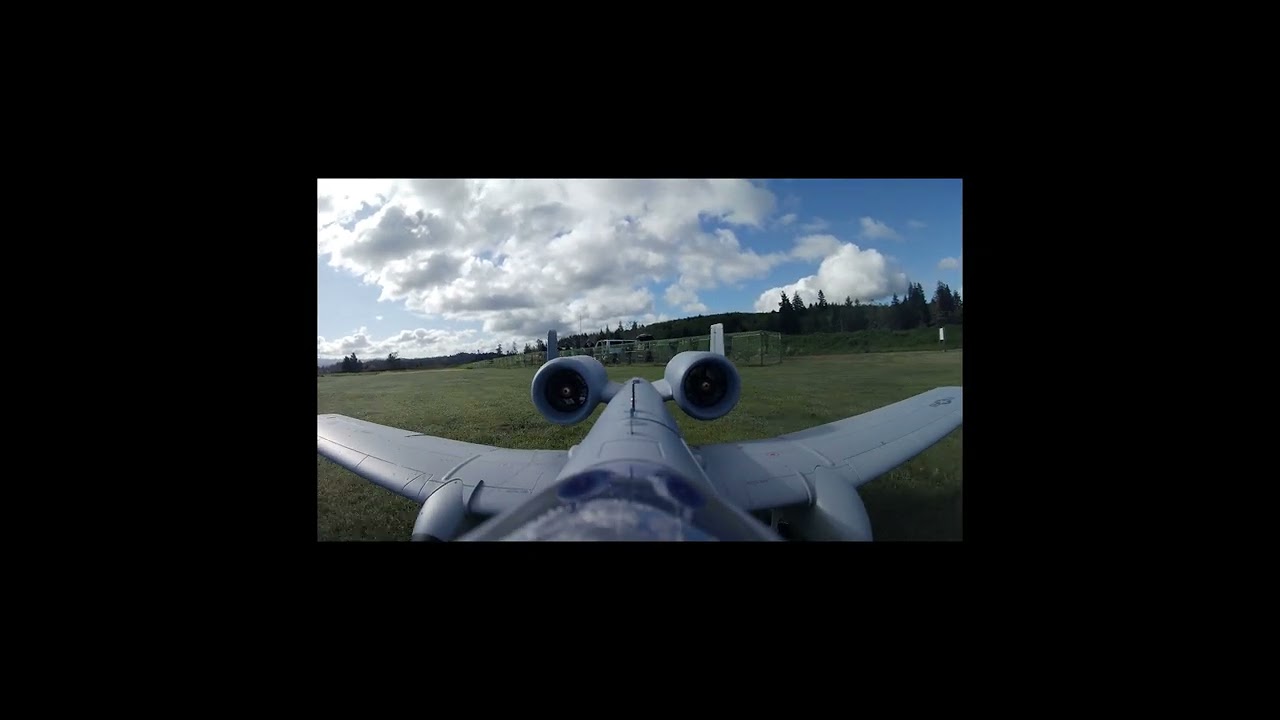

                        Maiden flight was great. No issues. Just a few clicks of left trim and she was dialed. Very easy and fun flyer. Problem was the landing. I grossly miscalculated where I was on the field. My depth perception ain’t what it used to be, that's for sure. Where I thought I was getting ready to touchdown on the mowed grass, I was a few feet further out and it hit the tall grass, spinning unceremoniously with parts flying. Luckily most the damage is cosmetic and easy to fix. The nose gear bent a bit, but I think I saved it from needing a full replacement. Might need to replace an ordnance or two, but otherwise she took the punishment like a champ!
                        I've flown this relatively new field a handful of times but am still getting used to it. With the help of some fine folks from my club and some Gorilla Tape, she was airborne again for a successful second flight. I have some work to do to get her looking great again but it could have been much, much worse.
                        I'll post the video later once it's published.

                              Oof, did I see a vert stab snap off Aros? I was not expecting the event to happen at that point in the vid as it looked like a low pass, ie, way too fast for this model. If you'd touched down on the strip, I think it would've taken off again. Glad you got it up again in same day.
                              I did a similar thing after joining a new club a few years back, lined up for landing, thought I was over the strip but hit bullrushes at the edge. Spun the A10 round and flopped onto the grass. Not a scratch, she's a tough old bird.
                                #135
                                Nope, not a VStab...That was all the ordnance going flying making it look far worse than it really was. I can't land on that strip as it is absolutely in atrocious shape. I started fixing her last night and she is in way better shape than I thought. Disaster diverted!

                                    Thanks! Xviper solved the riddle. I needed to ignore the single throttle servo lead and Y the two main throttle servo leads (the ones that have the reverse thrust tied to them) into the throttle port and it worked!

                                      As Alphonso noted in his post above…the A-10 with flaps, and in spite of its weight, should be floated in on approach.
                                      Reviewing the video posted by Aros…Try slowing her down an LOT. Otherwise, you will find yourself flying again after touchdown. Reduce power to zero on final and establish a steady glide with a little up elevator application.
