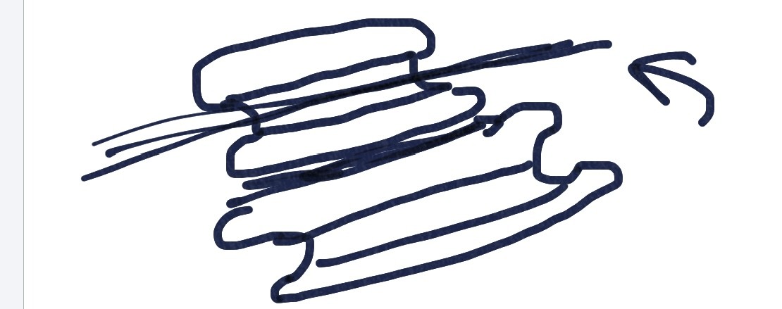

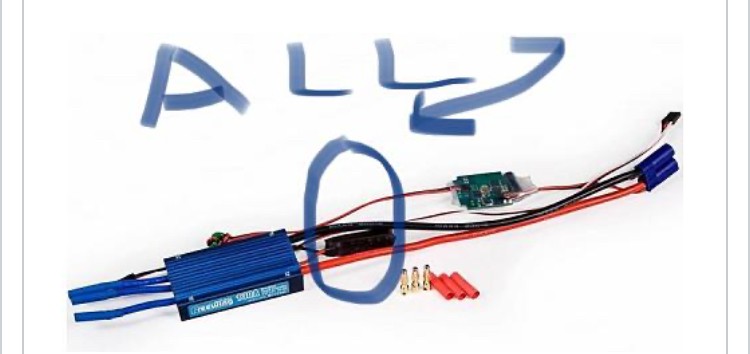

                  Interesting that there is a lot of “test this first”, “expensive plane”, “take precautions” talk in the last several posts. But nobody has mentioned the simple addition of RF chokes that have been discussed at length in other EDF jet forums. Additional failure proofing of high current ESCs by adding RF chokes is an item that has proved to reduce holds and frame drops caused by RF noise coming from the ESC.
                  I lost 3 EDFs before using RF chokes, and I have not lost a single one since I started using RF chokes. And I am talking several thousand flights on various EDF jets.
                  They clip on, they are cheap, they are light weight, they reduce the chance that RF noise generated by the ESC will upset the TX/RX binding look-up table hand shake…why not use them?
                  Clip them around all the wires between the ESC and battery/BEC like this…and as close to the ESC as possible. Not needed on motor side of the ESC. You can use one larger one to clip around several wires, or smaller ones on individual wires.
                  Basically, choose not to use them at your own risk!
                  Such a simple way to help assure you won’t have radio control issues. See below…(the arrow points to the wire you are clipping the choke on)…

                        All the wires, but nooooo not all in one choke.
                        You can use several different size chokes to fit what is needed. Now you “could” put all the wires in one choke, BUT THAT WOULD BE A HUGE CHOKE.
                        Best to use several smaller size chokes that best fit the wire size.
                        Yes…including the battery wires. Just not the wires going from the ESC to the motors. That side of the ESC doesn’t emit much RF noise.

                            Thank you FlyNace! I appreciate your comments and confirmation. My tip about chokes came from a friend who is a HAM radio operator.
                            Some have said, “Never have used them and ain’t gonna start using them.”
                            Brings to mind the image of an Ostrich with its head buried in the sand.
                            It appears the server crash caused a loss of my prior images….reposting here. The arrow shows how the wire(wires) fit in the choke’s central channel. Then the choke folds in half and snaps closed. I always add a zip tie to secure the closure.
                            The ESC photo shows the side where you put the chokes on.
