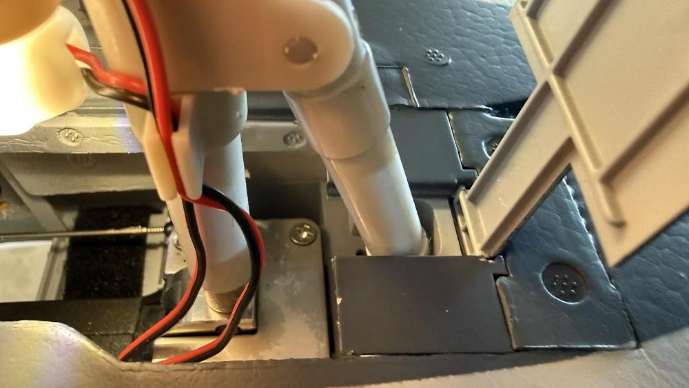

                                    This is my V1. It will be passed on to a flying buddy too.

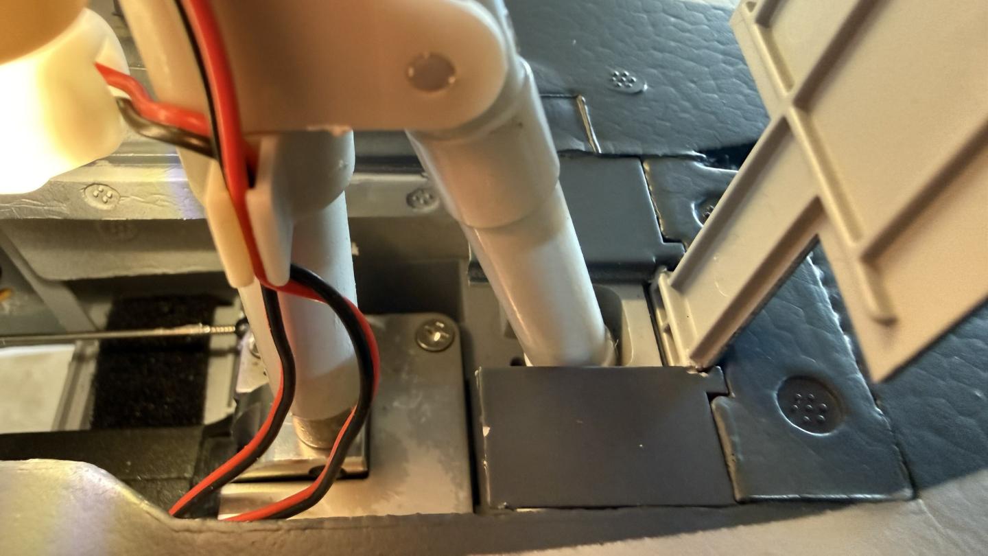

                                    My V2 hasn't arrived yet. On the V1s, those of us that fly from grass, used to install a 3D printed nose gear brace. The idea was to take some of the stress off of the retract and mount. Is that doable on the V2, or would the follow up strut be in the way?
                                    • ParaCanary
                                      • 18
                                      #278
                                      strut is in the way but it does give some lateral support
                                      Click image for larger version  Name:	IMG_0782.jpg Views:	0 Size:	103.5 KB ID:	440980
