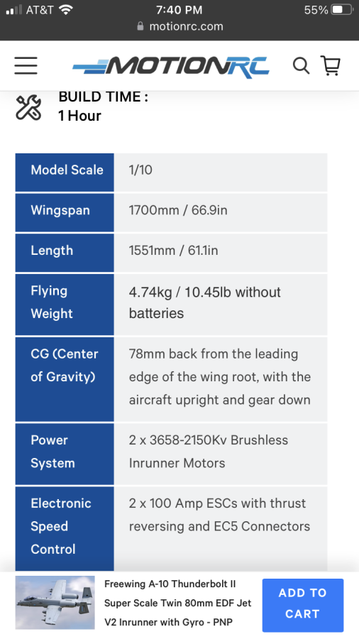

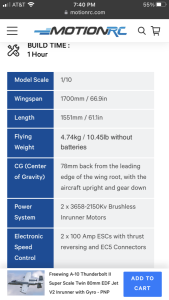

          I want to order graphics for my A-10 v2. What scale is it?
          • #65

              • #67
                Remember the stars and bars and the little details are already applied.

                                  • #77
                                    Originally posted by Evan D View Post
                                    Thanks........I failed to notice.
