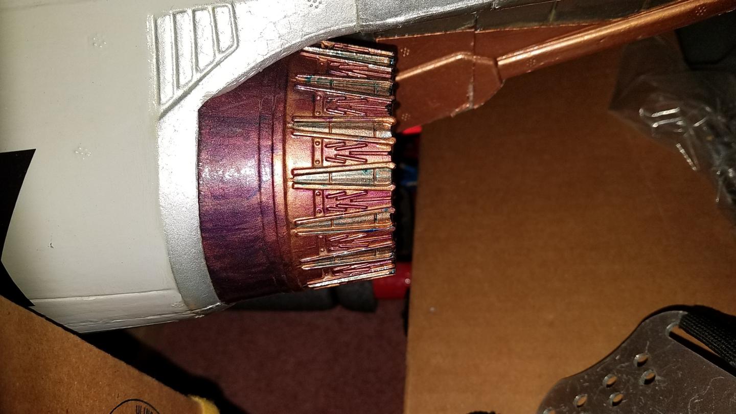

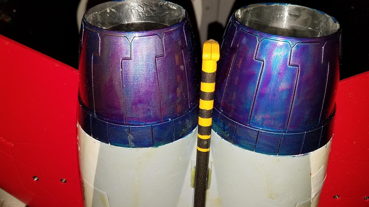

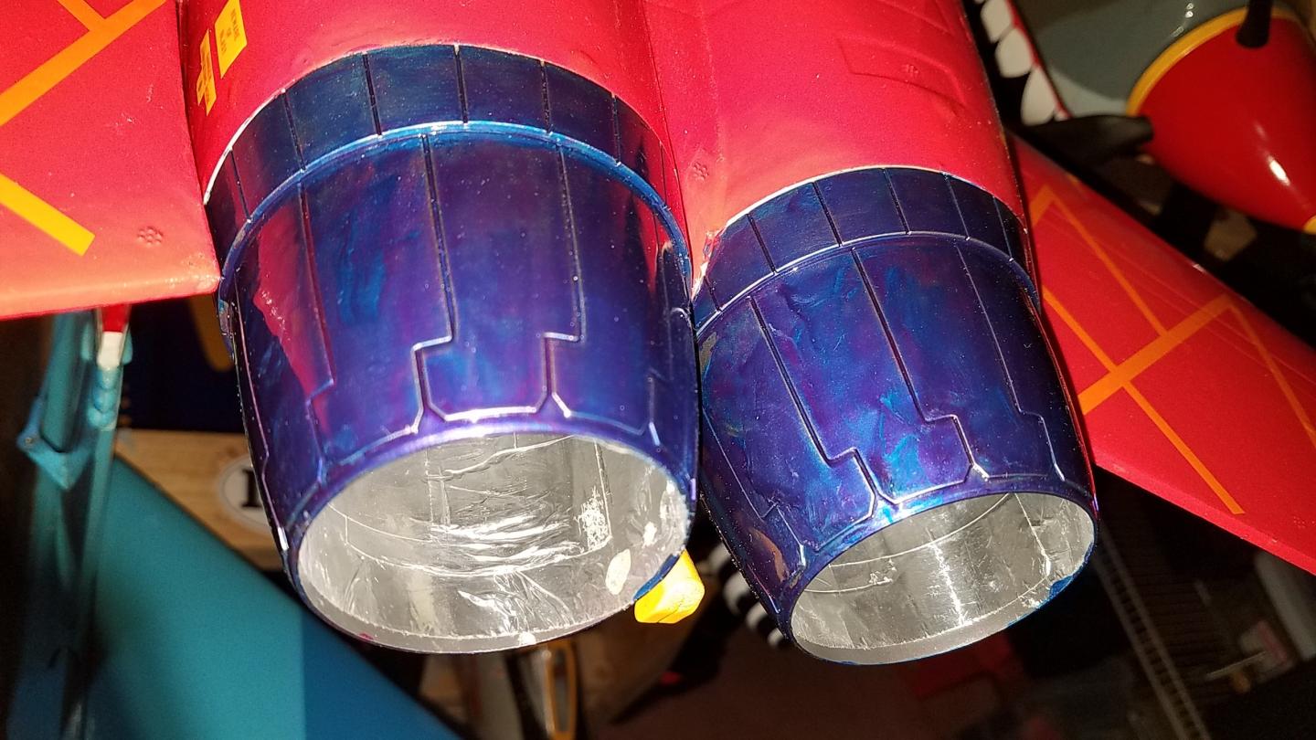

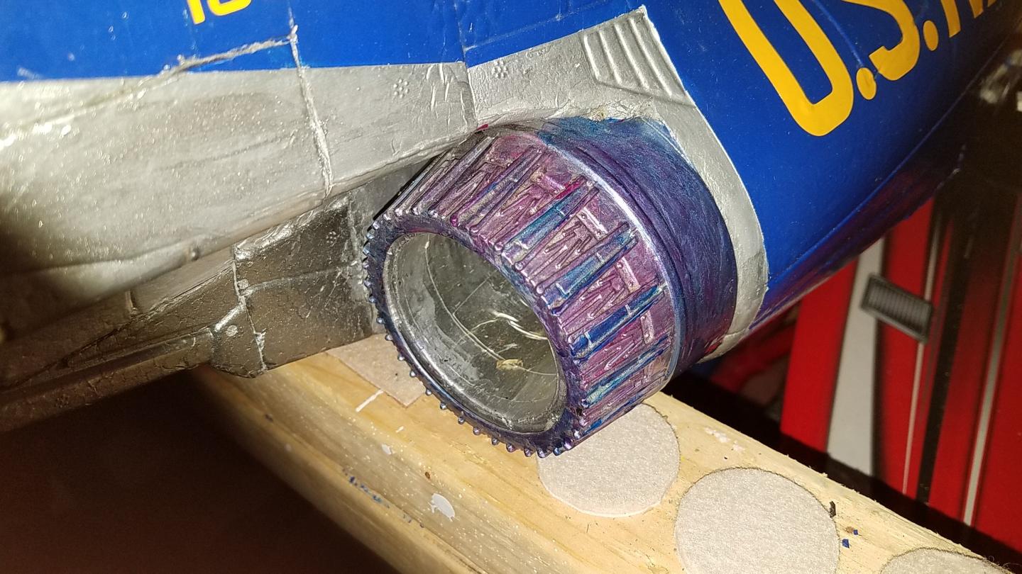

    Sorry, I didn't mean to be misleading...I needed to test the forum's ability to embed images so I selected a random image I had on my HD.
    Nevertheless, Nice Work! I've had a bit of "heat" scarring on my F-18 and F-4 Nozzles as well. Maybe I should say "Extreme Heat", cause as you know, I go a bit overboard on everything!
    I didn't realize how "hot" those RC Geek Afterburners really were.:lying_face:

        Yes, LB, these are my nightmarish version of "Scale Exhaust Nozzles". I was actually trying to match Tamm's Fusia Kitchen Aide dough mixer she saw that reminded her of me! :lying_face: They do radiate in the air!
