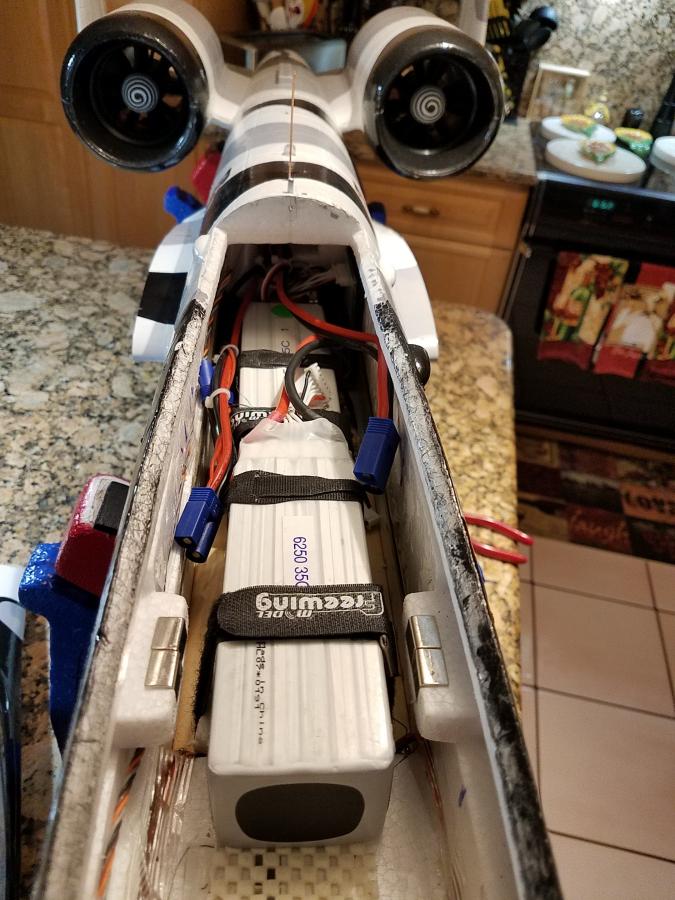

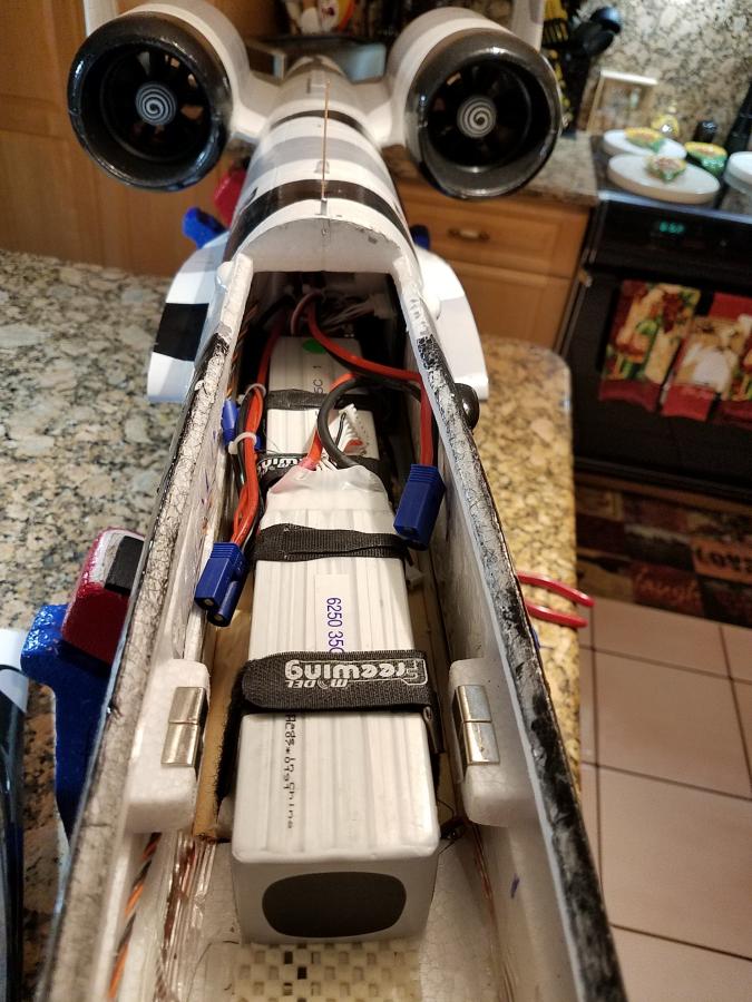

                                        For those running the SMC 5100/5900 LiHv packs can you show a picture of your battery placement? Thanks!

                                          I'm using 2 SMC 6S HiV 5900's V2 packs placed as shown below, although this is a V1 with upgraded 3658-1920Kv inrunners instead of the stock outrunners that came in the V1. Shouldn't be that much different than the V2. Please note the photo has 2 Roaring Top 6250's in it from a year ago, but my SMC's are placed approximately the same. You should also note that I'm balanced at least 15-20mm behind the manual recommended CG, which is more neutrally balanced. No extra lead anywhere. Did extend the front foam base under the front battery so it sat level. Also, I do have the 3D cockpit and 1/10 scale JHH pilot which adds a bit of weight to the front. 6-8 minutes Flight time on the SMC's! :hugging: Perfect battery for the A-10!:call_me: Stuck that pesky blue box way back on the port wall of the fuselage to make room for the back battery.
