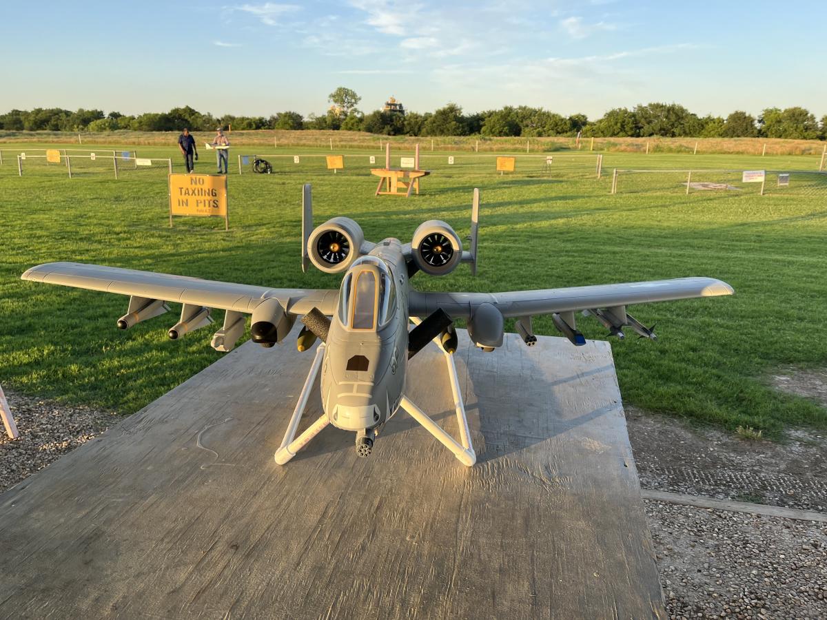

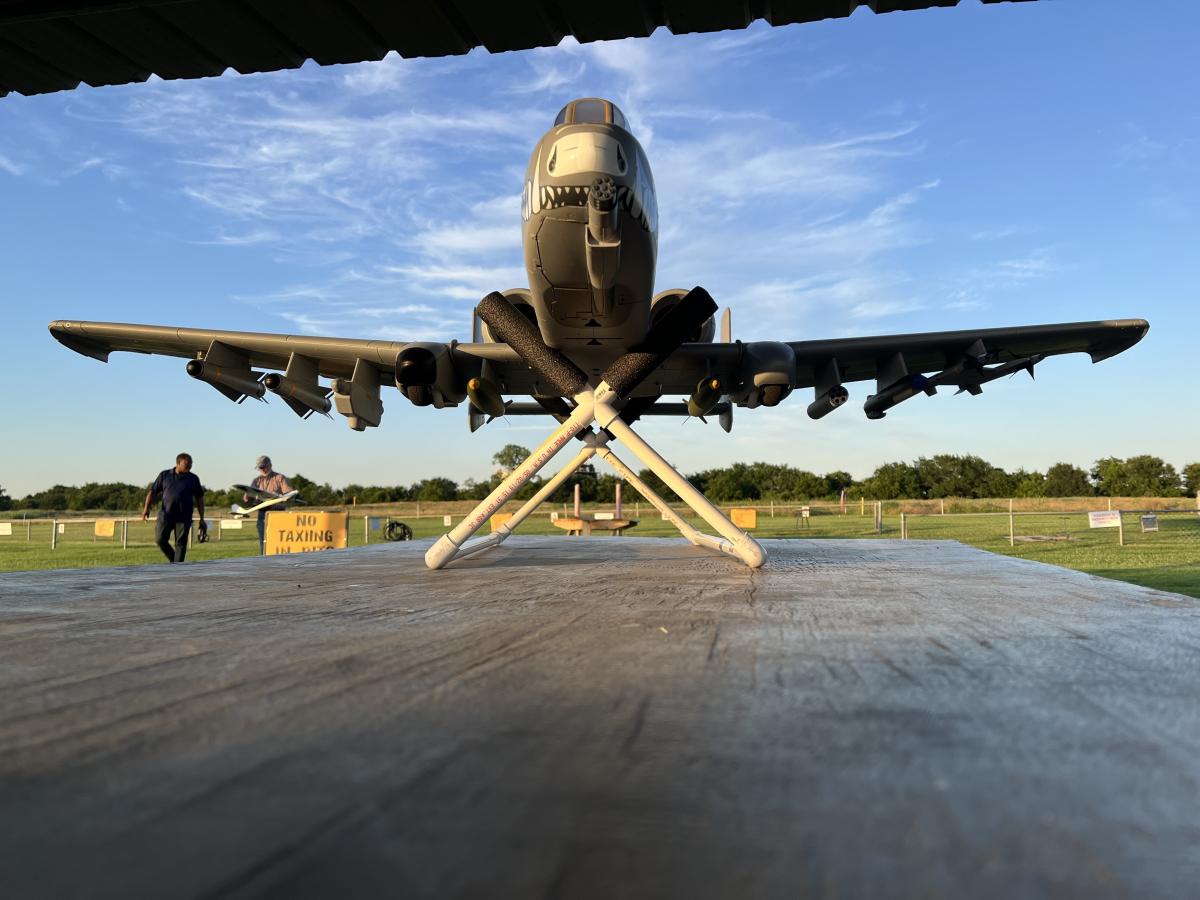

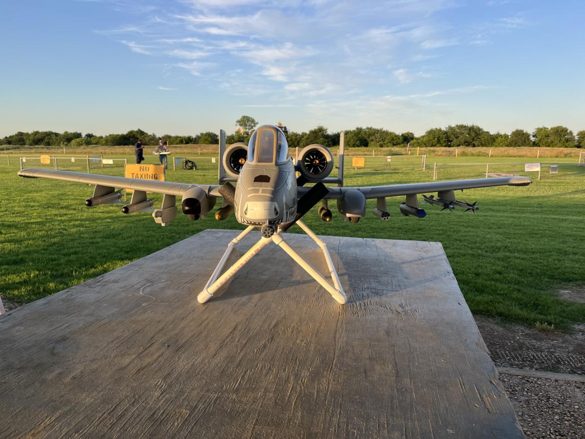

                      Continuing my test flights of this new FW A-10 at AMA#1140 Greater Southwest Aero Modelers of Fort Worth Tx grass field:
                      Confirming full armament 6min flight duration with mixed throttle and acrobatic flight routine (Aileron rolls, Cuban eight, figure eight, loop, Immelmann, split S, dirty pass, lazy eight, fast pass, slow pass, vertical climb spin into descending 360 power glide etc etc) landing with taxi via SMC 5900mAh LiHv at 3.85per cell. 7min flight times cruise landing at 3.80v per cell.
                      Be careful of touch-n-go to ensure enough runway is available for "Slow throttle increase" rotation for rollout take off....otherwise aggressive throttle input will hold the nose down causing long runout for take off.
                      The flight envelope of this twin EDF is impressive ....very responsive aggressive flight performance with Aft CG. Flight duration of 7min display cruise is astounding
                      I did see gyro undulations at 100% throttle nose into 13mph winds......so be mindful of possible gyro flutter at WOT.
                      Take off flap setting works well for landing, full landing flaps may work better by refraining from elevator flare to prevent secondary lift (bounce)
