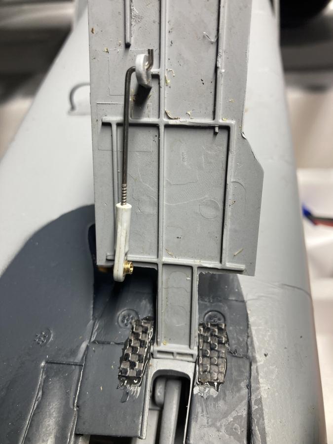

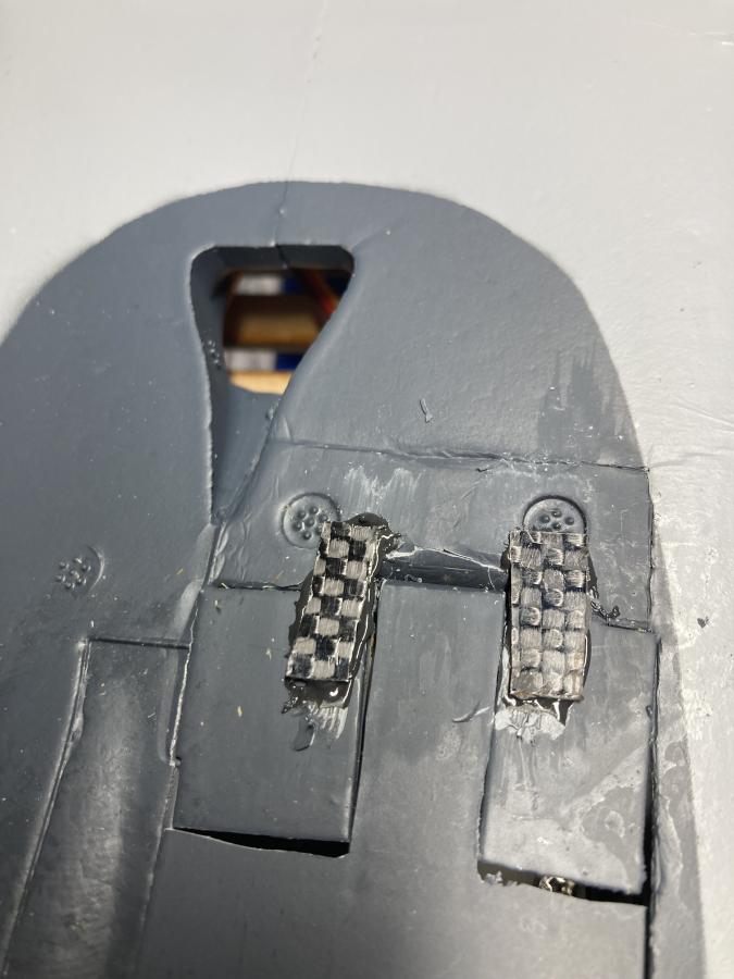

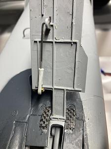

              Click image for larger version  Name:	IMG_3253.jpg Views:	0 Size:	64.9 KB ID:	424360 Click image for larger version  Name:	IMG_3254.jpg Views:	0 Size:	58.9 KB ID:	424359
              Did my first grass ops today and discovered the hinge pins on the nose gear rear door are not long enough to stay in the hinge holes. The rougher grass field stressed the rear gear door enough to make the rear gear door pop off the hinge. Did a little head scratching and came up with a solution. Glue a piece of carbon sheet over each side of the hinge.
              Honestly, even ops on pavement will probably pop the pins out of their holes at some point. Pins are too short.
              Place the carbon sheeting as close to the door as possible. Then paint the carbon to match.
              See photos….
              Studying the “pins”, it will also be easy to Dremel a trench and put a metal wire hinge in. I’ll do that when the pins break.
              -GG

                Update to post 106…
                The thin plastic rear nose gear door takes a beating when on grass. I’m happy to report that the door was held in place by the added carbon strips. Unhappily, the door cracked nearly in two with more grass ops!
                I’m going to study this rear door and come up with a beef-up solution. The problem may be partially solved by using a spring connection to the nose gear shaft, and part of the solution may be to reduce the fore-aft play amount of the nose gear shaft that can develop after less than perfect landings or from stress from bumps in the grass.
                Stand by for further updates.
                About 20 flights flown to date and loving this bird. Just gotta get the rear nose gear door issues fixed.
                The simple solution…remove the rear nose gear door, but I like to tinker too much to take the easy way out.
                -GG
                Update: After studying the rear nose gear door, gluing strips of carbon sheeting to the inside of the door will be what I try. Using Foam-Tac for a bit of flexibility. Basically, the door is a carbon sheet, now.
                Will find out if this can withstand grass ops stresses with some more flights.
                2nd Update: The bottom of the rear nose gear door is impacting the tire!!! I adjusted the linkage so it sits farther back. Fixed the problem! The door probably isn’t closing all the way, but not gonna care.

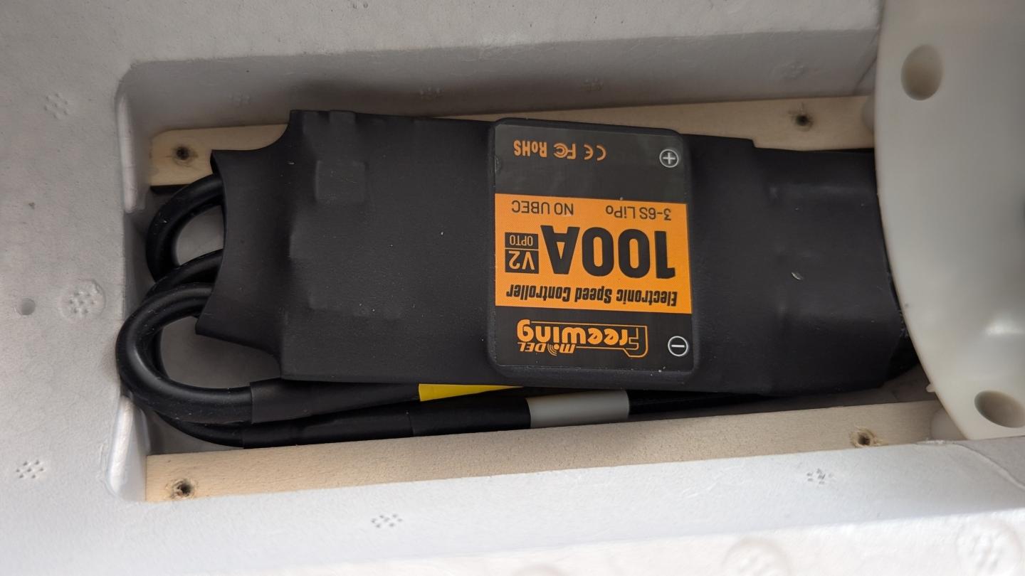

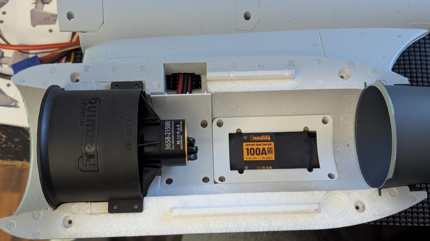

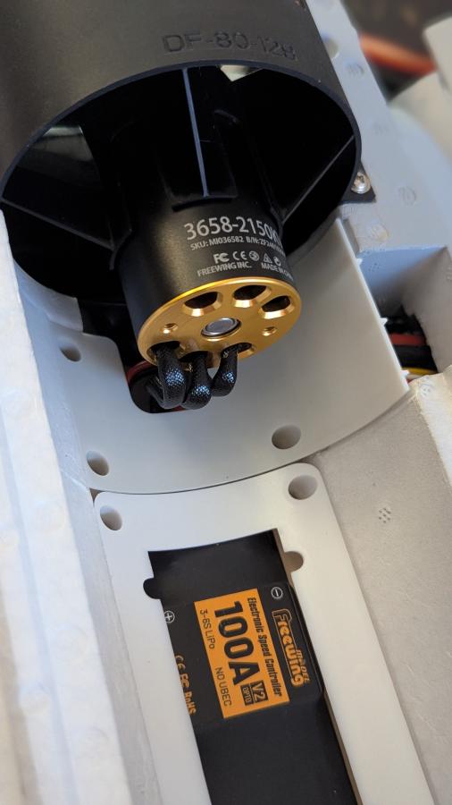

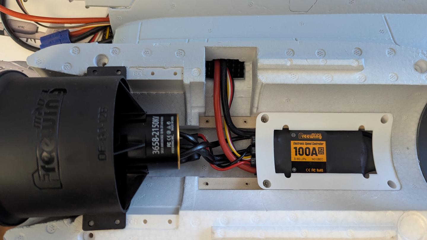

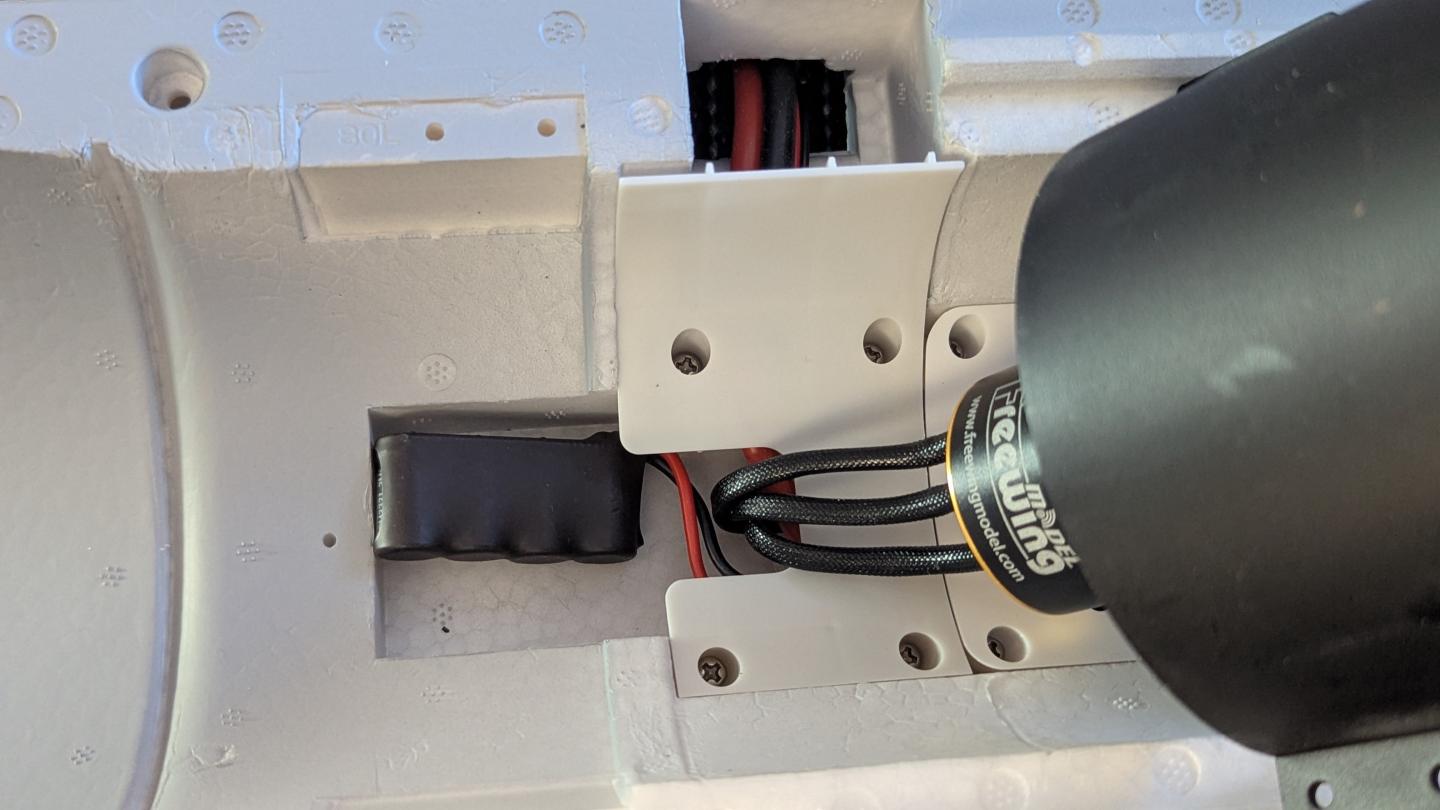

                          I went and did the 12 blade upgrade with the inrunners,i had to wrap the power leads back under the esc to make it sit proper with the cap pack sitting in the pocket under edf fan(is this proper for this A-10),hopefully ill maiden in the next few days,looking for a blue sky day with lite winds.so far im impressed with the super scale A-10, throwing callie graphics on today
