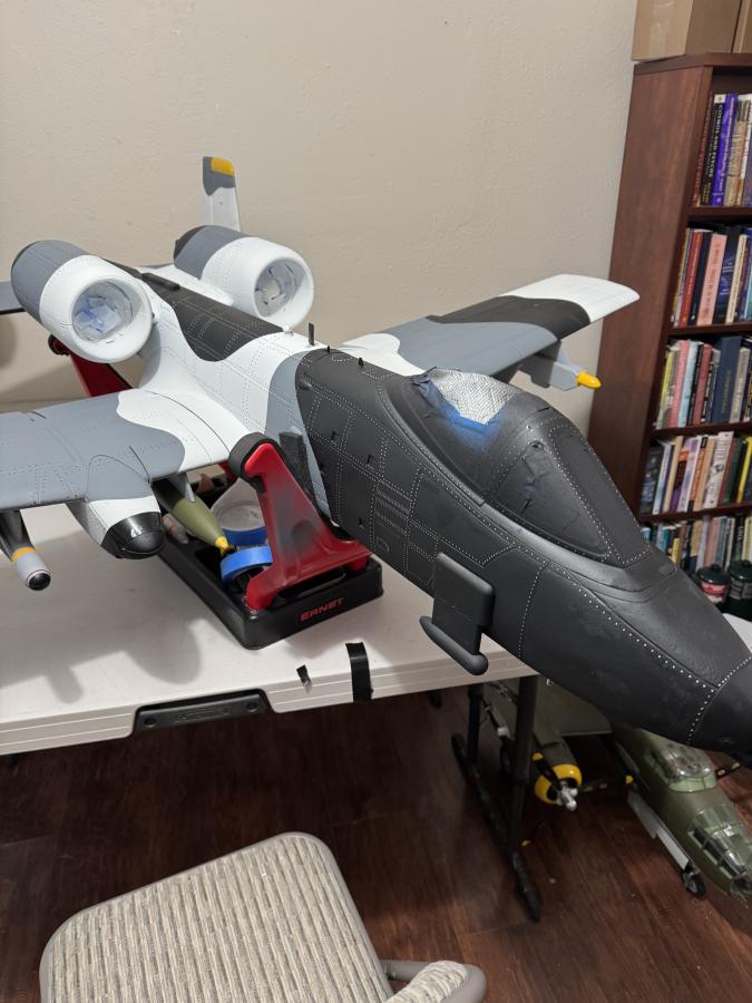

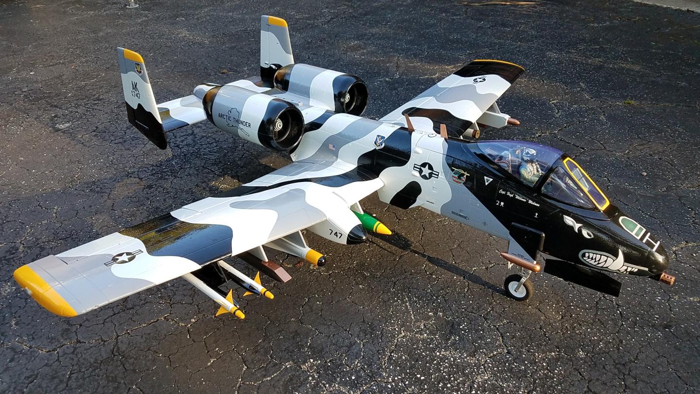

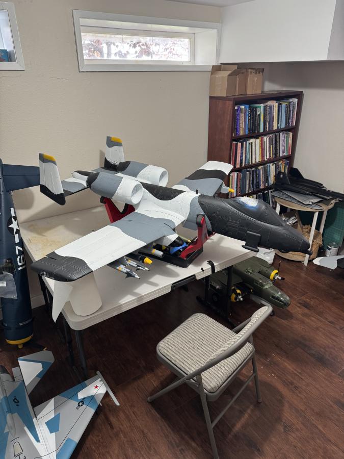

                  Been working on converting mine to the Arctic Camo livery like I did for my V1. I forgot what a royal pain in the rear it is to do! It's coming along...

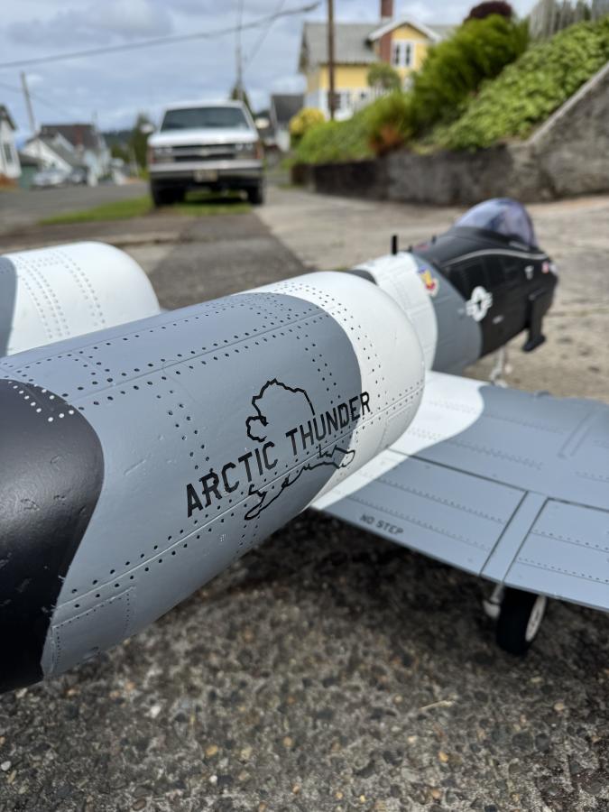

                        Aros you must do the A10 in the Arctic, yours was the inspiration for me to do mine in the Arctic. Tremendous visibility and a crowd favorite. Install the Dirty Dee cockpit if you can and a Jet Hangar Hobby Full Body Pilot fits nicely.

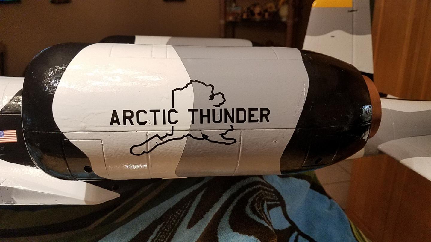

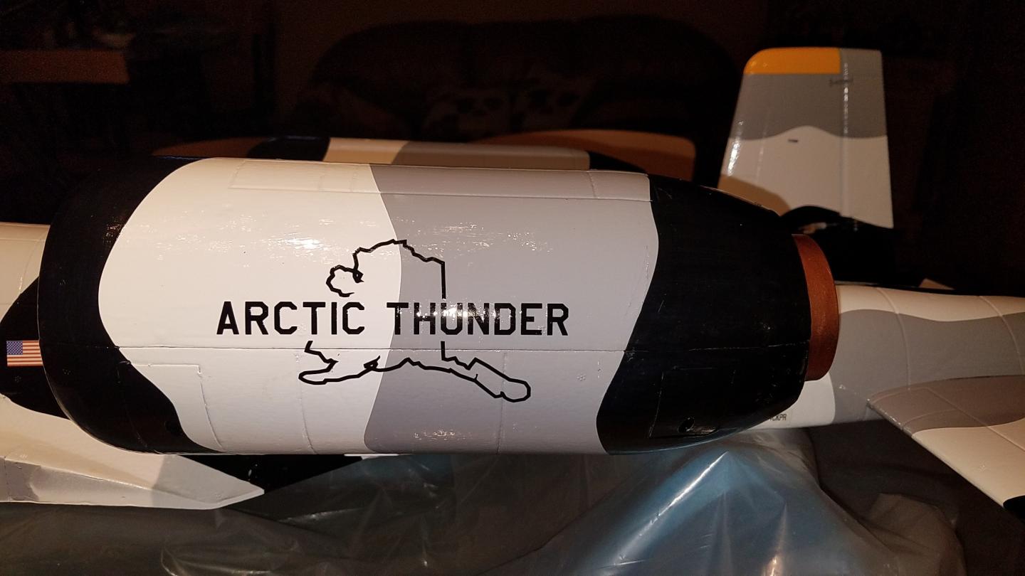

                        When Callie sent my graphics, one side of the Arctic Thunder on the Alaska state was backwards, a mirror image. Took me a while to figure it out and she missed it as well. It was my Cuban born Mother-in-law who caught it first. And she barely speaks english. Must've been on her citizenship exam 🤣 cause I probably wouldn't pass. Assume Callie's corrected it.
                        Can you tell which is correct? (worth 10 MRC points):
ID:	425900 Click image for larger version
                        Below is my A10, next to a 1/5 scale A10 Jolly Rodgers twin turbine. I easily kept up with him and of course mine is far superior. :lying_face:

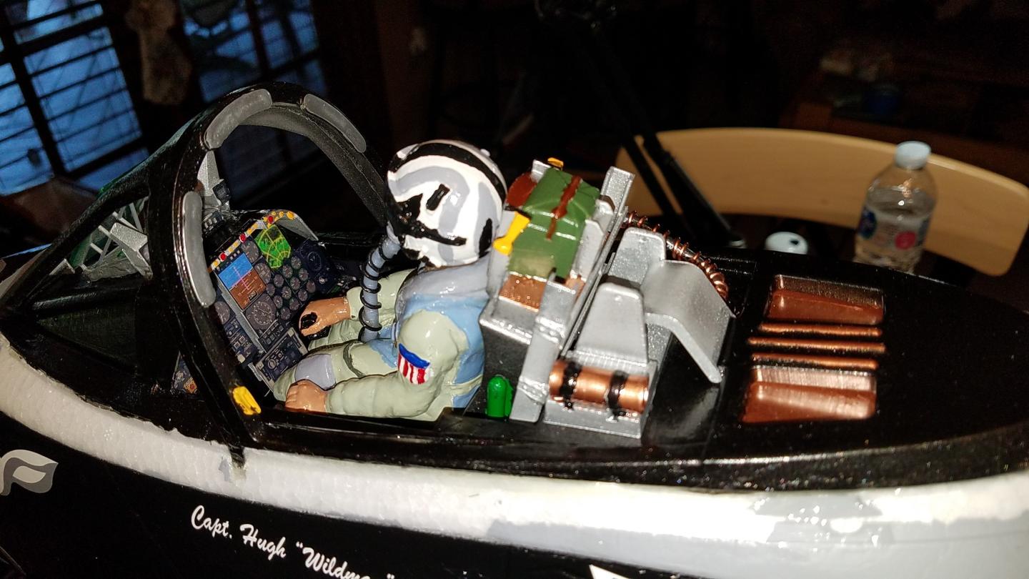

                          Ah yes, I am reminded of the beautiful job you did on yours! Would be a ball to fly ours together someday.
                          Your cockpit looks fantastic!
                          Well now I will be curious to see if her decal set still comes with the one backwards decal. Doh!!

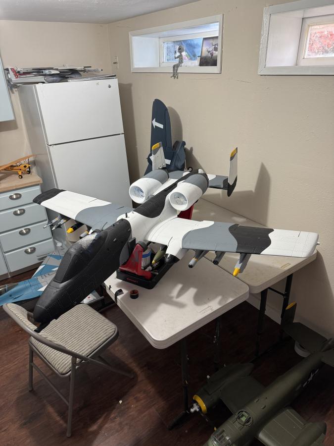

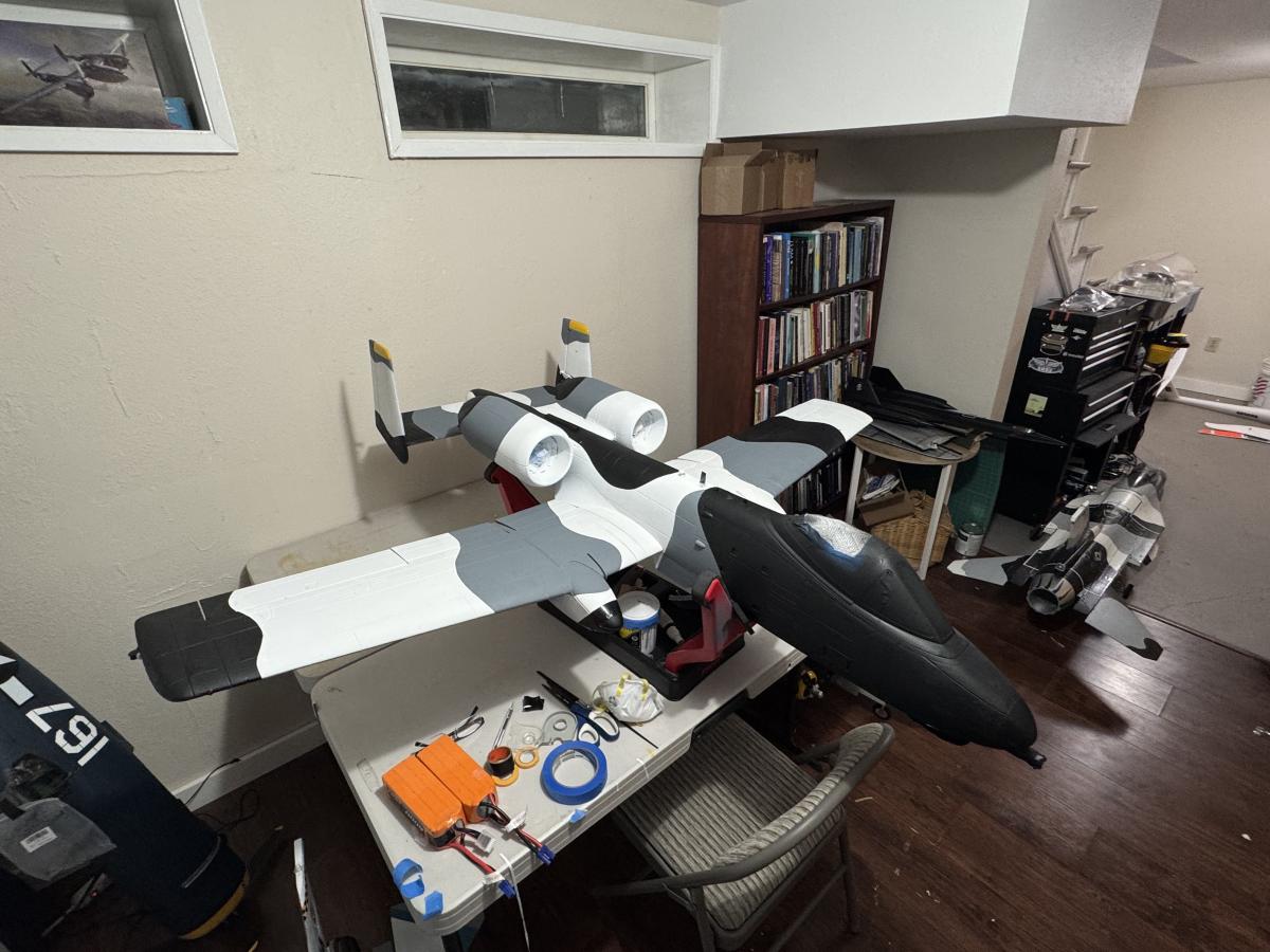

                          Rivets are finally done. Whew!! Just waiting on the decals and then slapping on a couple coats of polyurethane and she’s ready for the flight line.

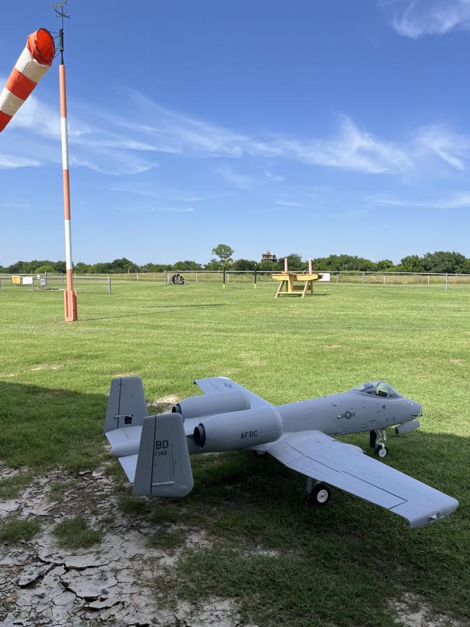

                            05-17-2025 Maiden plus (5) flights today. Flying via SMC 6s 90c 5900mAh LiHv 4.35v fully charged batteries, no armament packages mounted at 50-60% throttle tracking active throttle time only gave me 7:38min duration with full taxi and two touch-n-go's landing at or near 3.85v per cell.
                            Holy freakin smokes what a sweet EDF. It's the SMC LiHv 90c 5900mAh batteries....and the aircraft flies excellent....lands super easy on grass field.
                            Highly recommend this bird and the SMC LiHv batteries
                            I did notice the aircraft took awhile to rotate...perhaps because I was still in 90% power during roll out....later flights "I Think" backing off the throttle just a tick gave me a "better" rotation. GSWAM is a grass field.....no issues with taxi, take off, landing, steering. The power plant is very strong.
                            Photo from Tuesday 05-13-25
                            TwistedGrin

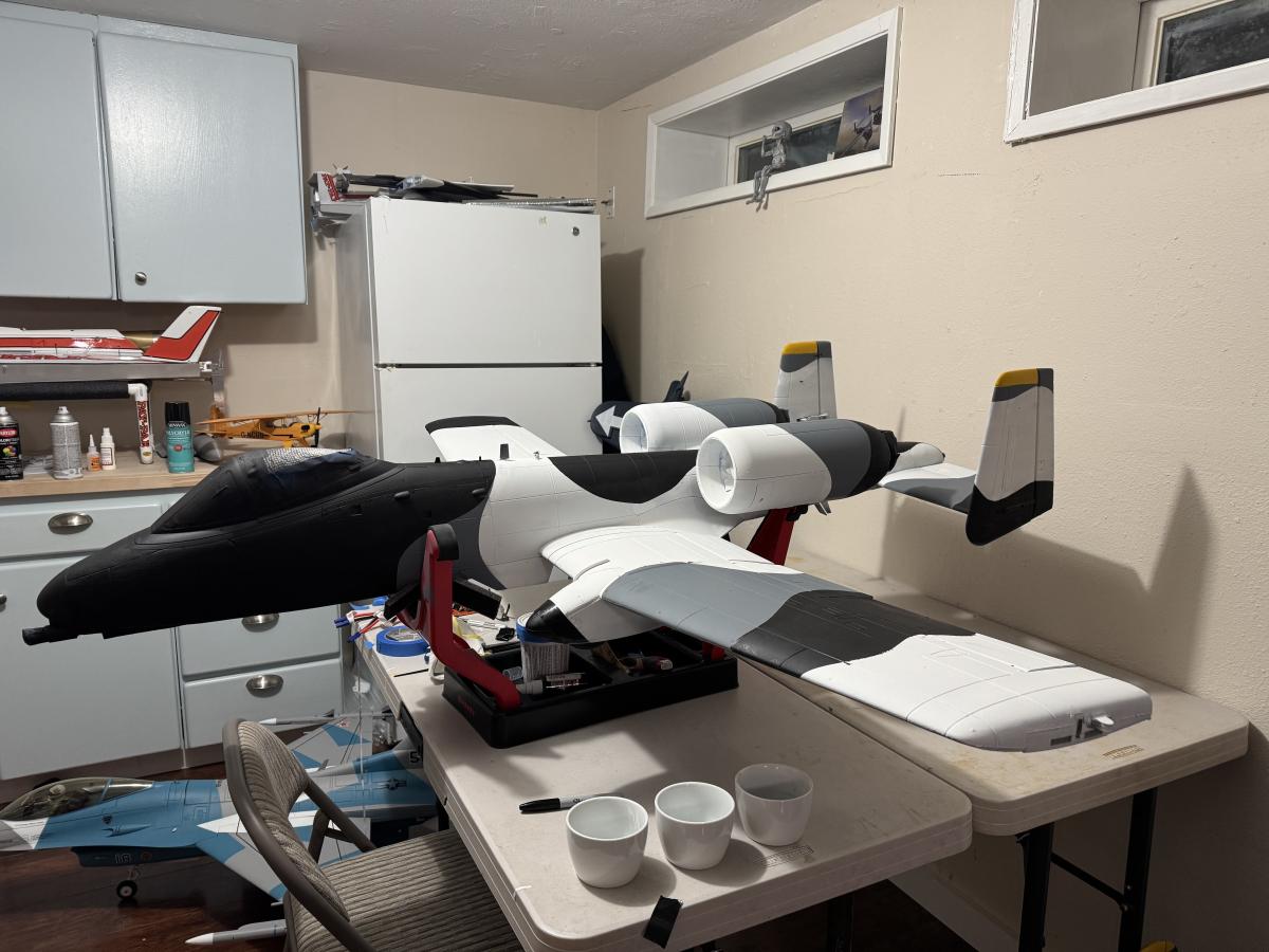

                                She’s finished. Man a lot of labor goes into these repaints that we do. I am pleased with the results overall. From a distance she looks amazing. Inches away, well….
                                As long as Hugh Wiedman thinks it looks
                                good then I know all the hours of labor was worth it.

                                    Aros! Looks awesome!! Really well done!
                                    How did you do the rivets?
                                      • 8217
                                      #158
                                      Thank you! I simply used permanent ink pens (fine point) in black and metallic silver. Just light dots along the panel lines and a lot of patience.
