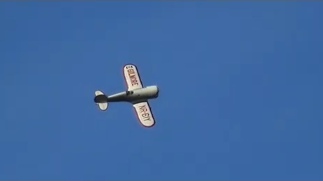

    Flys pretty well. This is the maiden flight of mine near Stonehenge in the UK. Power is a Saito FG-61TS petrol/gas.
    VERY nice video. Delighted to see a gas powered Blackhorse Gilmore.
    She does indeed look well mannered and that FG-61TS look the part.
    DaleD
    CitabriaDriver Well Done! Your Gilmore looks and sounds great.

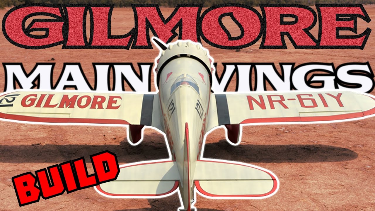

    Let's get the wings done!
    Click image for larger version  Name:	snap3.png Views:	0 Size:	1.36 MB ID:	307964Click image for larger version  Name:	snap4.png Views:	0 Size:	1.13 MB ID:	307958Click image for larger version  Name:	snap5.png Views:	0 Size:	1.29 MB ID:	307959Click image for larger version  Name:	snap6.png Views:	0 Size:	1.38 MB ID:	307963Click image for larger version  Name:	snap7.png Views:	0 Size:	1.36 MB ID:	307961Click image for larger version  Name:	snap8.png Views:	0 Size:	1.60 MB ID:	307962Click image for larger version  Name:	snap1.png Views:	0 Size:	1.26 MB ID:	307960

    Originally posted by RC ML
    Second day of flying the Gilmore , now with the wheel covers .
    https://youtu.be/CdpsNrJ_agU
    VERY nice flight. I could see evidence of you being more comfortable with the Gilmore. The Touch-&-Gos and landing demonstrate what appears to be good slow flight characteristics. The sound is really sweet,
    I am sold on this model. Can't believe I didn't pull the trigger when Motion had them in stock.
