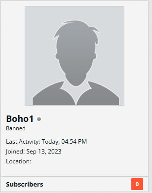

    SORRY MR BEAN ..I couldn't accept your friends request. But I see when they banned your boho1 profile created the MR Bean profile the same day. Anyone that paid attention to the Mr Bean profile join and activity dates of you original BANNED boho1 profile could see the site security circumvention.
    But anyhow Enjoy the blog... where I have full control.
