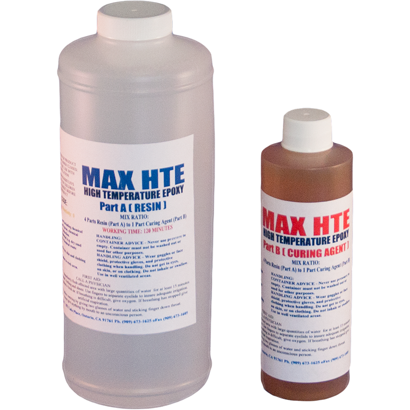

    BTW here is a PLA mold for the same core in a pure iron filing high temperature epoxy composite. I'm going to vacuum pack it. The Lehner design consultant and I talked about annealing the iron filing in hydrogen. That really shoots the permeability through the roof.​

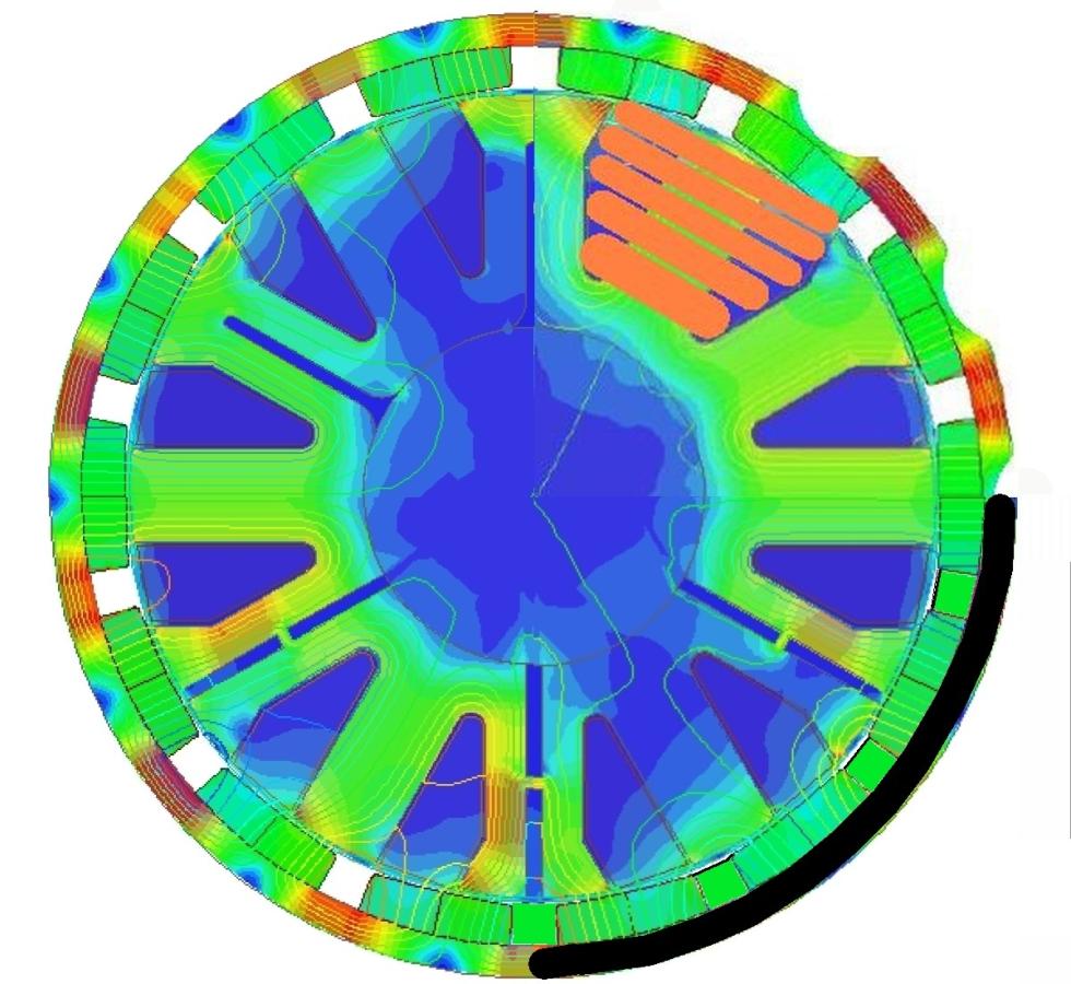

    I know a 20 turn parallel single layer inner Delta is going to give me 320 Kv so that is the start of the test parallel hybrid wind I'll wind on the factory core I have here. I think i'll try winding that in 15 AWG. Overall that would be 4x's 1.51mm diameter for each motor terminal U,V,& W, for the inner delta. I'm going to order the core this week. I'm going to have the stack bonded at the laser house in C5.
    Each stator half wiring goes like this. I can also run the 6 phase configuration with two Inverters UU,VV,WW
    Across two castle Ice HV 200 V2's alone there's a peak of 760 amps there and they will survive.​ I know it empirically.

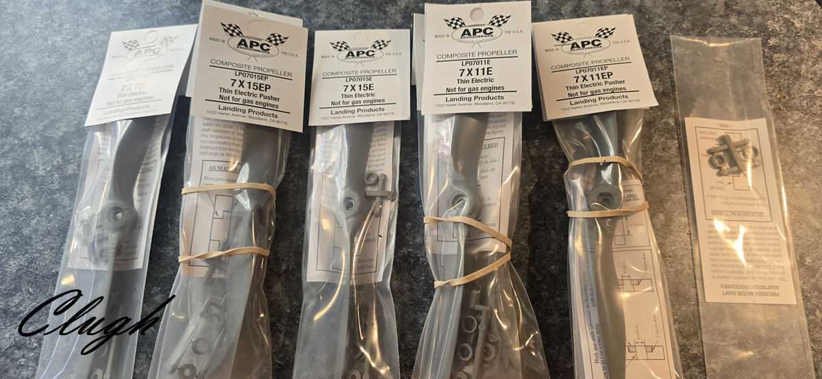

    7X15E

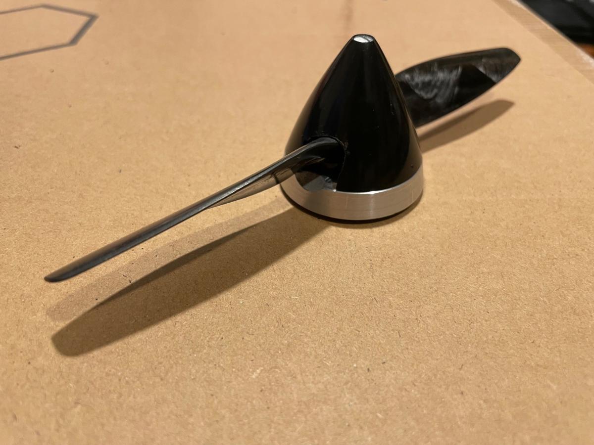

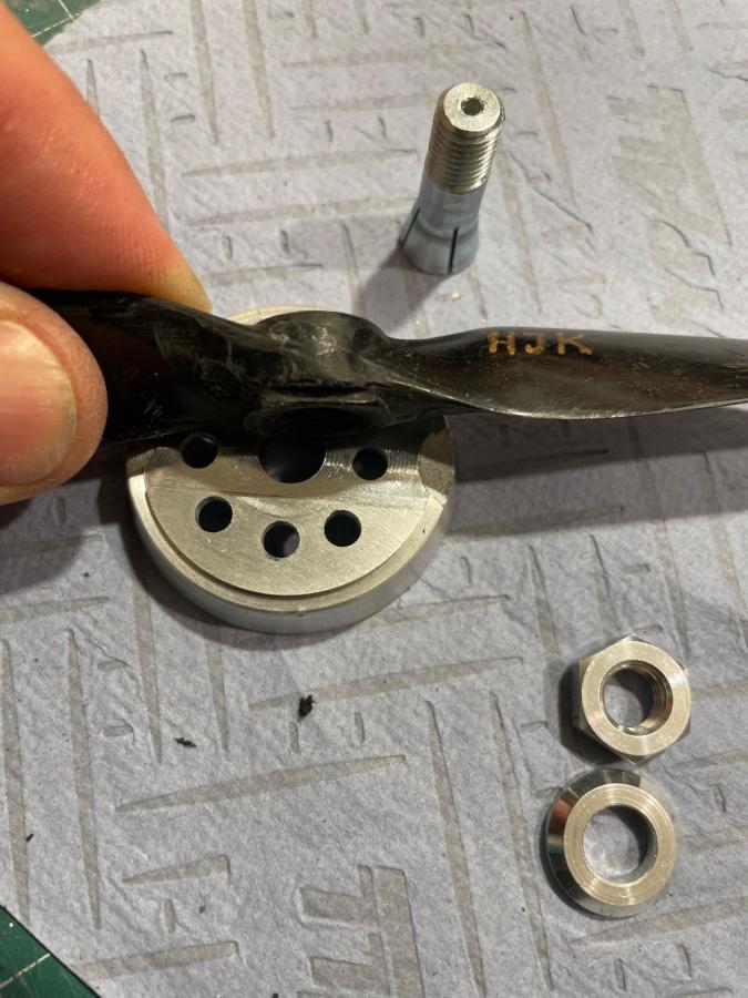

    The bottom 11 X 25 SAW bade has a full carbon fiber construction. The offset yolk , spinner and all is full carbon.....So I have a few high pitched choppers from my American friends I can duplicate myself here in RTP.
