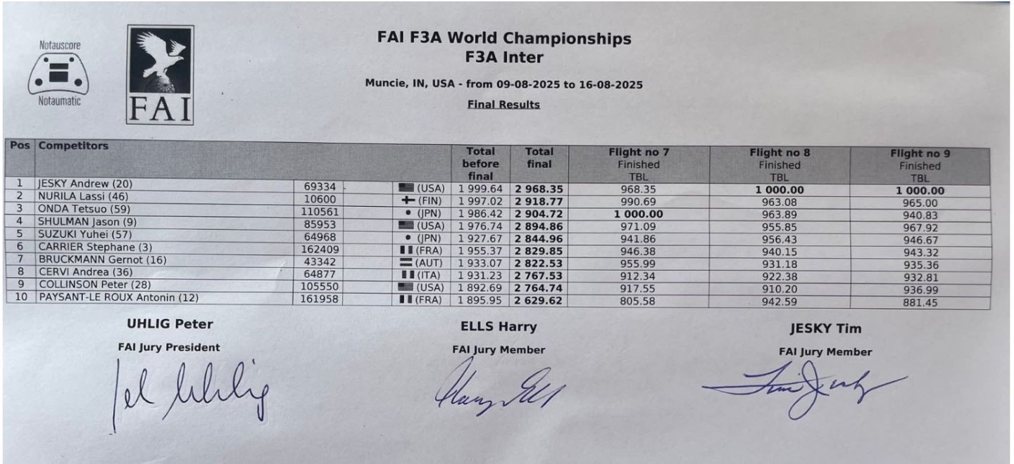

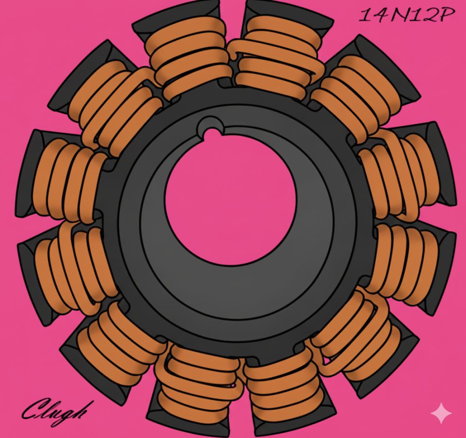

    That's what Bert in Holland wrapped for her , not a 5+5! The winding selected for the Andrew Jesky P650 was originated and calculated by Hubert aka "pocboy". Bert never wound a thing for Andrew 😏 Who also flies Egodrift in his 3D planes.😶 So you can listen to Ralph Okon talking about what the U.S. supposedly copied, but he has no idea what he's talking about. Bert has left his special preparations for his 6 + 4 P600 engine. One of them was filing off the varnish. I never filed anything or wound on anything other than the factory paint unless it was damaged. I now only use slot liners when they are absolutely necessary for a rough stator. The Dr. can't talk exactly about the wrapping program here because he doesn't understand anything about it. He has no experience with the materials or the techniques we use to build a more robust machine. He does it his way, We do it our way. He and Christian filled the pages with jealous fallacy that none of it works when they got angry, and then it was all used in the plane that won the world championship in F3A.
    Let the Germans-only what's app social media they participate on and whatever else explain to you why a seven-time World Finalist chose the motor and wind I gave him as the best he has ever flown in p25 the first place. And then built him into his No. 1 and won the 8th appearance with it since none of it works.
    " you can see the smearing of boron nitride infused epoxy THE way the American does it blocks the air to the windings" ~CL~ and the 20 extra dollars for the bearings that " are not practical compared to plain 5 dollar NMB's" ~Ralph Okon~
    What happened here? It all managed to work.
    And I would never copy them. You see I am not the one hiding in a closet viewing all the work!
    BTW It actually takes more time and route planning to do an even 5 + 5

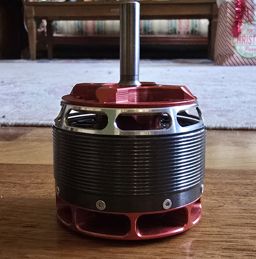

    Vicente's Gaishen 10 pole is stripped of the old copper and ready to rebuild.
    It's none of GSM's business how I wind Vicente's 14 pole F3A motors, but here are the constants:
    Kv 948
    Rm 13 Milliohm
    Io 2.1 Amps at 16 Volts
    They're done and shipped to Olathe, Kansas.

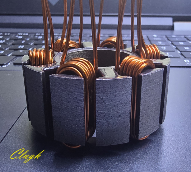

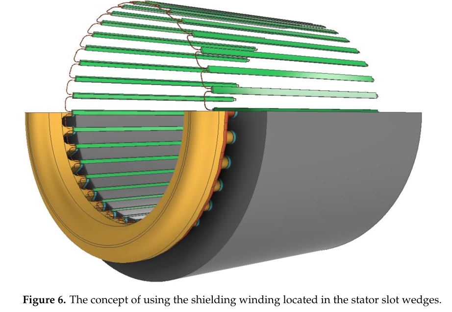

    These soon to be closed circuit coils are 22 AWG. ​
    Das ist Wickeltechnik aus dem Jahr 2025. Hat Ihnen der Motorfuhrer so etwas schon einmal gezeigt ?
    You cannot deny this. I dont care what the hobbyist in Germany tells you. This is how you can protect the rotor and shaft from electrical noise. And its alot more interesting and innovative than pink winding wire. This is nothing but a serial connection of the copper coils finally closed at the frame of the motor. They even wrapped the wire around the end turns helically before going through another slot wedge for added attenuation of electrical noise.
    Now i really have to go.
    Do you have any idea where I'm going with the idea of a slot wedge. This is 2025 winding tech trust me. The work is just being done on permeable shields on the in runners. What they will find when they are done experimenting is that the wavelength have to be short enough to start below a non porous shield. This is similar to the perforations behind your microwaves glass. They are spaced appropriately to block the radioactive rays but not the ones responsible for vision. if you take a Hershey bar and put it in the microwave for just a few second you can measure the melting points. That is the wavelength for the 2.4 ghz.
    You may need more of a background in sound reinforcement and wavelength theory to track with me.
    The closed loop coil at the slot opening is a great idea in response to this issue. In 2025 Dr Gerling is placing them in the Flussperren!
    I have work to do.....and could probably have several patents myself if it tried hard enough to push some idea of mine or the first to apply it. Who cares....
    Good luck with your limited imagination and creativity. Mine is alive and well.
