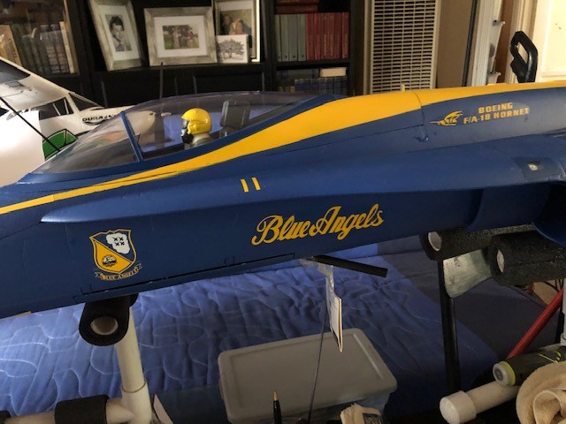

    Gorgeous morning for a Blue Angel fly

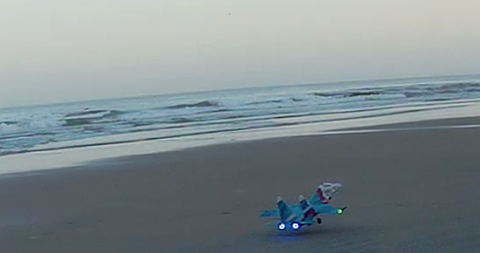

    Looks like you're getting it dialed in and quickly after only 2 flights. Nice looking landing with the perfect nose high AOA. I think you're liking the 100mm balance point!
    Right on -Thanks for all the info guys! 100mm seems ideal- I dead sticked her in again, she just refuses to come down otherwise! Landing was sweet!! perhaps just tiny THR like 10% would produce a wheelie landing, maybe next time :D

    Flight 2 was fun this morning Ute was at the beach when I arrived, filmed a fun flight! video editing now here are a few grabs Batt: SMC 6s 6200 CG: 100mm

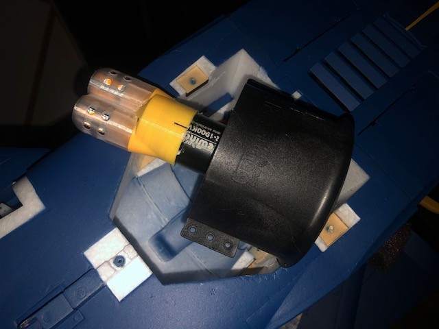

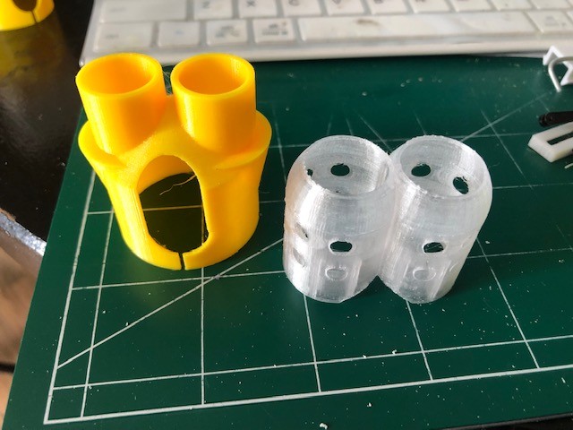

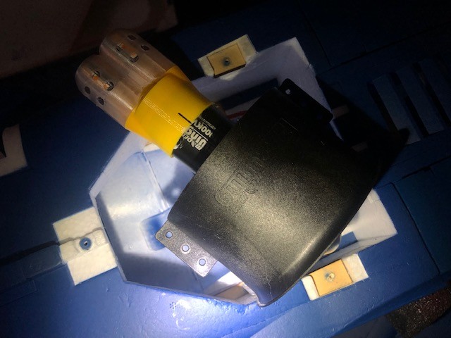

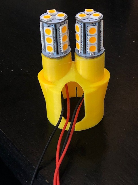

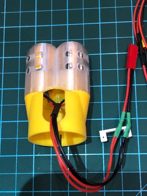

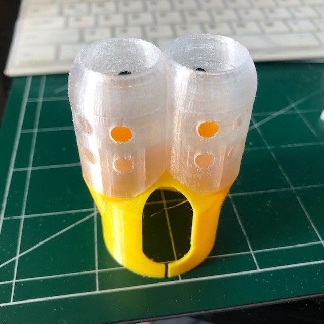

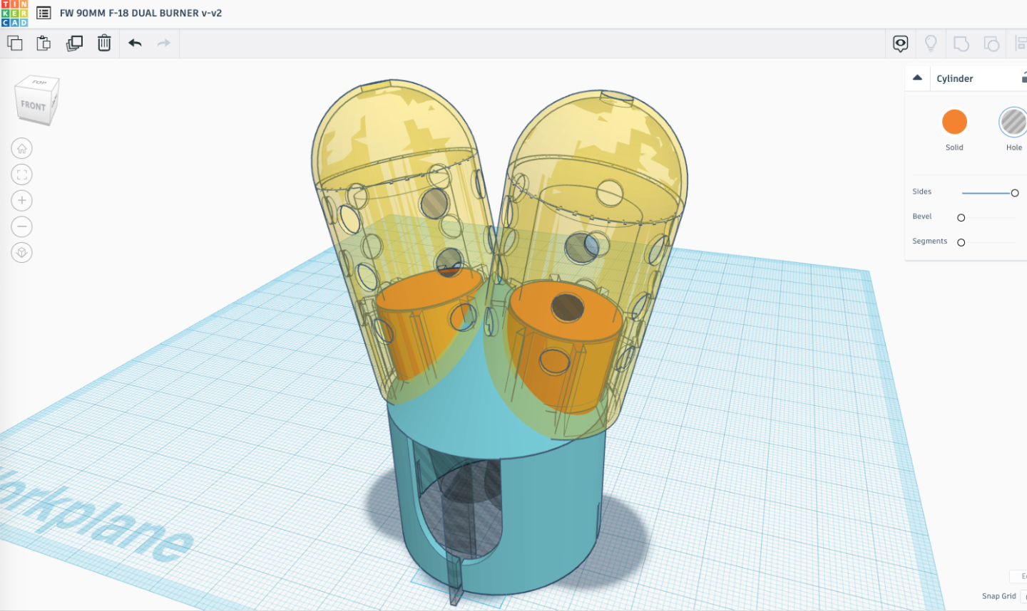

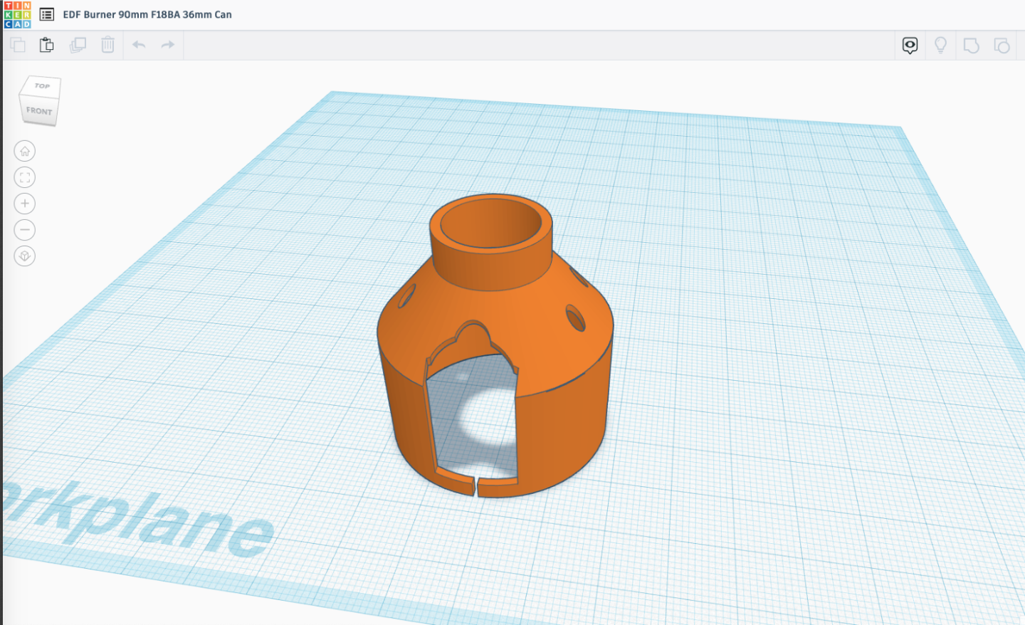

  • InTheTubeDeep

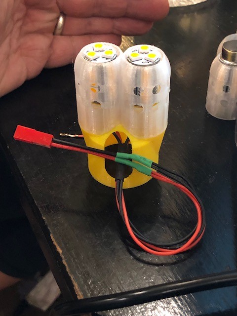

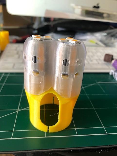

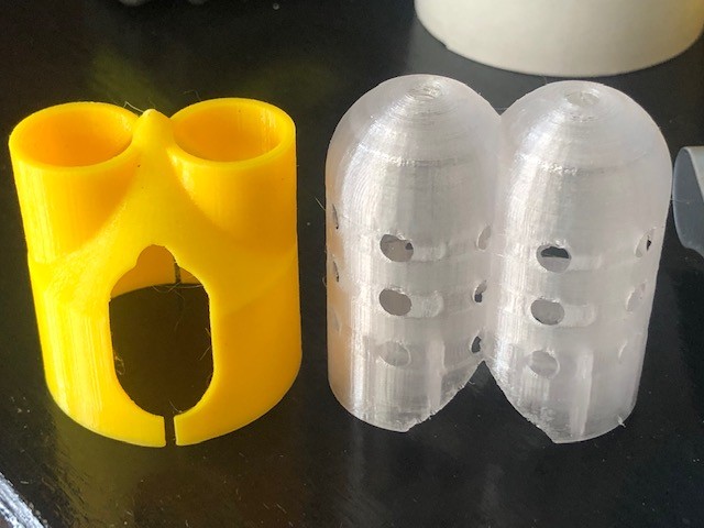

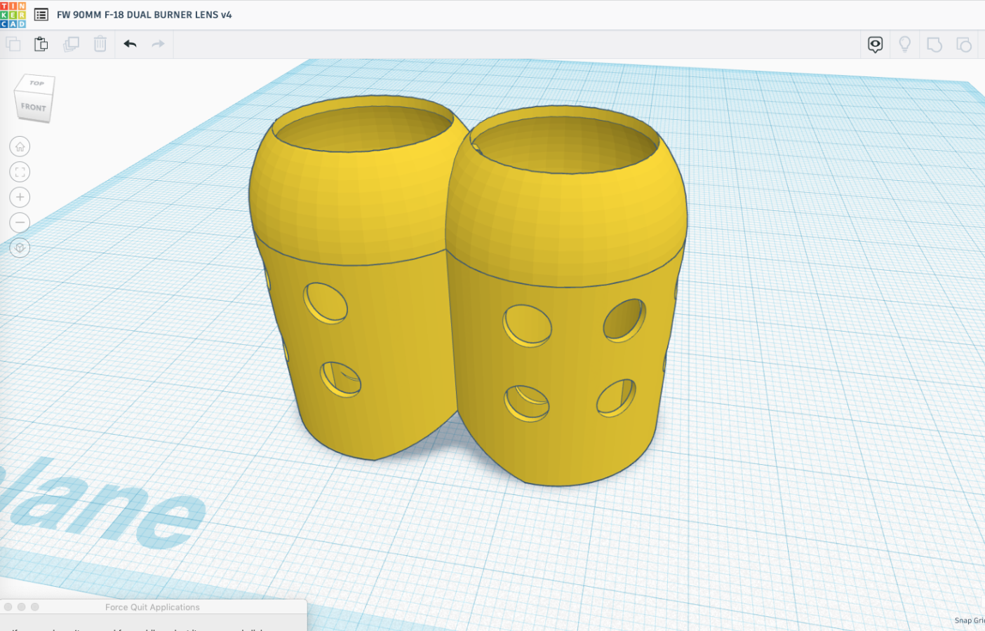

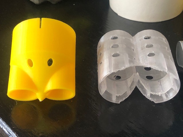

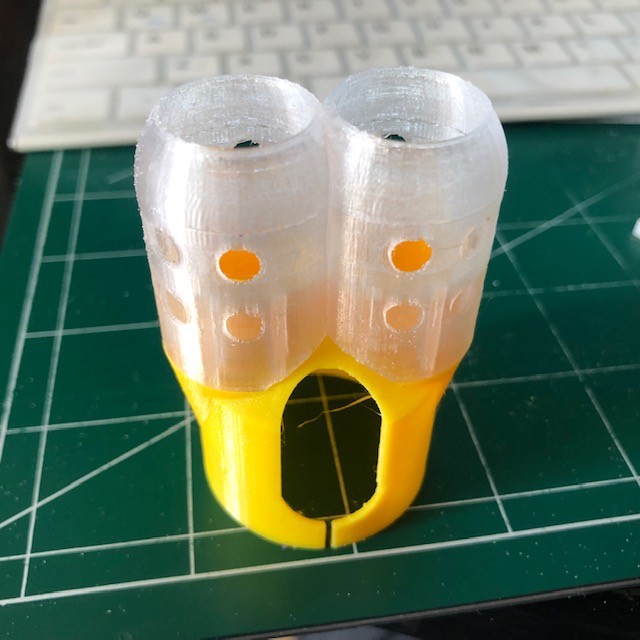

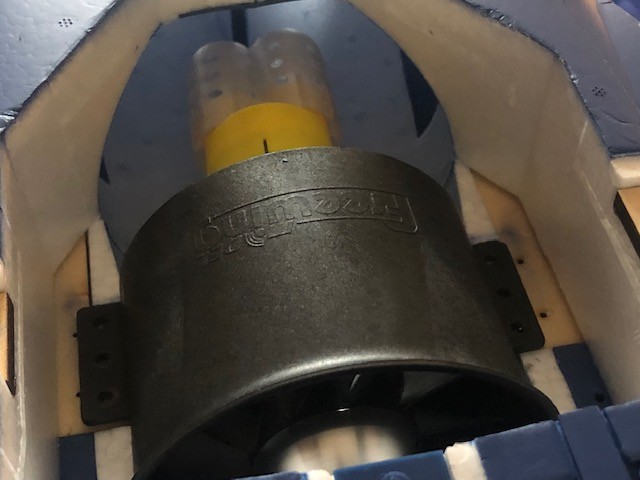

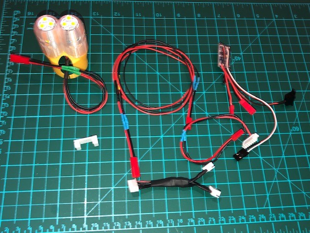

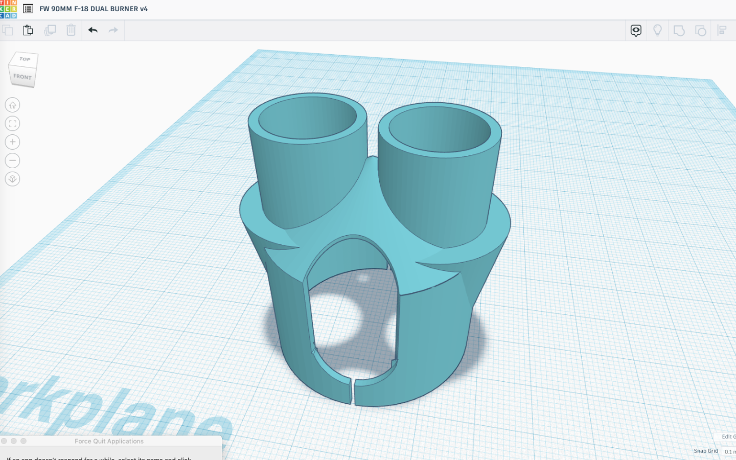

    Burners 1st test!
