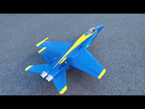

    My F18 is done and ready for maiden.
    Meget bra! Looks cool the Viking on vert stab is sick! What CG will you maiden??

    Hi all!

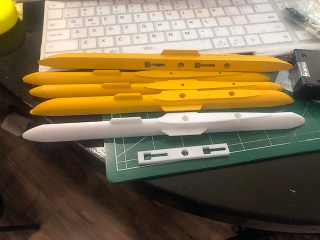

    Nice work on those rails InTheTubeDeep! Like Hugh said, they break easily and I still can't believe FW didn't make those as separate spare parts. They could have made a fortune on those alone, lol.
    Originally posted by InTheTubeDeep
    More rails final version
    Excellent job on the printing, you're really dialed in with that printer, a worthy skill. Nice to know a source for the rails, something that's easily broken (at least in my case) and almost impossible to replace without getting the entire wing. Your on "Source List". Bravo!
