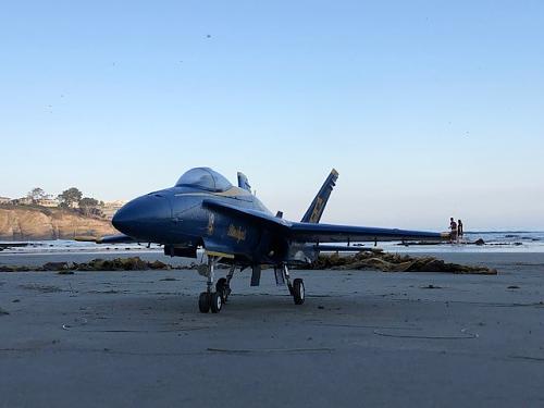

    Smal movie of my Blue Diamonds..

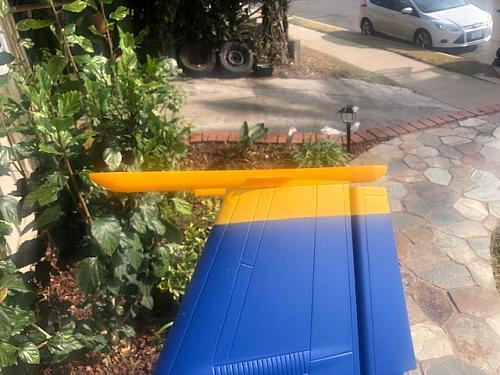

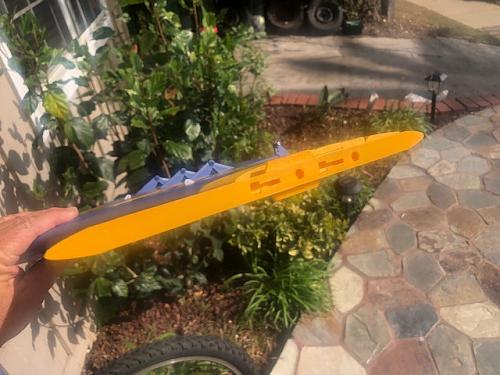

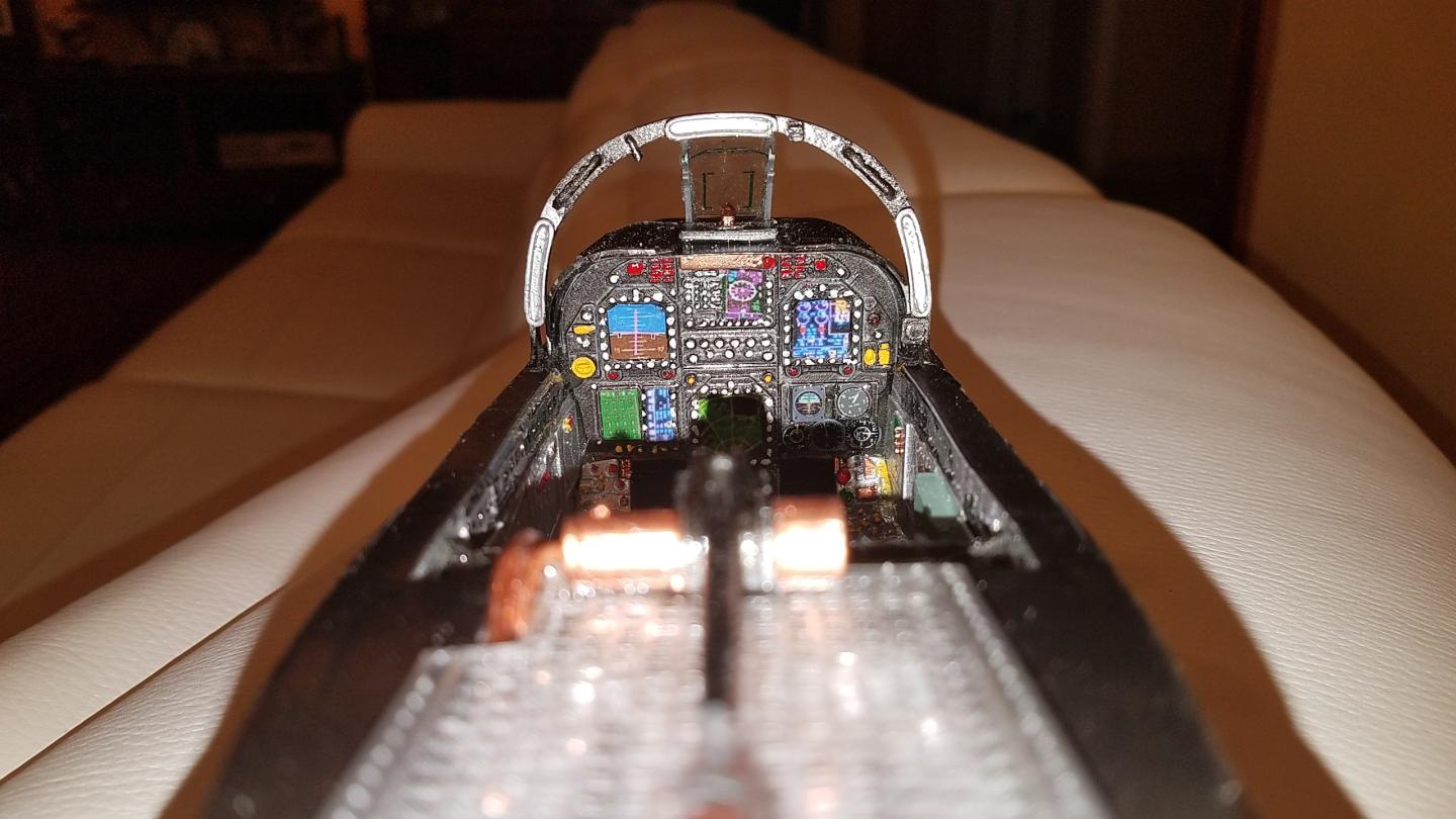

    Did some repainting on my Fw F18
    RS, Nicely done, Sir. And what nuts-n-volts wrote is spot on. Super repaint. Best, LB

    Did som repainting on my Fw Click image for larger version

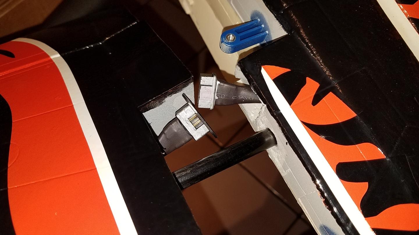

    My 2 cents, Using the AR637T along with one SPM4651T satellite in both my Hornets. Gains are something like 45/50/55 flaps up, 70/80/90 flaps deflected. I like this receiver as I use the flap switch as my FM switch and have the gain adjust set to the top right knob so I can adjust gains in flight. Additionally, the RX comes with a cable that plugs into the RX and you solder to the battery leads that gives you in flight pack voltage without having to buy anything extra. Although I still use a timer, I have the TX programmed to call out pack voltage every minute and a warning when it gets to 21.7 volts, indicating it's time to land. This way, if I decide to get "extra frisky" on a flight, I still know how long I can go before I reach the danger zone.
    If you need more RX channels, like having separate plug in channels for each elevator and/or ailerons or flaps, just go with the 8 channel AS3X AR8360T or even the 10 channel with the same remote. You'll also need a TX with at least one more channel than the RX you use to be able to assign the gain adjust in flight to the knob as this uses one of the many (something like up to 20) "ghost" channels in all their RX's. Same with "Safe" if you want to use that which will require an additional TX channel. So an 8 channel TX with the 6 channel RX will allow in flight gain adjust and "Safe". The gain adjust is a REALLY nice feature but I never use "Safe", although if anybody should, I'd be the best candidate for that!
    The RX and all wires fit under the battery tray, with the RX up towards the front and the 2 antennae going forward (seen in the photo coming out from under the front of the battery tray). The satellite has a 12" extension and is placed as far aft as possible with both antennae going in different directions (seen on the port fuselage wall in the back in the photo). Makes for a nice and clean battery bay. I've had it in several different places in the past, but Airguardian had suggested it and it worked great for me. I consistently get a good signal now with a low number of frame losses and obviously zero holds.
    Click image for larger version  Name:	20210701_170552.jpg Views:	0 Size:	215.9 KB ID:	352401
