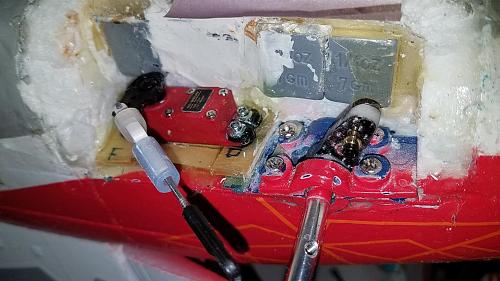

    3 possible issues IMO:
    1) RX got loose (unlikely)
    2) Check RX orientation and confirm it was correct
    3) Signal loss, in watching the video that may have happened. Assuming you placed the two antennas going forward. Keep in mind the signal reception area around the active end is like a donut, so if both are lined up along the fuse, you'll loose signal when it is flying directly at you or away. You should place one that way, and the 2nd up/down or left/right. With EDF's, I always add a sattelite RX as well with 2 more antenna. In the F18 I placed it behind the battery. With those 4 antennae, every possible directional plane is covered. Lipos, edf ESC's and any carbon fiber raise hell with signal, and with only 2 antennas in front, the battery and carbon tubes in the fuse block signal aft (where you were standing). You should also check for Frame Losses and Holds after flight in your TX telemetry. In the video, to me it looked like a couple points where you got a Hold.
    Just some random thoughts to pass on to the NTSB
    Good stuff! When I opened up the battery tray the RX is still facing forward, flat, all servo leads still firmly plugged in place. One of the antenna wires is facing aft and one facing forward (see photo). I may even have a spare satellite antenna I can use to add to the configuration. I should have done that to begin with.
    Hopefully it's just an ESC replacement and she's back up and ready to go for a second attempt. I will be pushing the battery forward to get closer to manufacturer's recommended. It really did act tail heavy from the start. I couldn't seem to get that nose down to control her and bring her back to me which is why she kept flying away from me until the crash.
    I'm determined! Especially with this exceptional good fortune thanks to my search crew!
