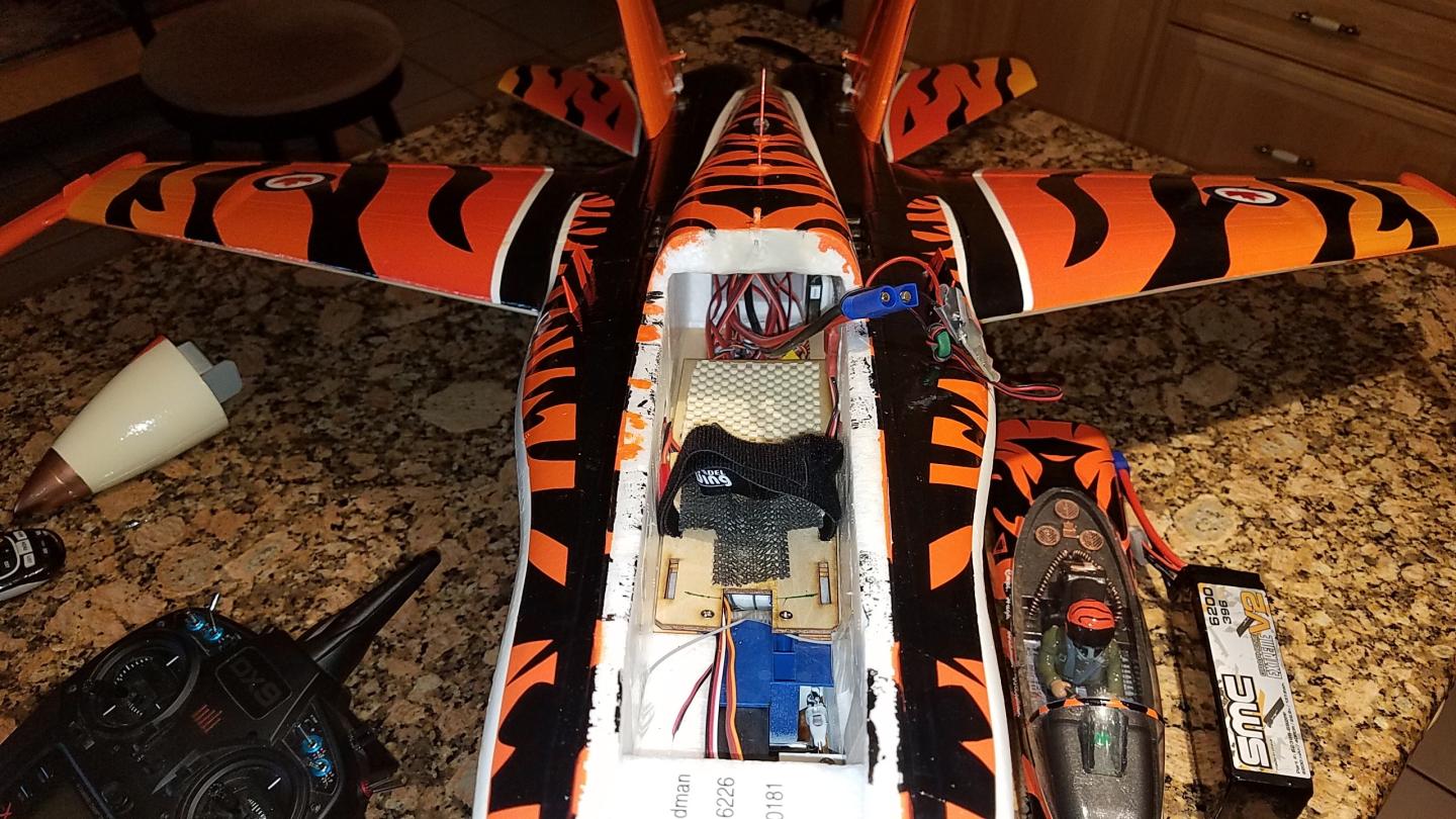

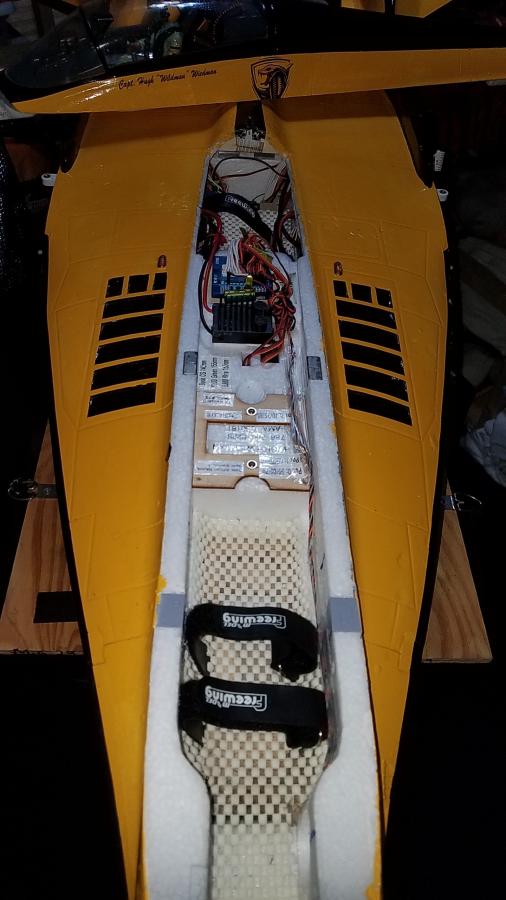

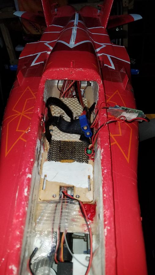

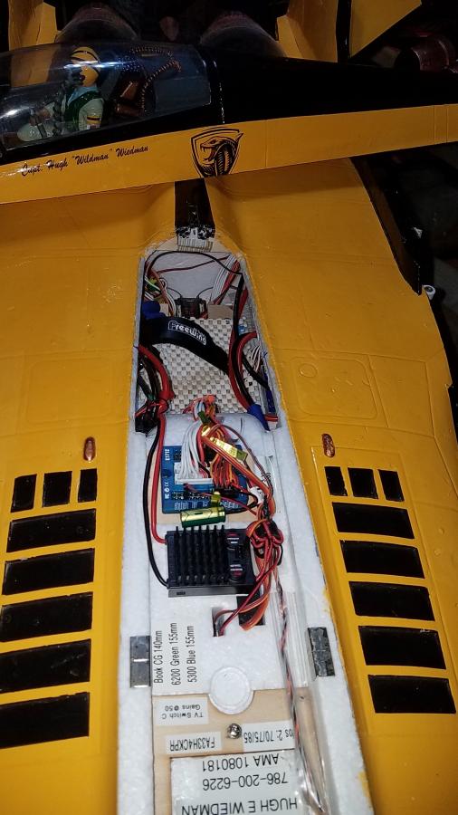

    The thing is you don't know what you don't know and while I put my receivers under the battery trays too, satellite (may be more than one) and antennae placement is critical. I also swap out long extensions, sometimes going to heavier gauge wire and mostly bypass blue boxes. I also don't use many gyros and when I so I use simple HE ones or the preprogrammed ones in EF planes. I have seen as many airplanes crashed or nearly so from improperly installed/ set up/ programmed gyros as planes that fly perfect with them.
    That's in addition to maybe moving linkages to get better mechanical advantage for servos, upgrading linkages, checking horns and mounts for security etc. I've even been known to swap fasteners I think are iffy for their application. There's a lot that can go wrong and all it takes is one minor thing. Even with this I have done dumb things, different throws on elevators where I have each on a different channel is a great example of my stupidity.

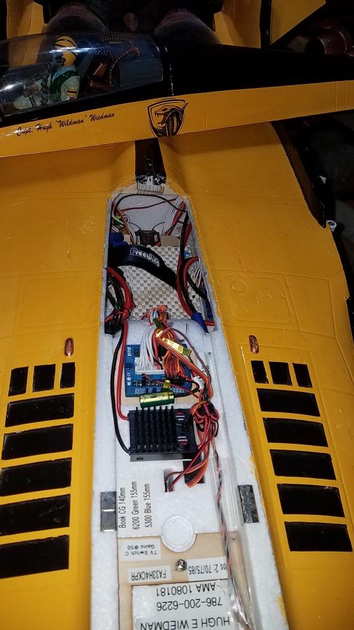

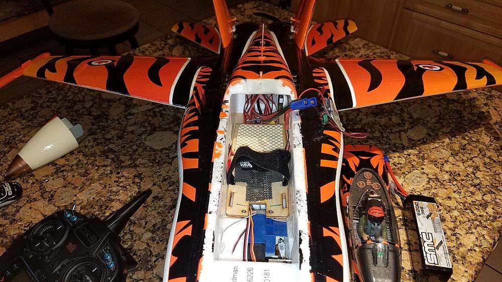

    Oddly enough Todd, I seriously doubt the RX placement had anything to do with it. I've got my RX's mounted under the tray in both F18's and several others including the Mig. It does not have to be "perfectly" flat or "perfectly" straight either, just close to it. I just use double sided RX tape and as long as it dosn't come completely loose, no problem.
    At the end of the day, those RX's are fairly simple to set up, only a few basic things to absolutely program. 1) most importantly the RX orientation, which can be confirmed by the gyro test response function which we did. 2) selection of the FM switch, which we picked the flap switch for. 3) gyro gain switch, which we used the right knob so we can instantly dial 0-100% of programmed gains in flight, and 4) the 3 Flight Modes actual gains on each of the 3 flight surfaces. That's basically it. It does a lot of other things you can program in, like nose gear gyro, heading gains, adjusting sensitivity, priorities, setting auxiliary surface gyros like TV units, etc. but we left those at default settings and went with the basics.
    You can get quite exotic with setting it up like Jon with 2 Bros, where he uses variable gains based on throttle settings and 2X gains on TV units (which I use on 2 aircraft), but we set up the basics.
    Only a couple of errors could have caused it: 1) the RX came completely loose-doubt it, even taping it down would have worked for a while 2) got the wrong RX orientation-doubt it, we did the gyro test, 3) somehow heading hold got programmed in-doubt it, you have to go through another programming step to do it, 4) some other servo failure. A single flap failure would make it unflyable (especially on the super sensitive F18-happened to me) but you changed the flap servos to hitecs. Possibly a failure in one of the elevator servos, linkage or elevator getting loose, witch would doom the flight (happened on an F4 where one elevator got loose on shaft-sending it into a blender). So this is a long and drawn out rambling of mine that basically concludes that I have no fricking guess why this happened. What about signal loss?

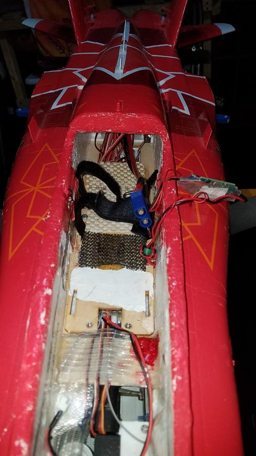

    Agree with you completely. Certainly sounds exactly like a gyro issue to me, but can't imagine where it went off. We programmed it over the phone together and set it up, I thought, exactly like both of my F-18's, which have performed flawlessly. My strong suspicion is in the RX orientation, as gains, FM switch and gain adjust where set as mine are. Todd even did the gyro response test, which would show any incorrect surface movement and apparently everything moved in the correct direction. I'm at a loss, programmed 20 of these Plus RX's in the last 6 months, which are fairly straightforward and haven't had anything like this occur. Could Heading Hold have been inadvertently programmed? Hope Todd finds the aircraft and we can see what the issue was.
    The only other thing I can think of is when I placed the RX under the battery tray I wasn't really sold on that because I didn't have immediate access and two, there was no real flat area to mount it so I used Gorilla Tape to secure it where I could. It's very possible that with the lack of surface area to secure it that it came loose. That would definitely explain the erratic flight and loss of control. I just watched the video today and it was flat spinning, pitching up, rolling...It was a mess almost from the start.

    All good questions. It flew like it was extremely tail heavy but I know you recommended what you have found to be the sweet spot so it shouldn't have been the issue? It's insane how many problems I've had over the years with this model. No other EDF has ever come close to these types of issues. I took my drone out to see if I could find it and no luck. The field it headed towards in the end is surrounded by heavy, dense evergreens so my guess is it crashed in the woods which means bye bye RunCam, Admiral 6S 6000, AS3X+ and electronics. Ugh.

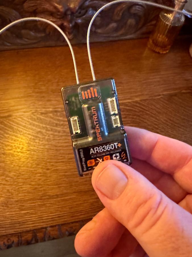

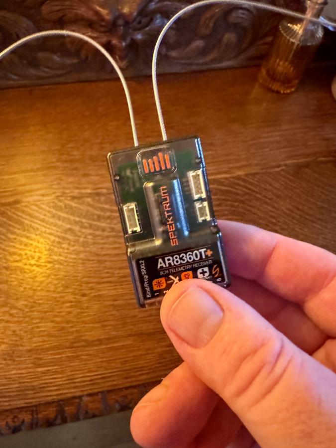

    I have to believe the programing of the RX was flawed. I have done three F-18's now with the Plus RX, two PNP's and one parts airframe. All three have performed flawlessly with the exception of the flap servos which I replaced. My stepson preforms some awesome high alpha flights on par with Airguardian with his F-18 and its pretty cool. He's a Marine reserve flying the real F-18 and he mimics what he does in the real F-18.
    One thing to note is updating the RX, even a newly purchased one needs to be updated to the current software. As an example, I just purchased, within a week, a 10 channel Plus RX and it needed to be updated. This is done with the Spektrum Programmer app with the Spektrum Update Cable purchased through Horizon Hobby. It is a must!!!

    Well I wish I had better news, Hugh Wiedman. Went to maiden last evening and she took off fine but instantly I could tell something was off. I fought the sticks the entire time and all she wanted to do was flip, roll...Completely uncontrollable. I tried my best to bring her back and land but she wasn't having it. She face planted in the dirt on a hill. I tried locating her to no avail. She's gone in the wind. I can't believe it. Hugh, you did everything to help make her as flight worthy as possible but I am now convinced after 8 or 10 of these models that there is some gremlins in her. Nothing else makes sense. To be that wonky and unflyable after installing the AS3X+?? I won't ever buy this version of this model ever again.

    Oh 💩, I can't believe it. I would have bet a fortune that you would have had a tremendous success. All I can think is we (I specifically) screwed up with the programming in some way, just can't possibly imagine what it was. I'm sure you didn't have time to dial the gains off as you most likely were too busy on the sticks to turn the knob off. Definitely sounds like a gyro issue, wanting to roll over. Almost like the RX orientation was off. Don't blame the model, I'm sure I must have "screwed the pooch" on programming, so so sorry. :nauseated_face:
