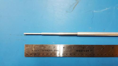

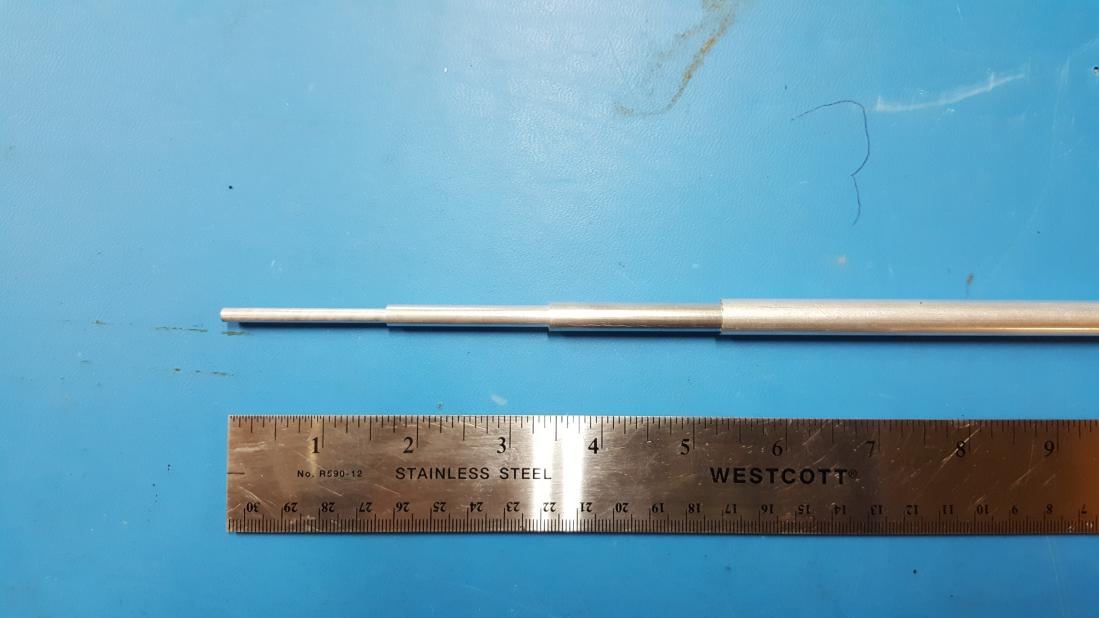

                      K&S baby.....

                            K&S baby.....
                            Click image for larger version  Name:	20170501_125611.jpg Views:	1 Size:	52.2 KB ID:	73812
                            Exactly what I had in mind, even bought the tubing but noticed that the ladder was going to be offered as an option/upgrade so decided to "wait and see". I had even considered making it truly telescopic and hinged to fit in an actual box and door installed in the side of the fuse.:Ligthbulb: At some point I realized that I was probably making my same old mistake of "scaling" myself right out of half the flying season !!!!!!! Maybe next winter with the operable canopy and the,and the,and the,Brad
                              #2634
                              Exactly what I had in mind, even bought the tubing but noticed that the ladder was going to be offered as an option/upgrade so decided to "wait and see". I had even considered making it truly telescopic and hinged to fit in an actual box and door installed in the side of the fuse.:Ligthbulb: At some point I realized that I was probably making my same old mistake of "scaling" myself right out of half the flying season !!!!!!! Maybe next winter,Brad

                                I plan to make mine recessed in the fuse and telescoping. It shouldn't be too difficult to do.
                                I couldn't figure out how to keep the "telescope" from over extending and falling apart. No room for stops.......unless you had a set of lines set at designated lengths attached to the inside of each segment and then anchor them at the top.:Thinking:Hey , I might have just figured it out!!!!! Brad
                                  #2636
                                  I am using 7 tubes sizes from 10mm down to 4mm... 10, 9, 8, 7, etc... The 9, 7 and 5 form the stops for the 10, 8, 6 and 4. Make sense?
                                        So you could cut small rings of the 9,7,and 5 top and bottom to form stops. I also thought of that but wondered if the resultant double stepdowns would be too much to look scale. And hey Clearblue my freind there's always room for more input. A telescopic cockpit access ladder that folds into a hatch with a closeable magnetic door would be the:Bomb::Cool:Brad
                                          #2640
                                          You got it. I wondered the same thing Brad but after getting the tubing and sliding it together to mock up how it might look I don't think it will be a problem and I am not trying to be crazy accurate (scale) anyway. The tubing walls are .45 mm thick so you end up with a 1 mm step from one tube OD to the next. I just guessed on the largest tube needing to be 10 mm since I have no plane to reference to. Plus, I don't think the bottom tube would look right if it was any smaller than 4 mm.
