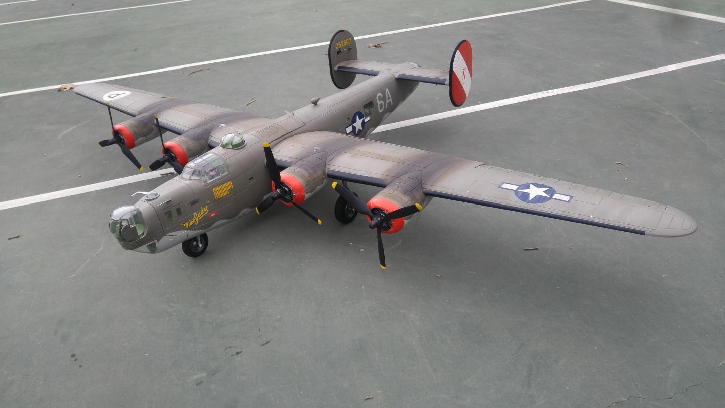

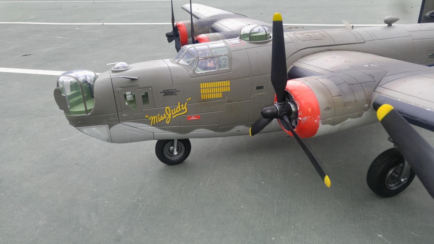

      Miss Judy is ready for flight.
        What was your technique on dulling the coat?
        Current Fleet: Flightline Tigercat, Flightline Bearcat, Eflite Corsair, ESM Skyraider, Pilot RC Yak-54 30%:corsair
        • Ted7rns
          CVF Warbird Squadron CO
          • Mar 2015
          • 26
          • Newbury Park, Cailfornia
          #724
          I had the paint colors scanned and made at home depot. Then I took the underside light grey and mixed it like 50-to-1 water to make a wash to cover the topside.
          Made long streaks with a paper towel.
            So far I've done all my weathering on my airplanes with the air brush. I need to start trying the wash approach. I just wasnt really sure how exactly to mix it, or even what to put in the mix. Thanks!
              The engine exhaust was done by an Airbrush.
