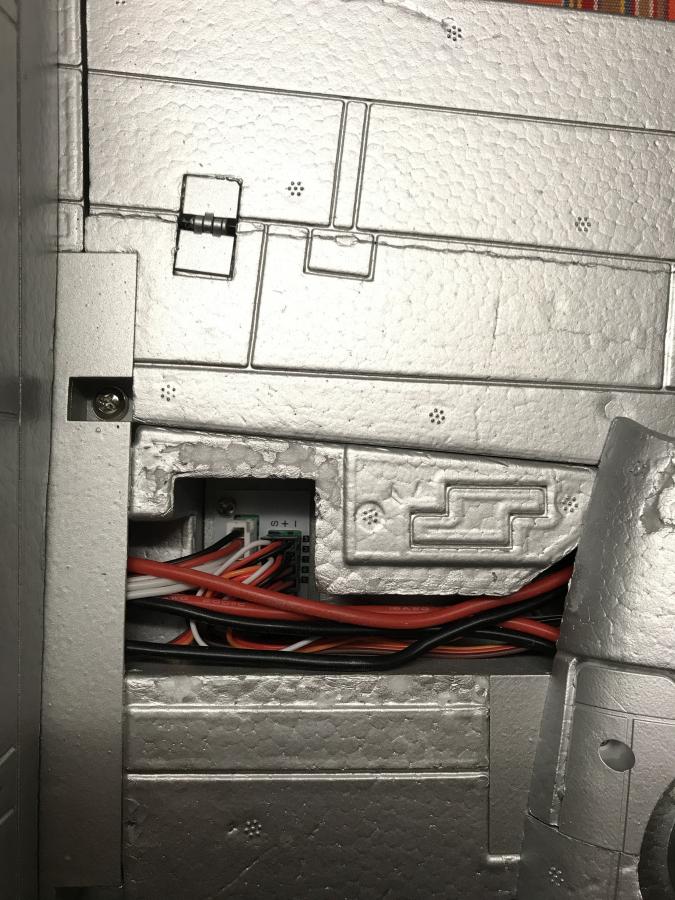

    Look at the wing root connection Click image for larger version  Name:	IMG_1617.JPG Views:	1 Size:	110.1 KB ID:	113267
    Thanks,
    Got back on the motors today. I've checked all connections, tried throttle calibration with no response from the motors. I pulled the covers off the back of each nacelle and tried programming each esc with my programming card connected to the UBEC. Only 1 motor acknowledge the card with 4 beeps. Nothing working now so I'll call Motion Monday and ask what I should do. Never had this issue before.

              I just tried everything I could think of and finally pulled the motor / esc out of the nacelle to test - nothing! I pulled a Castle ESC out and it worked perfectly.
              I've finally got everything working. Throttle calibration and one motor with the brake setting "on" created the problem. I unplugged the esc signal wires from each esc and reset each one using a separate rx and 4.8v rx battery. I followed the sequence in this video and got all of the motors working correctly. I probably could have done the calibration on all 4 motors at the same time but I guess that's part of the learning process! Here's a good video that explains how to set your escs: https://www.youtube.com/watch?v=KV0DzOQDk8M
