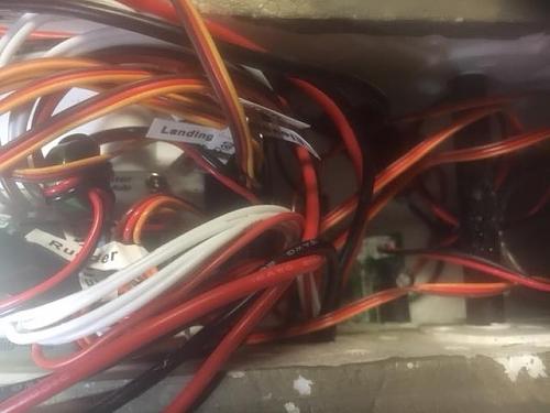

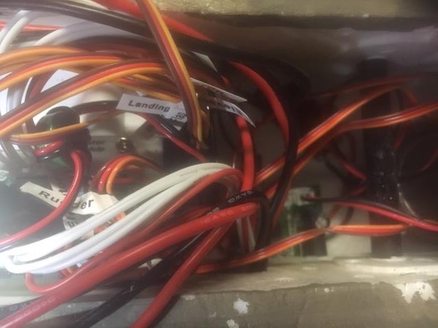

                          I got a chance to test the electronics. It all seems to work OK! I managed to pry off the tail turret too! Slow, steady pressure and it finally pulled the paint off.
                          My receiver is too wide to sit next to the connector board so I need to work that out.
                          If you guys would post a pic of your wiring it would be appreciated. I'm curious how everyone is doing theirs.

                            I'll go out and take a pic. My RX was too wide also.

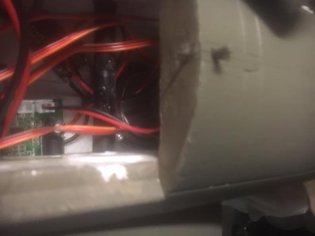

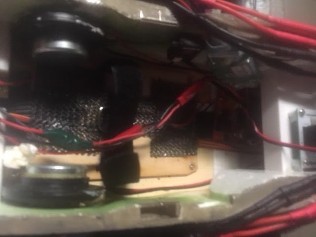

                              I have some extra wiring going on due to the Mr. RC Sound card and amp.
                              The first picture on the left shows the Admiral 10ch rx with end pin mounted on the rear side of the foam bridge. I have the servo actuated canopy turret and this arrangement made it convenient for the servo plug.
                              The picture on the right shows the two Mr. RC Sound amp cards on the floor and the bass speaker mounted aft of the black spar tube.
                              The picture on the bottom shows the twin TT-25 transducers, sattelite rx, ubec, The Mr. RC Sound 4.1 card is mounted on the floor under the foam bridge.
                              Sorry, the lighting is pretty bad today. Hope this helps. I'm sure there are other options. This one works for me.
