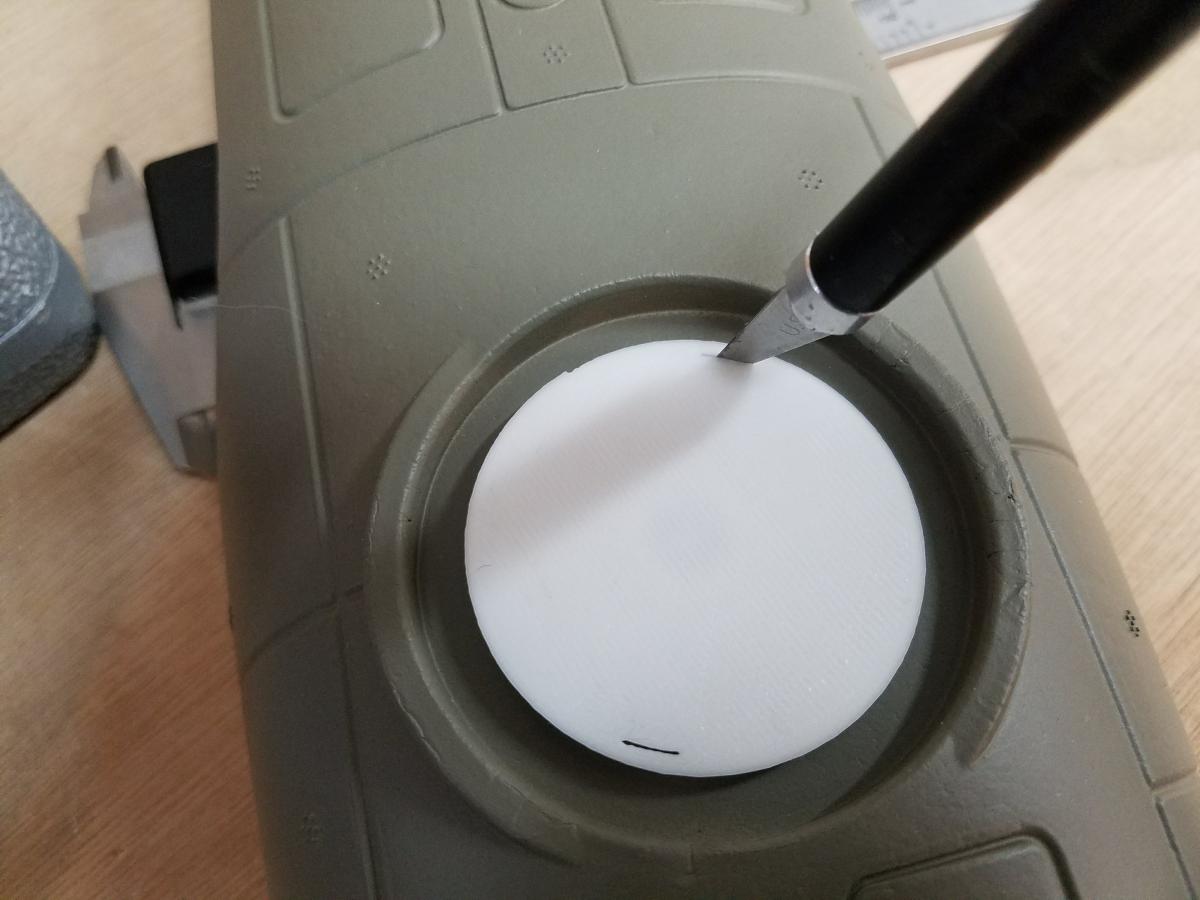

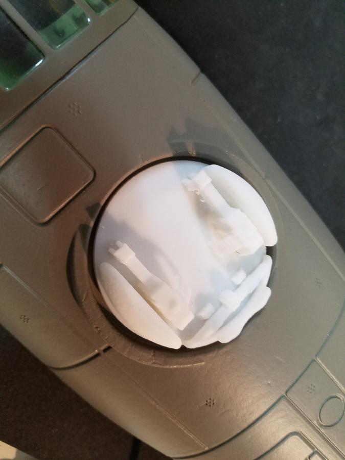

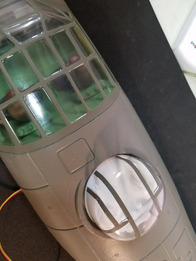

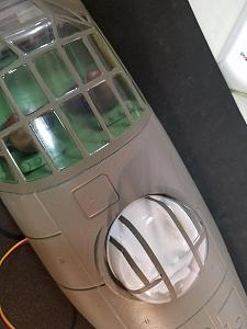

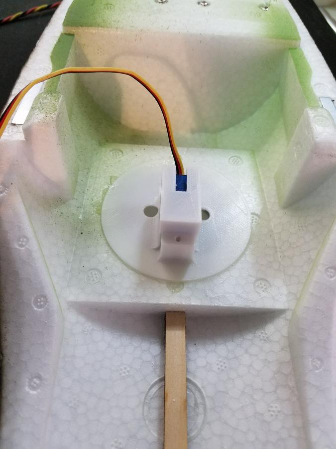

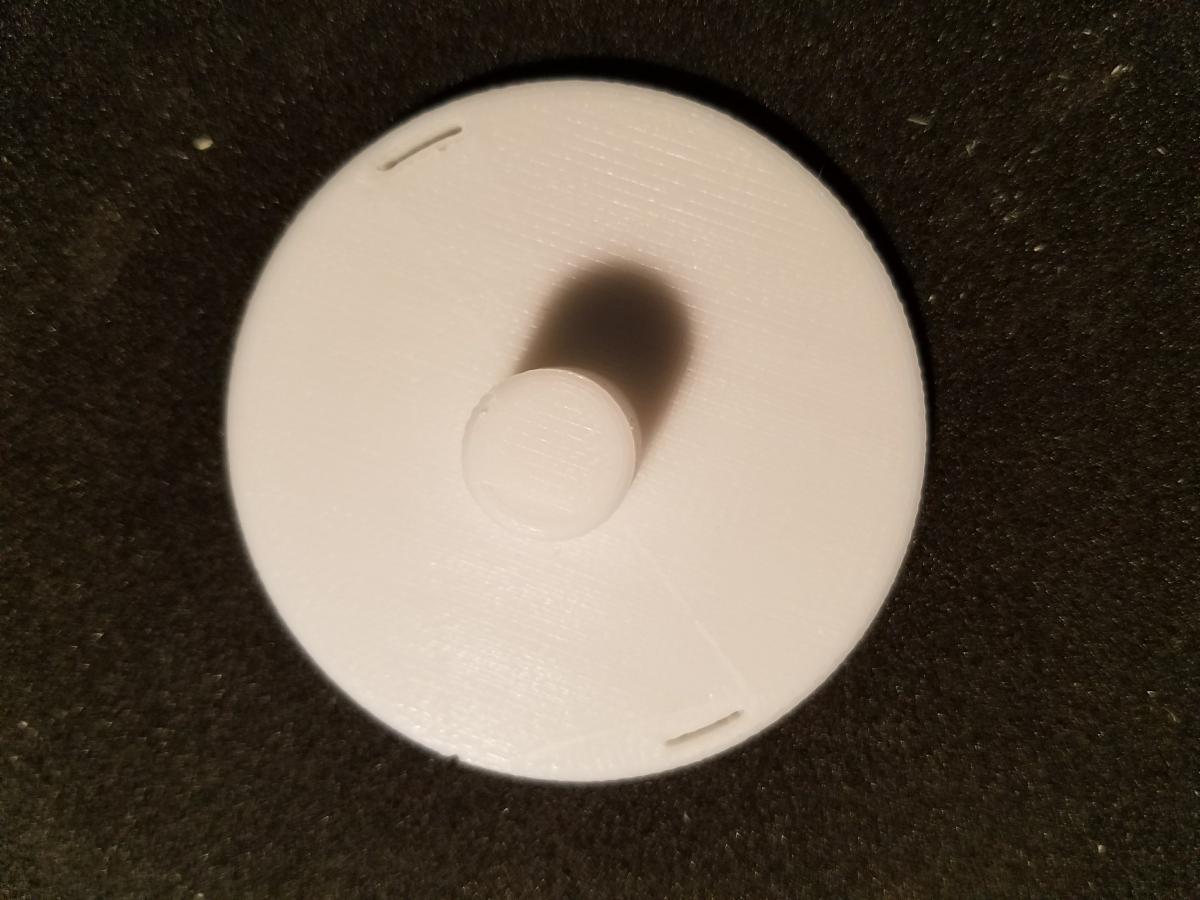

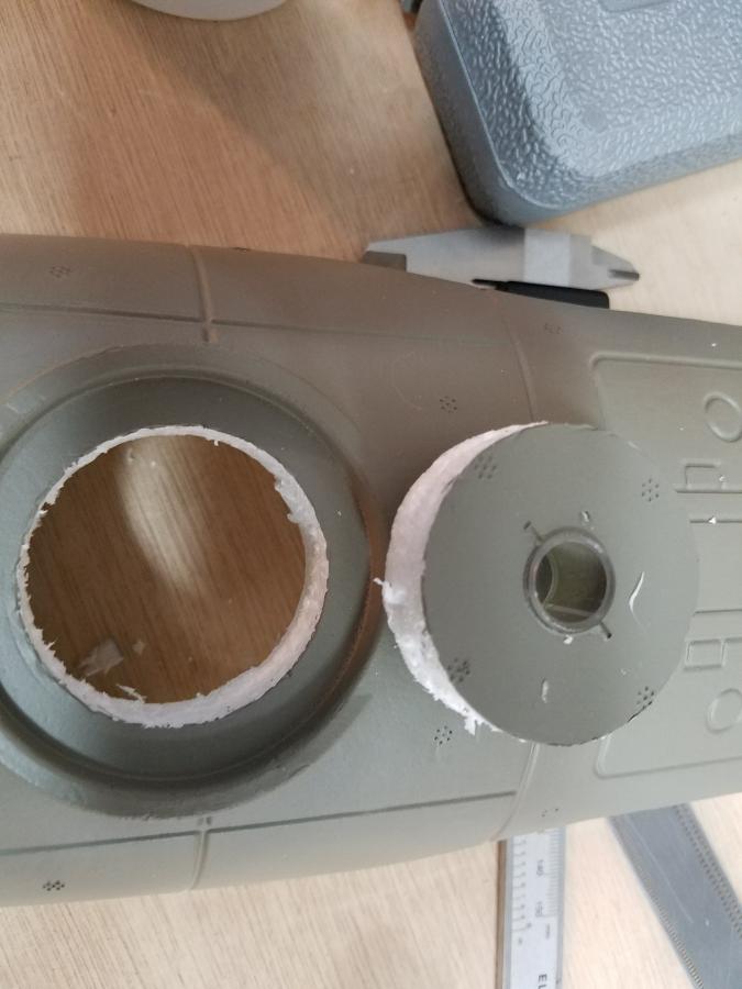

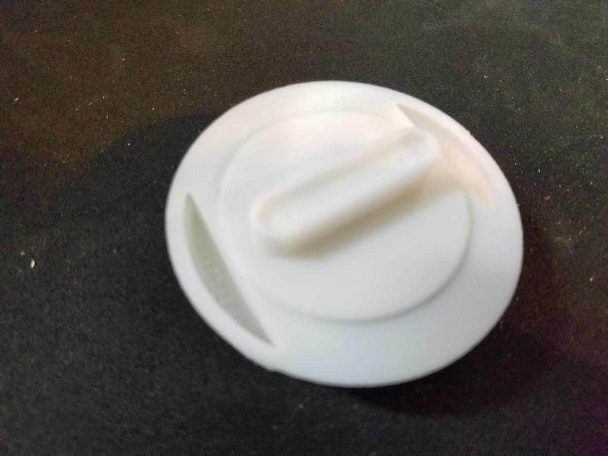

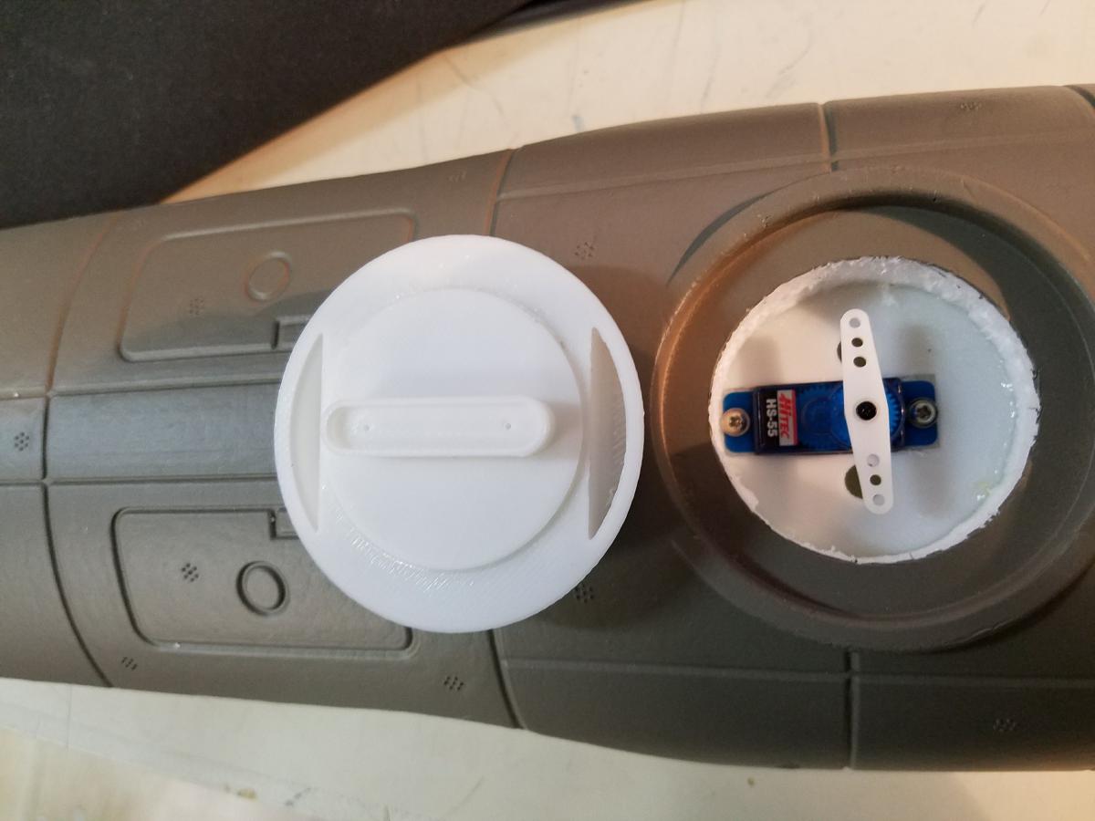

          Finished the top turret parts and installation. I modified the HS55 servo for 360 operation. Works extremely well and not a lot of room taken up inside the fuselage. Pretty happy with it.
          I made one tool that has a slot for the X-Acto knife to cut a circle using the original turret pivot for center.Click image for larger version

          • Originally posted by mirored View Post
            Very neat install!
            • Ingenious! That tool for the X-Acto is brilliant. :Cool: Any chance you might share the stl files? :)
