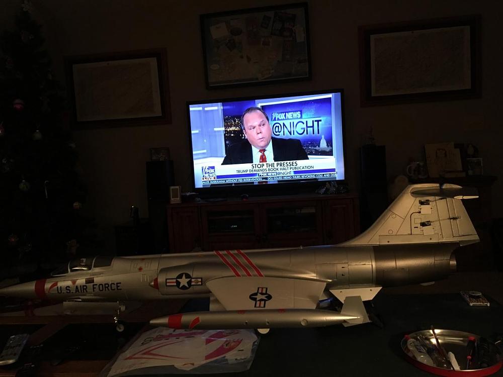

    He's probably busy playing with a new toy.

      See... I was right.

        Hahahaa... go figure. Nice one, TI. :Cool:

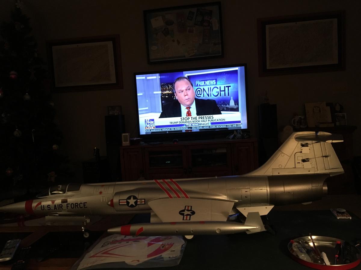

            TI, your 104 is looking fair and balanced!:Cool:

              Nice news pun! :Cool:
