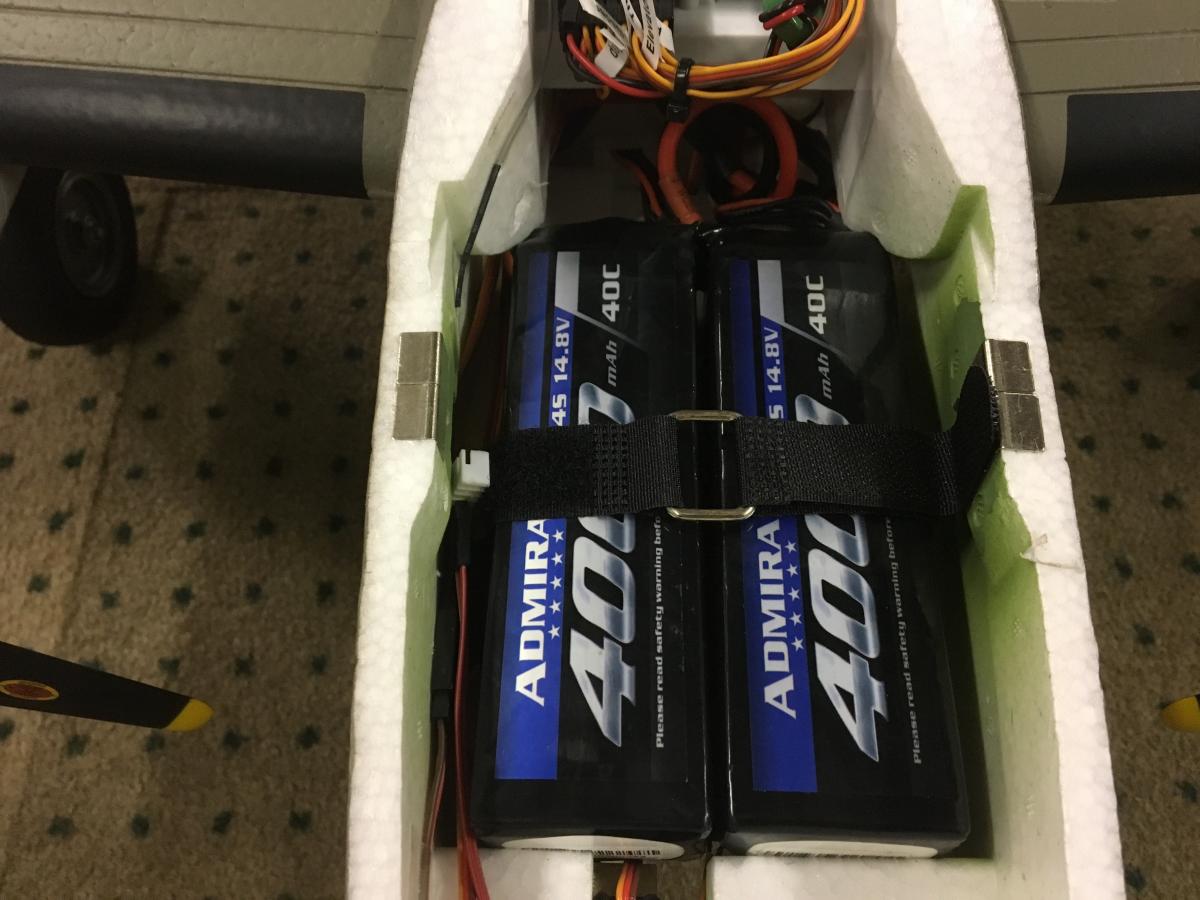

                            What size packs is everyone using and where’s your go to location for CG?

                              #834
                              For the guys who have flown her. I have CHL 4000 batteries in her pushed as far back as I can. It's nose heavy in a heavy way. What CG are you guys using? Because at 76 it's gonna need some tail weight. Are you guys just flying her that heavy?

                                  I use the Admiral and CHL 4S 4000s and run them all the way to the rear of the battery bay. And she flys great.

                                    #837
                                    Thanks Tirediron......I placed about 3oz under the H-stab and she is balanced at 3". The CHL's 55c weigh 100 more than the Admirals. So I went ahead and added the wt. The CHL's have xt90 connecters, so now I have to wait for the adapters before that first flight.

                                        I have been flying mine with Turnigy Graphene 4S 4000 45C packs, which are heavy. I have them pushed all the way back like in TiredIron's pic. I also have all of the power connection leads run around the back of the rear wing spar tube to get as much weight to the rear as possible. I'm slightly nose heavy, but she flies great. Inverted requires no back pressure at all.
