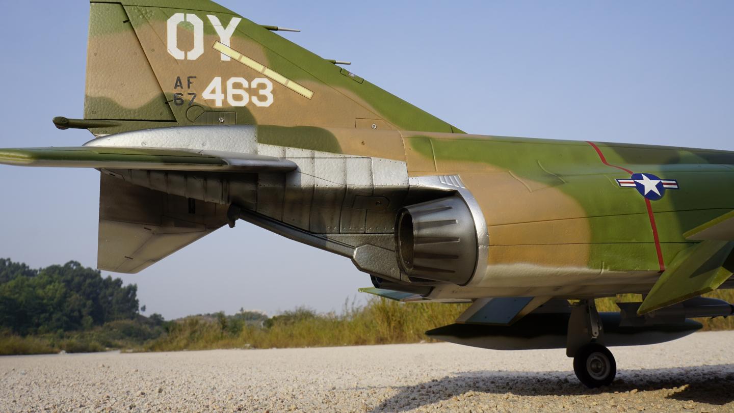

                      Tcat and the others are right about wanting dirty Rhinos. Here are some photos from last year of the model I painted here at Freewing to use as the base reference for the production model. We tinkered with the idea of fading in some staining, but ultimately decided to do the four-tone silver/gunmetal/titanium/smoke paint masking that has been seen so far on the Stock Production pics from Bajora and Xplaneguy.
                      I'm posting these photos just to show those who are curious what a little airbrushing can do to bring out the grit in their brand new factory fresh painted PNPs. On the PNPs, a lot of the paneled painting is already done for you out of the box. Personalizing the model even further takes little effort and in my opinion is very rewarding.
                      To start off, I used a flattened bamboo skewer to make "rivet" impressions, same as I did on the Freewing 80mm A-10. Then I used a Post-It to quickly mask thin panel lines along the upper section, using reference photos. These panel lines were too thin to be molded as panel lines into the foam mold --they would have looked too overdone-- but a quick dusting with an airbrush gives the impression of a shadow where it's actually entirely smooth foam. The colors shift depending on how the light hits it, because I used some matte aluminum on certain panels.
                      Click image for larger version  Name:	_DSC8959.JPG Views:	1 Size:	113.4 KB ID:	117183Click image for larger version  Name:	_DSC8961.JPG Views:	1 Size:	88.1 KB ID:	117184

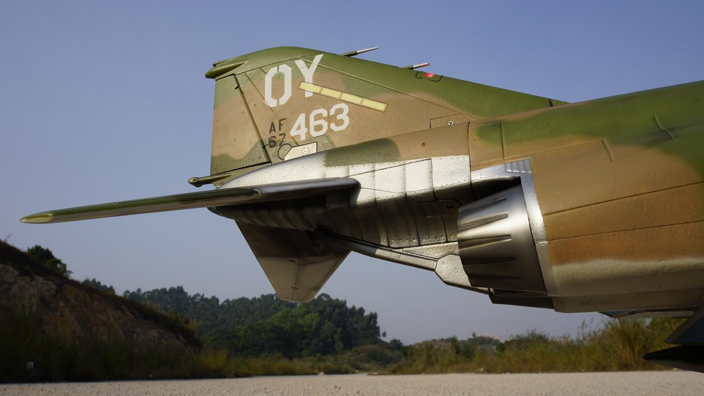

                      It's difficult to tell, but the burner cans are airbrushed with aluminum, titanium, clear gold, clear blue, and the slightest hint of clear purple. Some of the F-4 references we had showed very colorful heat patterns. The trick on a model is to remember that a little goes a long way. The stranger colors should only show up in certain light and at certain angles. Otherwise it looks "too blue" or "too gold".

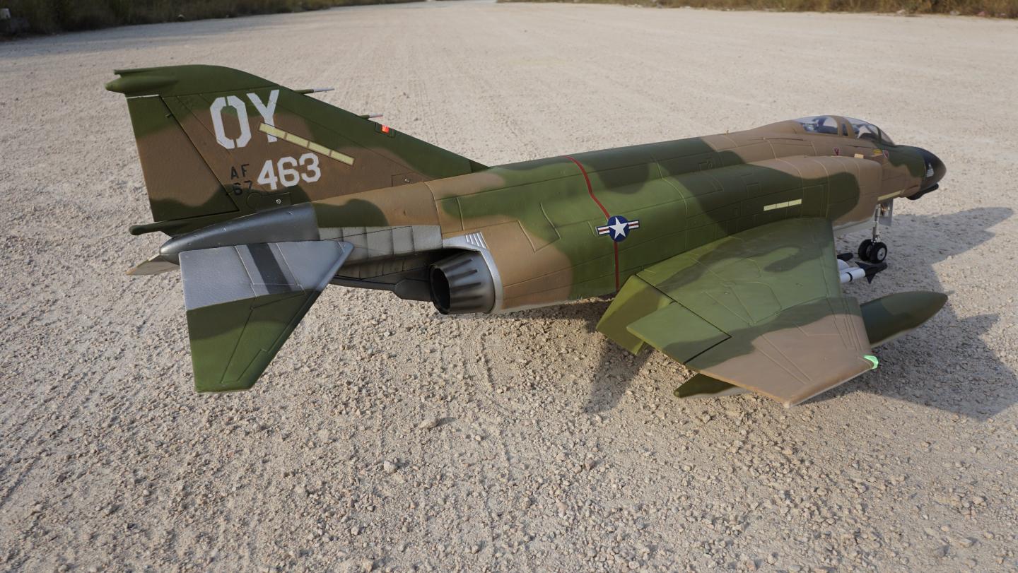

                      For the top side of the SEA Camo colors, I airbrushed shading into the panel lines at random areas with darker variants of the top colors, and also mixes of reds, browns, and blacks. Over each of the three base colors I also dusted the same color mixed with 10% white. This is a good technique for breaking up the harshness of the colors and to simulate fading in the hot Vietnam sun. Based on reference photos, I also highlighted certain vertical panels to simulate stresses and slight waves or differential shading. Finally, I dusted the entire model with a hazy mix of light brown, again to blend in all the colors as they would appear to the naked eye in true scale. Mask off the bare metal areas, obviously, to protect them from that final shade of dusty overspray. If done properly, the final effect of all of this layering is that the weathering shouldn't look overdone in real life, and in photos, it should barely show up. Less is more.
                      Click image for larger version  Name:	_DSC8982.JPG Views:	1 Size:	161.9 KB ID:	117181

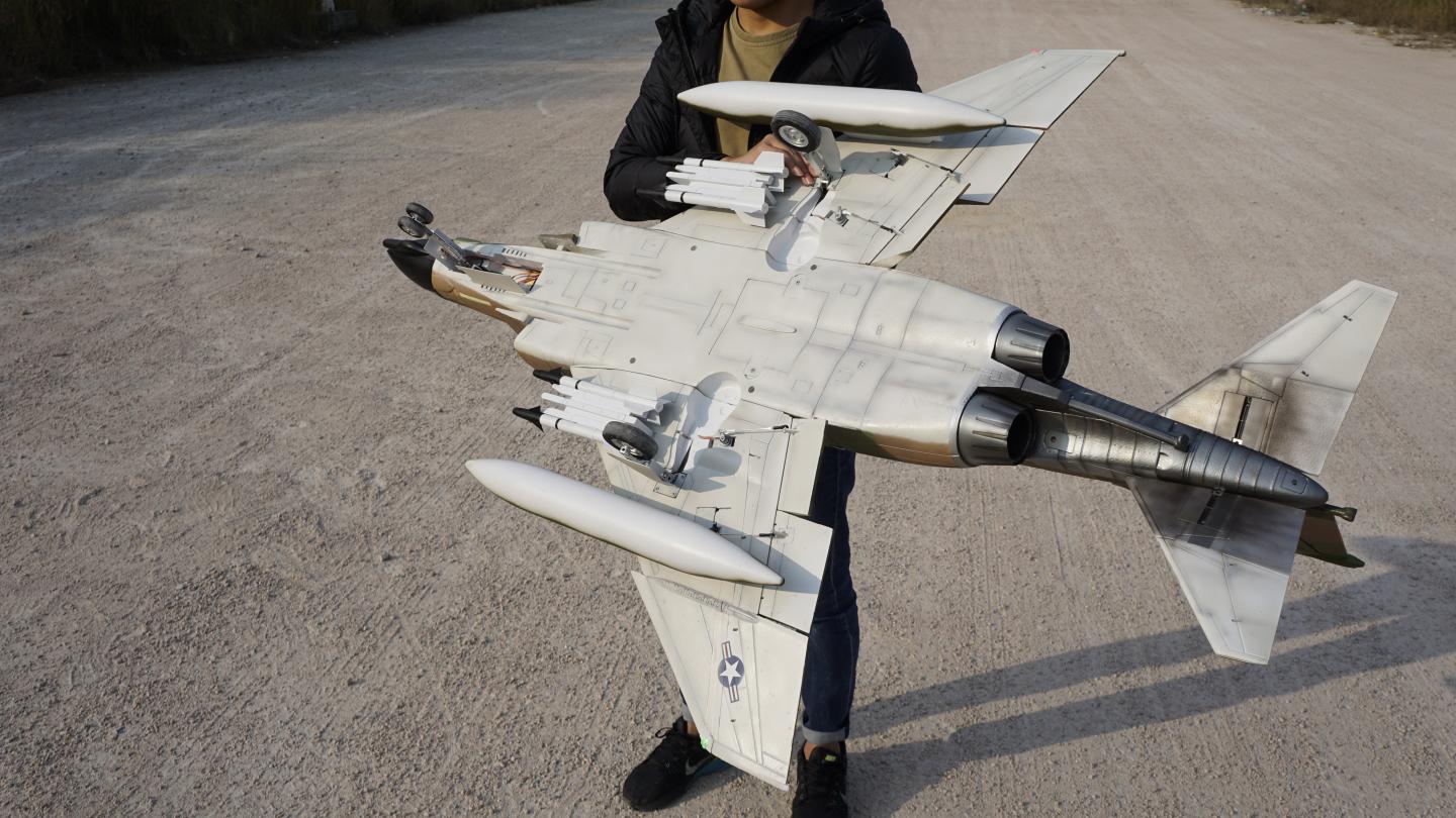

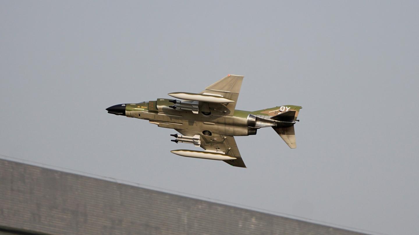

                      For the underside, I sprayed varying colors into the panel lines. Dark reds, rust, brown, tan, yellows... all kinds of strange colors mixed together. In areas where heat or oil or other agents would accumulate on the real aircraft, I sprayed more sensible colors, like oily blacks. Then, I covered 98% of all those colors with the original underside color. Again, it shouldn't look overdone up close, and should look reasonably sensible from a distance. Compare my in-flight underside pic (slight weathering) with Bajora's in-flight underside pic at a similar angle (factory fresh PNP). 30 minutes of painting goes a long way.
                      Click image for larger version  Name:	_DSC8979.JPG Views:	1 Size:	179.9 KB ID:	117182Click image for larger version  Name:	_DSC9103.JPG Views:	1 Size:	49.8 KB ID:	117185
                      For color references, I used a brand called "MiG by Ammo". Credit to my good friend Levendis for his recommendation. The "MiG by Ammo" paints were surprisingly extremely accurate when put up against the real F-4 at the museum we used as a color reference (hands on, in person, I did it myself to ensure accuracy). The four colors are available here as part of a set. One set is enough to add the differential shading to the stock PNP colors, if you find that you want to simulate the paint fading I recommended about. Painting the entire model would require more paint, but again, as a top coat of shading, the set linked below is more than enough, and the point is for the paints not to be 100% exact, but 90%-ish to show a difference in age. I really like these MiG by Ammo paints. They're water wash up acrylics, like Tamiya. Odorless, very easy to use, and easy to shoot at 15-20psi with a 4:1 paint to thinner ratio, depending on distance from target and desired line thickness/attributes.

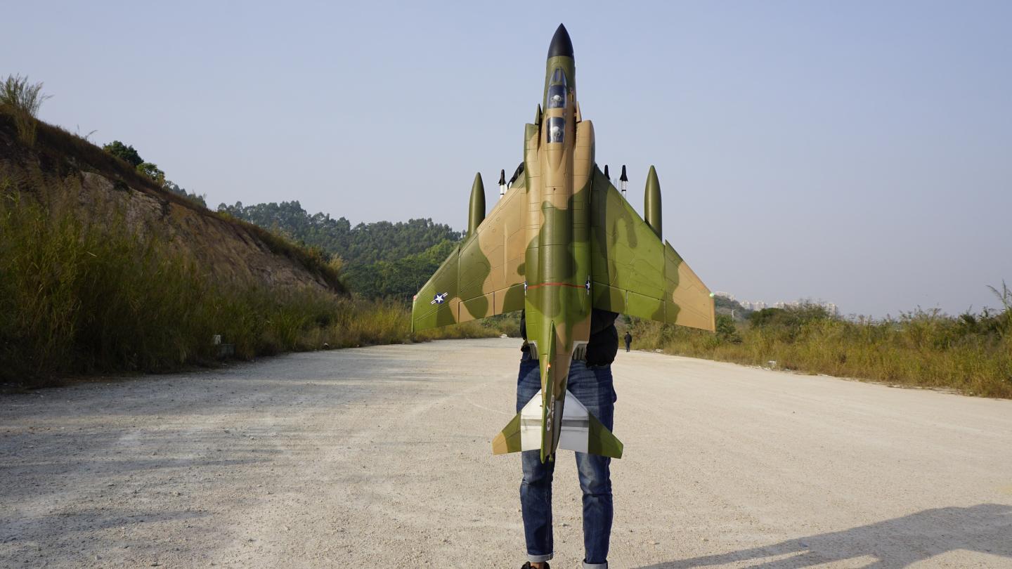

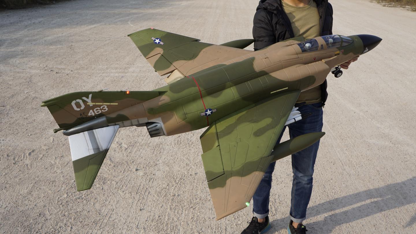

                        For a bit of fun, here is one of our test pilots holding up my weathered F-4

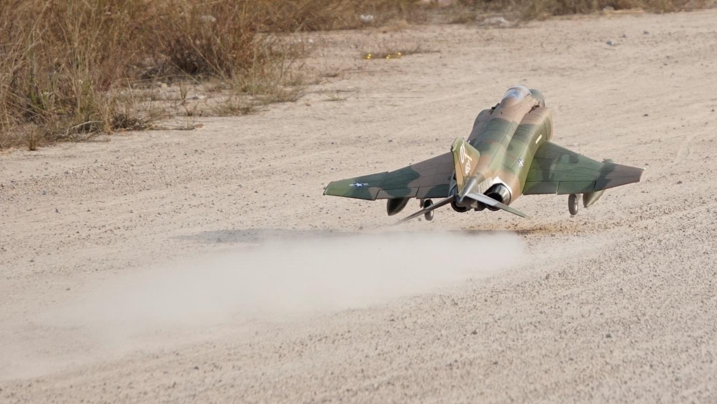

                        and probably my favorite picture from last year.... an afternoon ops picture taking off of our dusty gravel test field!

                          Thanks for the tips Alpha. Awesome sauce.
                            #193
                            Truly outstanding (and perfectly executed and understated) weathering Alpha. The exhaust trail especially is incredible.
