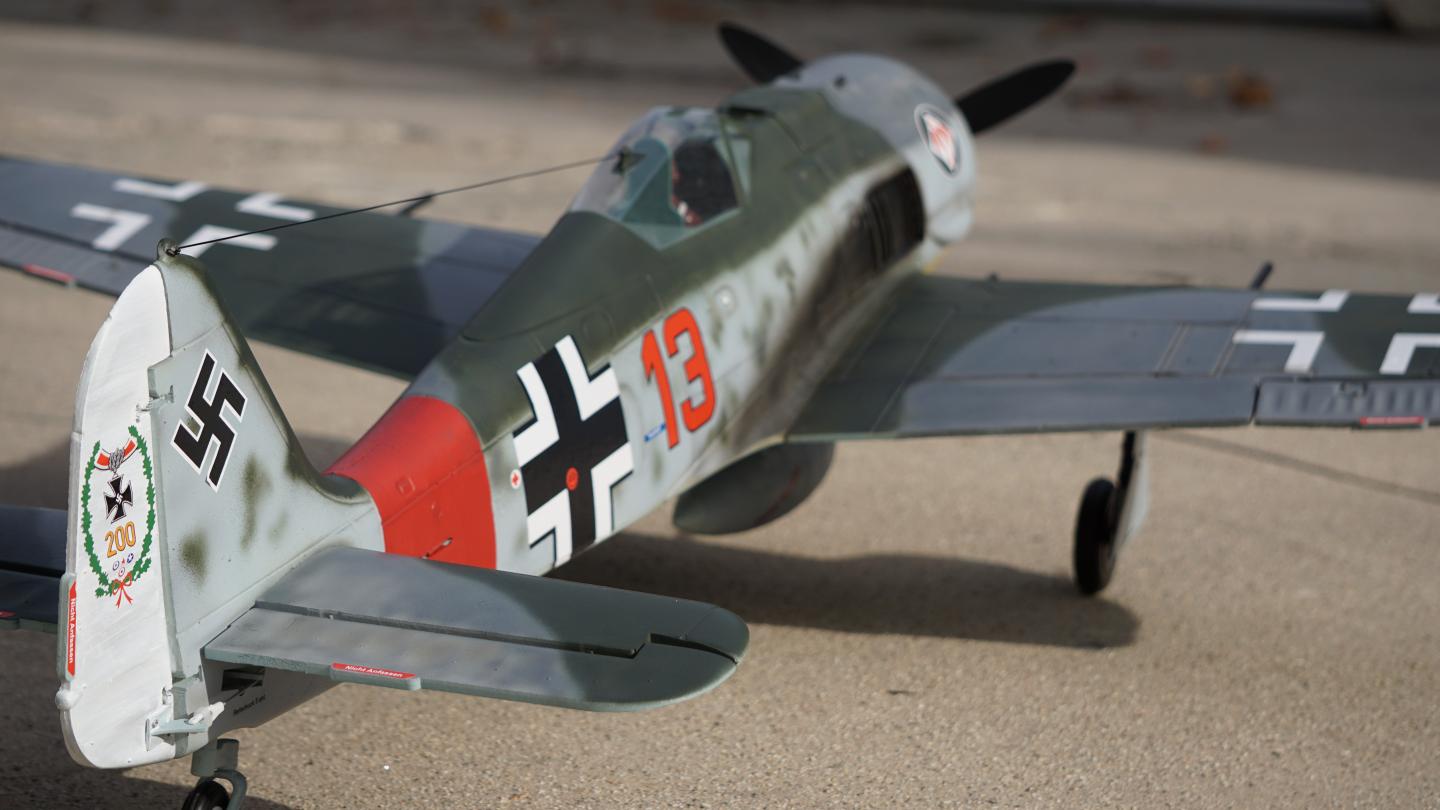

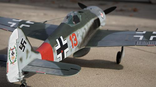

          • An Alfa models FW-190 A8. Did a complete repaint to get it a little more accurate. Love to do the Axis paint jobs!

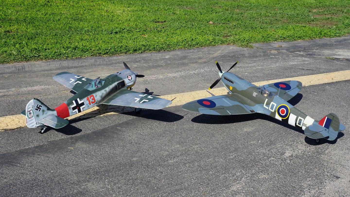

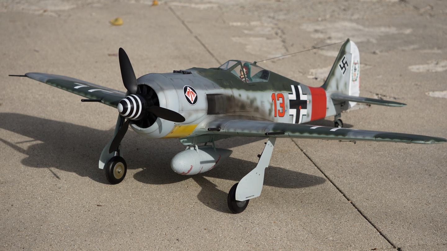

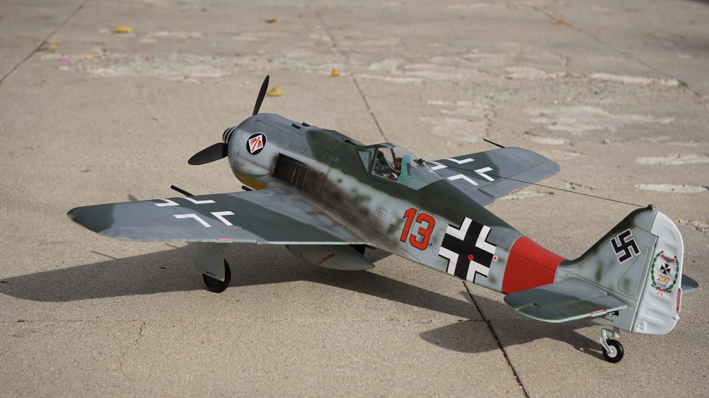

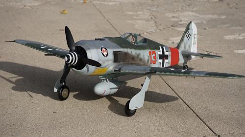

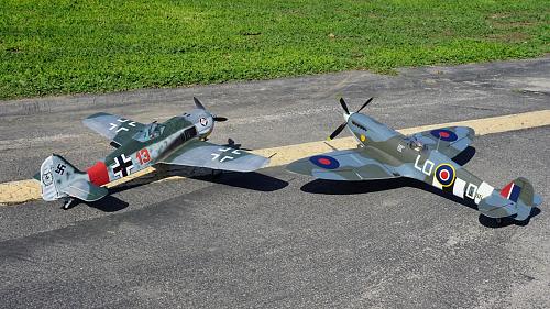

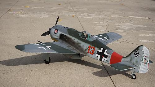

                          • I like your Alfa FW-190 repaint, Hardaway. I painted the same scheme with my Freewing FW-190, that we eventually used as the factory's paint reference for the Version 2 a year and a half ago.
                            Click image for larger version  Name:	DSC00210.JPG Views:	1 Size:	141.9 KB ID:	128040Click image for larger version  Name:	DSC00217.JPG Views:	1 Size:	95.5 KB ID:	128041
                            Click image for larger version  Name:	DSC00211.JPG Views:	1 Size:	153.7 KB ID:	128042Click image for larger version  Name:	DSC00369 - Copy.JPG Views:	1 Size:	309.7 KB ID:	128043
                            • Thank you guys!!! The Alfa Models were good little planes, but you had to do a lot of work positioning the servos to work smoothly (wire pushrods to both ailerons from one servo), and they were very fragile... Love the paint job Alfa. May have to do the 1400mm FMS that way too!! But I really want a tropical scheme! :Cool:
                              The camera flash washed out the mottling quite a bit. It is a bit more pronounced in person....

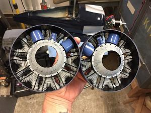

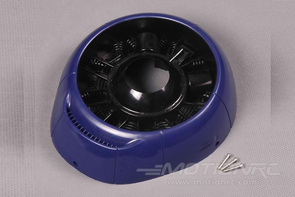

                                    • Hello pilots....................I'm sure you've see the great paint works done by Ben (AkumaZeto) on the sticky thread Pilot Painting Service.

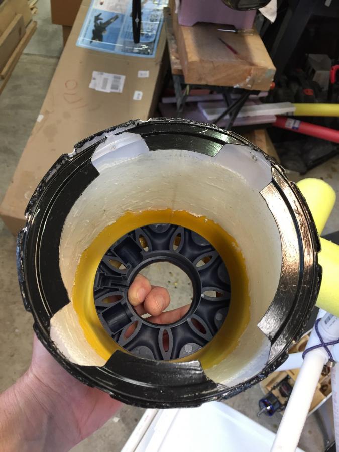

                                      I just finished painting the faux radials for my 1/9 scale ASM A-26 and 1/7 scale ESM F7F and with approximately 2 hrs of mod work and 8 hrs of painting, I can really appreciate Ben's level of talent and patience.

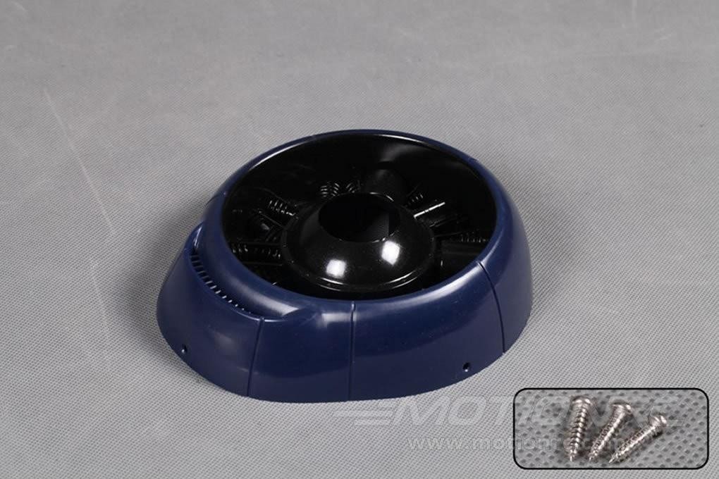

                                      Here's what I started with, FMS 1400 & 1700 Corsair cowls which are 1/9 and 1/7 scale respectively which gave me the foundation for faux radials.
                                      Click image for larger version  Name:	FMS-1400mm-corsair-cowl.jpg Views:	1 Size:	129.9 KB ID:	130293Click image for larger version  Name:	fms-1700mm-corsair-cowl.jpg Views:	1 Size:	132.8 KB ID:	130294

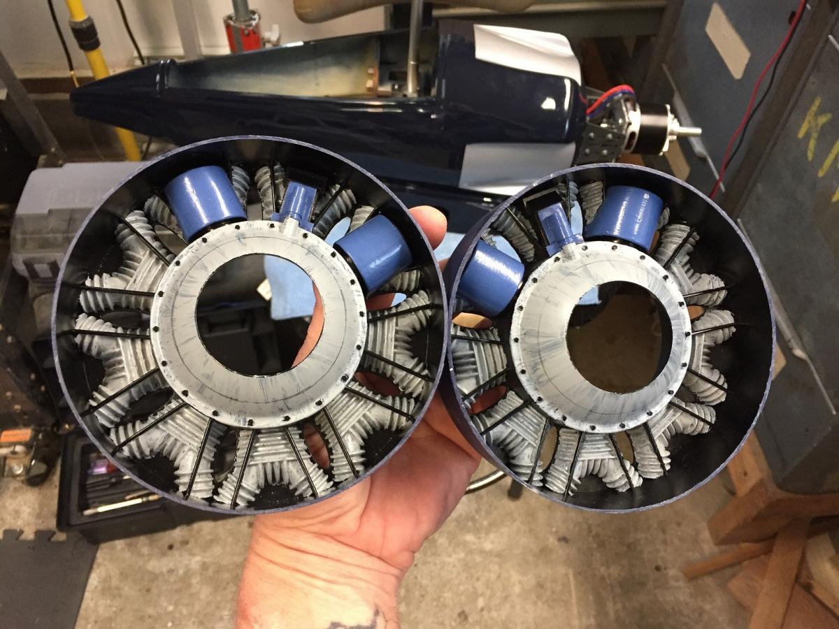

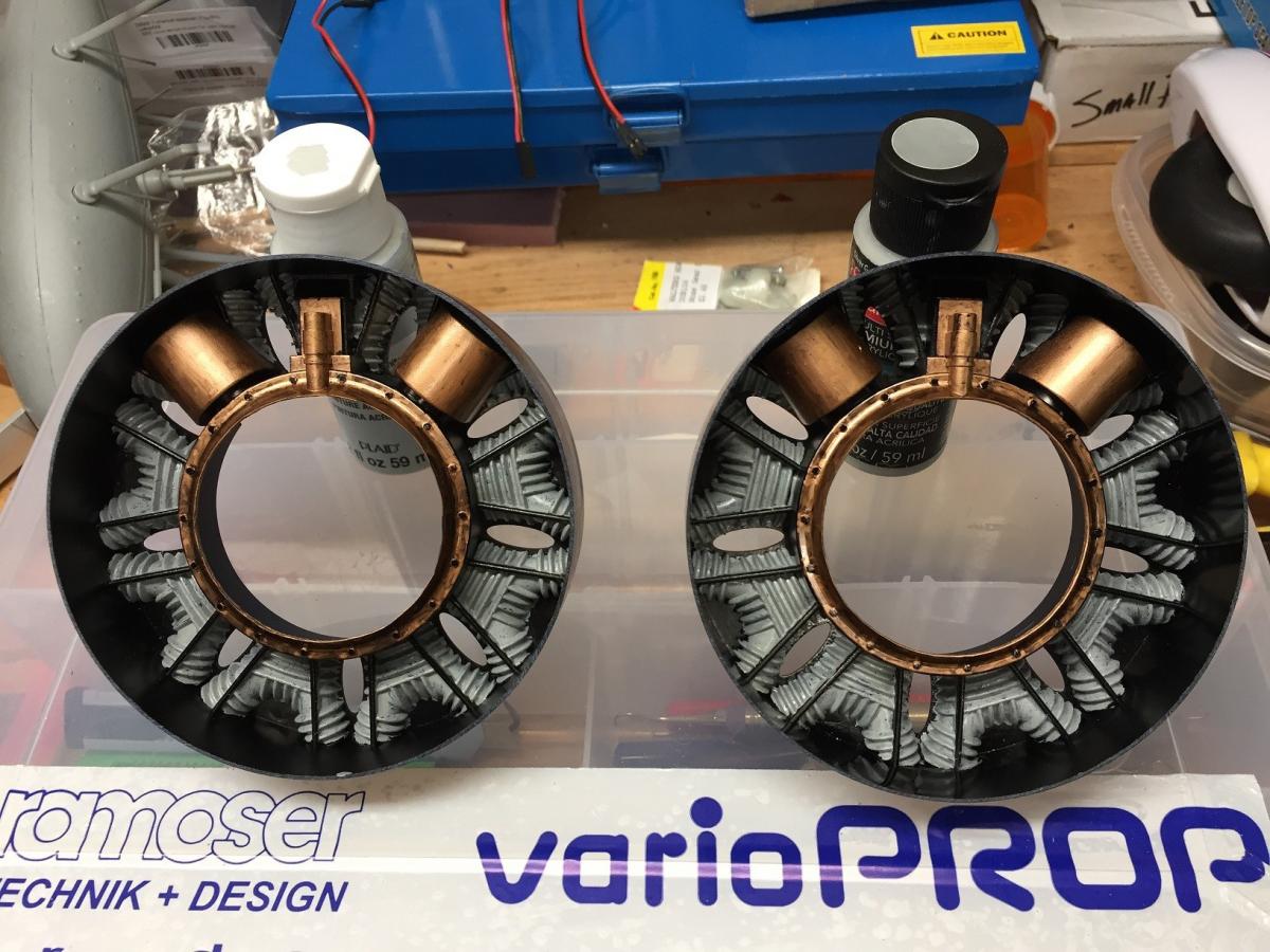

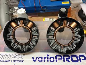

                                      Here they are with the outer shells cut away and the painting completed.
                                      Still have to hog out the center of the Tigercat radial on the right before installing in the cowl.
                                      Click image for larger version  Name:	IMG_0799.JPG Views:	1 Size:	150.9 KB ID:	130295Click image for larger version  Name:	IMG_0823.JPG Views:	1 Size:	151.8 KB ID:	130296

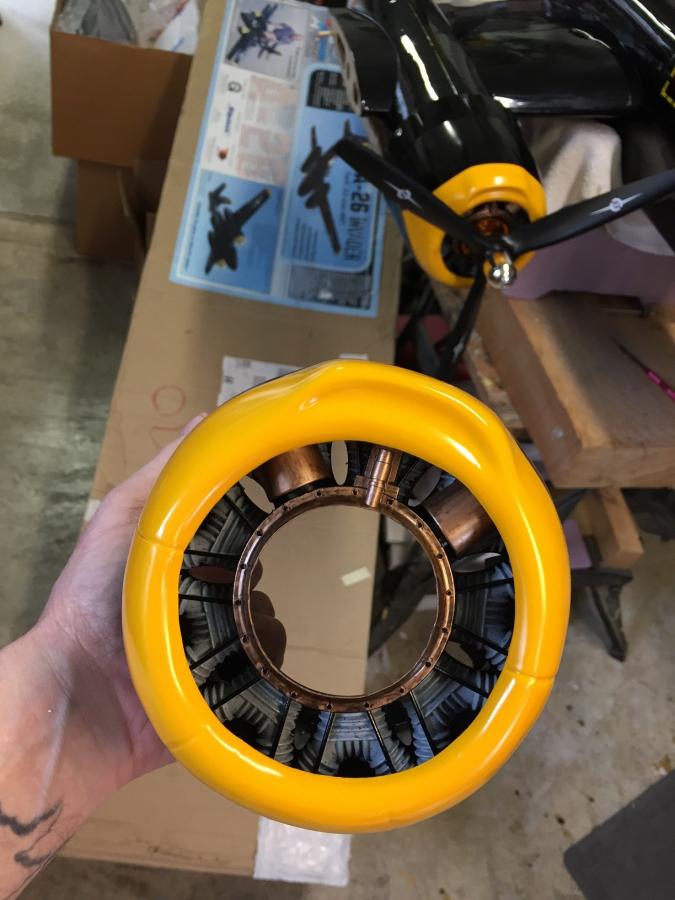

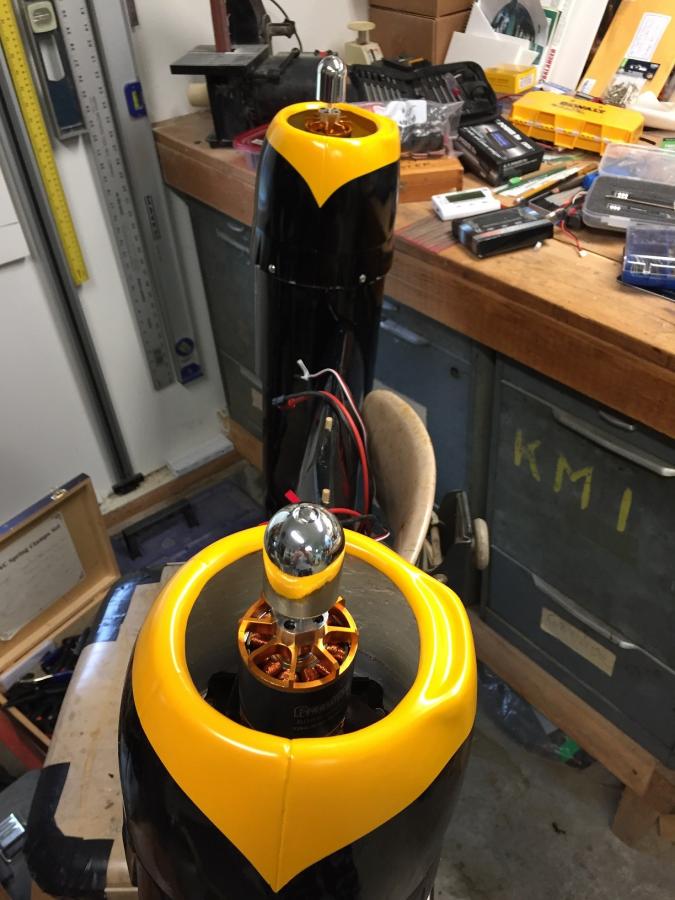

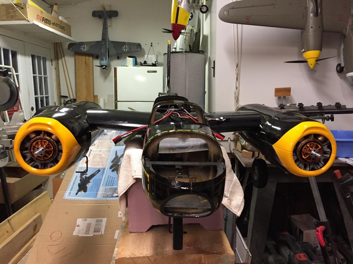

                                      Here's the 1400 radial on the 1/9 scale A-26 cowl
                                      Click image for larger version  Name:	IMG_0798.JPG Views:	1 Size:	80.1 KB ID:	130297Click image for larger version  Name:	IMG_0802.JPG Views:	1 Size:	68.3 KB ID:	130298Click image for larger version  Name:	IMG_0803.JPG Views:	1 Size:	80.2 KB ID:	130299Click image for larger version  Name:	IMG_0804.JPG Views:	1 Size:	140.3 KB ID:	130300
                                      A little side note about the power plants. Am using the FlightLine 1600 Spitfire motor in the A-26 and the Tomcat G160"s in the Tigercat.
                                      I plan to start separate build threads for each plane once I have enough progress and pics.............. stay tuned.
                                      • OV, I'm just curious. what kind of paint did you use?
                                        Still Learning:D
                                        • Walmart's Apple-Barrel brand acrylics. They carry the rainbow spectrum in flat & gloss and some basic fluorescents.
                                          Almost forgot.........the copper looking cans on the A-26 radial was done with a Sharpie - bronze metallic. ;)
