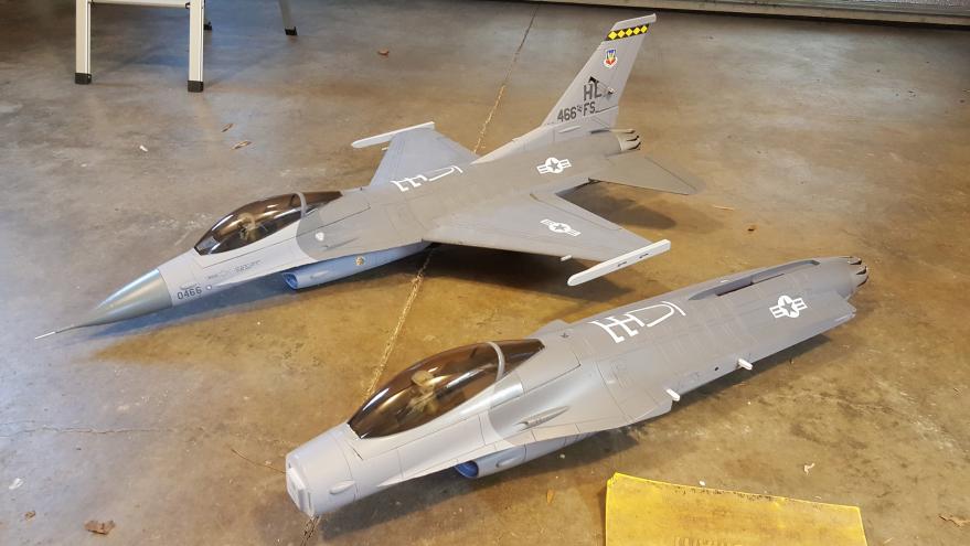

                    I use the acrylic gel as a clear top coat. I don't mix it with the paint. I just brush it on after painting and decaling are complete. It will make even a high gloss paint, very dull.
                    Here's an example with the FW 70mm F-16. The one with the wings on is coated with the matte medium. If you look at the canopy frame you'll see the difference.Click image for larger version

                      I do see the difference. Did you paint the nose cone with the matter gel?
                      • vduniec
                        Hobby Squawk Pilot
                        • 314
                        #2311
                        No. I painted it a different color and left it semi-gloss.
