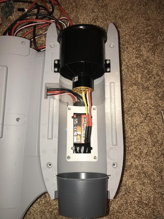

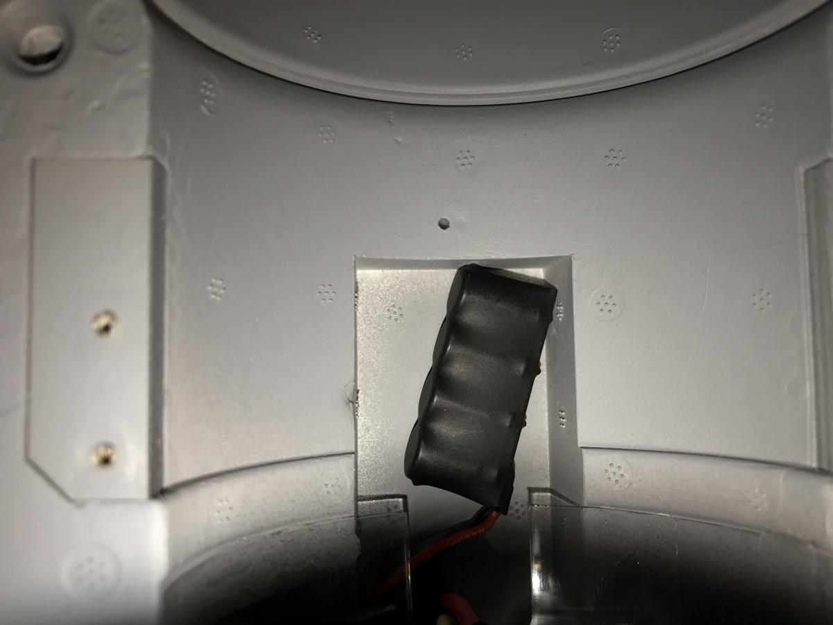

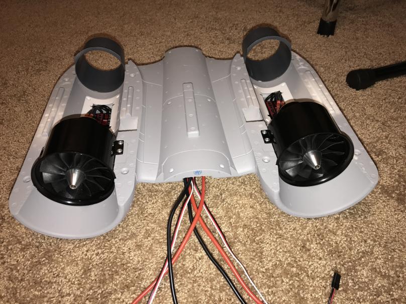

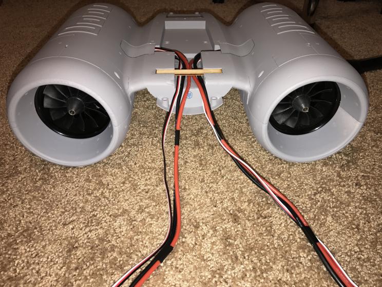

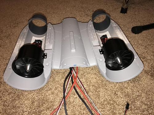

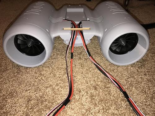

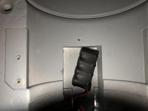

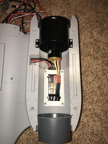

ID:	80074 Well, I ordered the 90mm nacelles and had two Stinger 90 power plants ready to be installed......until I checked the motors on both of them. I bought one of the power systems from the classifieds on a different forum, and the other is mine. Well, mine was indeed the 1450kv motor because it came out of my Stinger 90, and the other was a 1550kv motor that's used in many of the new scale 90mm Freewing jets. So, that mission stalled until I get another power plant to make the perfect match. Good thing I checked, otherwise it could have been bad news.
      So, plan B......installed the two 80mm Freewing inrunner power systems instead. I can use the stock ESC's and they're good to go. Instead of running the wires underneath the clear plastic covered channel, I had to have the wires out on top due to the shorter wiring of the inrunner motors.
      Also, a nice little detail and surprise was the extra capacitors that are added to the ESC's. That's a good call to help with longevity and functionality of the ESC's.
      Click image for larger version  Name:	IMG_1199.JPG Views:	1 Size:	99.7 KB ID:	80073Click image for larger version  Name:	IMG_1197.JPG Views:	1 Size:	67.7 KB ID:	80072Click image for larger version  Name:	IMG_1194.JPG Views:	1 Size:	64.0 KB ID:	80071

                          #3852
                          T-CAT, what do you mean that the capacitors were a nice little detail and surprise? Did the 80mm come with the caps on the ESC's?
