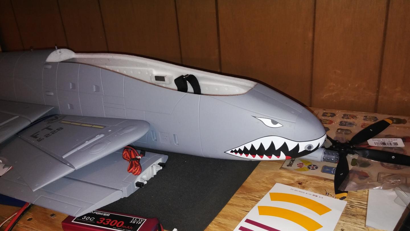

  • Only got as far as pulling out the elevator, vertical fins and fuselage front so far.
    Managed to get the nose art and most of the vertical fin markings put on without screwing it up too bad. Been a while since I've messed with water slide decals. Click image for larger version

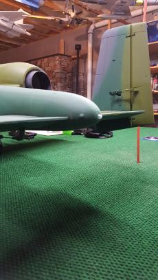

      Anyone have a picture of the so called "correct elevator position" called out in the manual? Maybe a measurement up from the bottom of the rudder or something.
      Here is where mine lines up. Pretty much in line with the dimples on the back of the fuse.

      • I don't have a picture but mine trims out at about 8mm up from neutral for flight.

          That's where I'm at too...."The Dimple Line"

            Did you use and type of decal solution to attach the nose art?

                  Just warm tap water. But, who knows what kind of chemicals are in it these days.

                      Thanks. Seems like a lot, but if that's what it takes then I'll set mine close to that for the maiden flight.
                      • That looks like about the same as my old LX needed.

                                        • I see many comments about the water slide decals being applied...one thing I do know from many years of scale model building is water slides like a gloss surface to lay on ...Future Floor wax works great..or is it called something else now? but anyway... after the gloss (let it dry) then apply the decal, use some solvent to soften it up ...after its dry and settled ,apply another coat of gloss over it, dry ,and then a dull coat... this will keep it from silvering,and/or peeling off . If you just apply the decal by itself , most likely it will begin to lift after a while and flake off.
