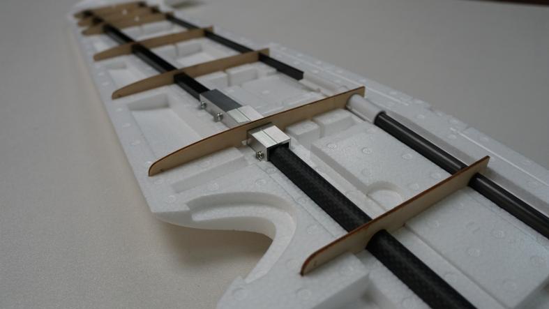

                            Some of the time we added to this project was spent "Future-Proofing" the A-10 for 90mm power systems, above and beyond the stock 80mm power setup (which I still maintain will satisfy 90+% of you). The more we thought about it though, the more we accepted that the reinforcing time was time well spent to ensure the A-10 could handle the abuse I know some of you are planning for it with even faster and more thrusty power systems with the 90mm nacelle (shown above, sold separately). Queue diabolical speed-hacker laugh.
                            Here is a photo of the final production wing. Not content with the strength of a traditional solid foam and double spar wing on an aircraft of this size, we tested and tested and tested then finally settled upon the wing structure shown here. The aluminum caps set the dihedral and keep it there, the plywood ribs intersected by the carbon spars distribute loads evenly throughout the buttressed foam bulkheads. Sharp eyes will notice that the main spar tube is not your typical tube, either. It is woven ;) The secondary outer spars are square rod. The wing's flying surfaces are all gapless hinged, and individually reinforced. Finally, the main wing on the Freewing 80mm A-10 is made 35Bei foam, which is the heavier but stronger foam that HSD uses. The fuselage is 25Bei, which is what Freewing has been using recently (such as the F7F) and for quite a while. It is in general a better balanced strength/weight foam for most of Freewing's "normal" sized models, but the A-10's wing benefits from the 35Bei foam. The horizontal stabilizer also follows this construction, with plywood ribs and square rod spars throughout.
                            In summation, the model can be held be two people six inches in from either wingtip, and even the load in dives at 140mph won't snap the wing. But please, do try to fly her scale first.
                            Click image for larger version Name:	DSC08872.JPG Views:	1 Size:	28.8 KB ID:	68946
                            Alpha,
                            Thanks for all the great design work to ensure the strength of the wing! This gives me hope that some day in the future you'll be able to get foam wings into the 80 inch "IMAA" range. I'm tired of not be able to fly my very scale foam warbirds in "warbird events" because they don't meet the size requirements of a now defunct organization. Can you imagine what the "ole gassers" would say?:Confused::Cool:
                            Sean

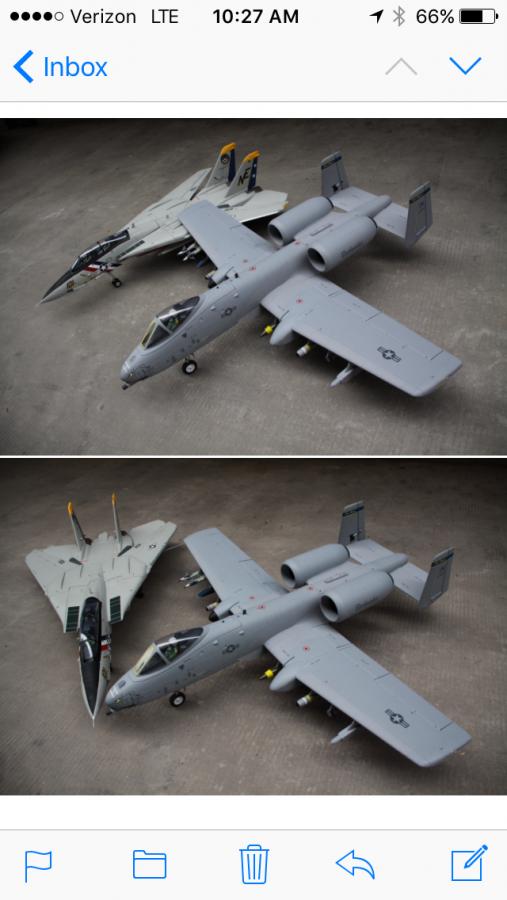

                                Anyone who has seen the F14 will get how much airplane the Thunderbolt truly is. Wow!
