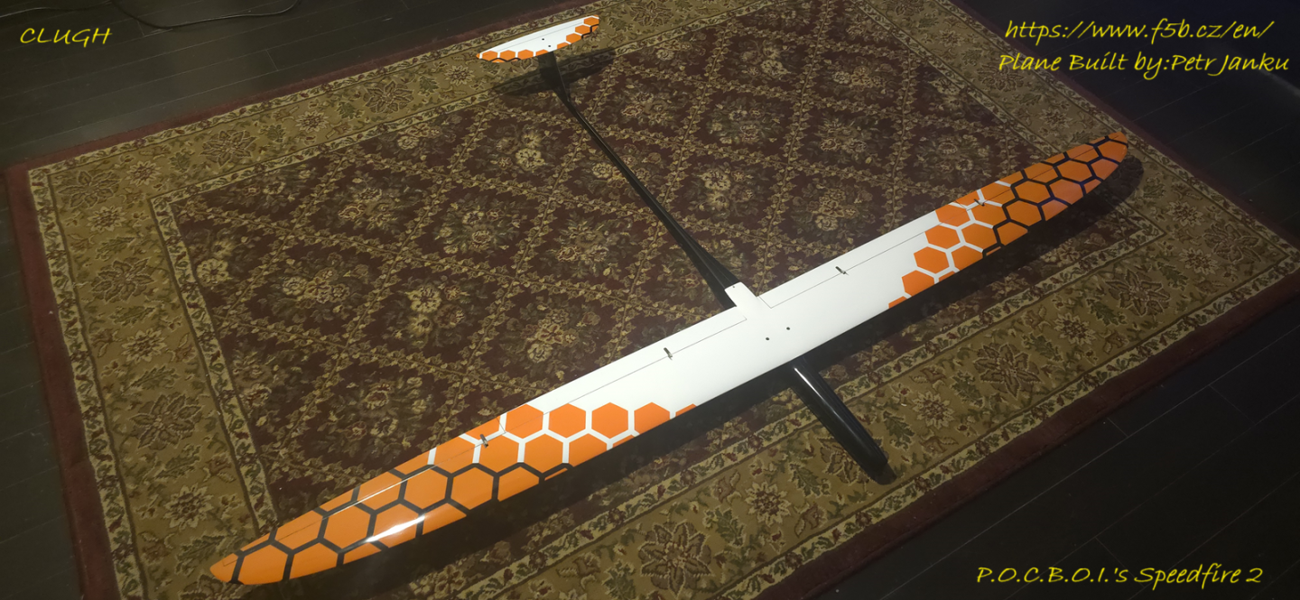

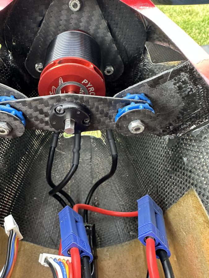

    Click image for larger version  Name:	My Plane.png Views:	0 Size:	1.58 MB ID:	413925Ich weiß, dass es dir gefällt, und ihr auch. 🖤

        Ich weiß, dass dir mein Flugzeug auch gefällt. Groupie.

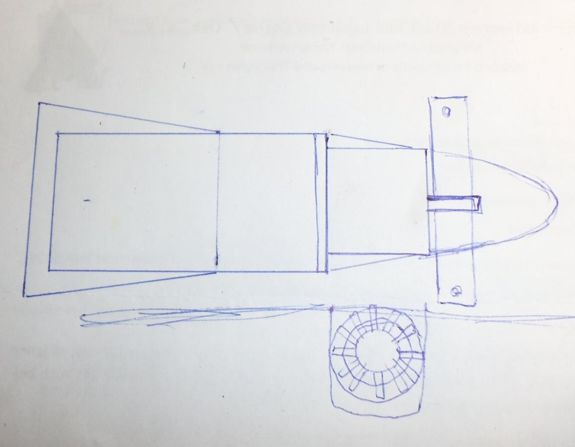

              User Since I want to concentrate more on spinning around in the future, here is my version of the gearbox drive for the inrunner fans.
              However, it is more inspired by the common practice of speed flying.
              The first major development:
              I switched from pencil to ballpoint pen when sketching.
              Of course, I'm not thinking of a Lehner motor, but of the internal rotor system with iron stator, which - as already shown on Pletti or Leo or Mega or Castle etc. - can very well be wound exactly to the desired speed.
              The engine sits - as is customary for speeders and well cooled - in front of the fuselage frame in a conical ribbed holder. The engine is screwed into it from behind. the gearbox gets just such a conical ribbed cooling ring.
              Of course, the outlet of the ribbed base at the back should not be blunt, but should run out in an arc on the diameter of the fuselage.
              Since the current planetary gearboxes have a reduction ratio of at least 3.7:1 (KPG), you get a maximum of 10 to a maximum of 12krpm at reasonable engine speeds.
              With 5kW power throughput and a suitable 35"-45" rising propeller (which is also available and tested and also available for purchase), you would very well get into a competitive speed range with a small 2-2.5kg speeder in the competition design.
              Maybe one of the CAD-capable people would like to convert the sketch into a contemporary 3D advertising image?
              I would be happy and would be happy to answer the detailed questions about it.
              Appendixes
              • Click image for larger version  Name:	100_3656-jpg.12839160.jpg Views:	0 Size:	52.1 KB ID:	413938 100_3656.jpg 191.5 KB · Views: 31

                Click image for larger version  Name:	My Plane.png Views:	0 Size:	1.58 MB ID:	413941 Jetzt können wir uns wieder dem zuwenden, was wir nicht haben und was wir nicht tun können. Ich suche nach Krokodilskraft in der Luft oder im Wasser. Das ist mir egal. Ich möchte nur den Müll versenken, damit Ihre kleinen Freunde ihn sehen können. Meine Methodik ist etwas anders als die der Christen. Ich muss nicht an der Tastatur sitzen und mit Ihnen spielen. Ich mag Zahlen und wenn die Leute sie nicht teilen, können Sie sicher sein, dass es Müll ist.
                Posten Sie etwas Relevantes über die schlechte Wärmeleistung Ihres Motors mit seinen 180 °C-Magneten in den Foren. Dann entschuldigen Sie sich bei allen Speedpilot-Wechselrichtern, die er beim Zusammenstoß mit einem Demag zerstört hat. Außerdem war es Thomas Idee, nicht deine, und er fliegt schneller als du, also warum redest du überhaupt? Du bist dort nicht der König und der Skorpion auch nicht.

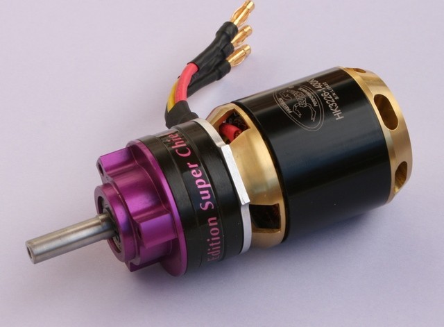

                      Hi,
                      yea the old retired slep for four years , my old gear double propeller dual gear speeder setup from 2020
                      Hallo Steve! Der Motor soll eine Weiterentwicklung des bewährten "HK 5040 Speed" sein. Veränderungen im Innenleben sollen dazu führen, dass er im FAI konformen Setup mit einem sensorlosen Modellbausteller später "aus dem Tritt" fällt. Damit soll mehr Leistung abrufbar sein. Mehr weis ich auch...
                      answer #40
                      Happy Amps Christian

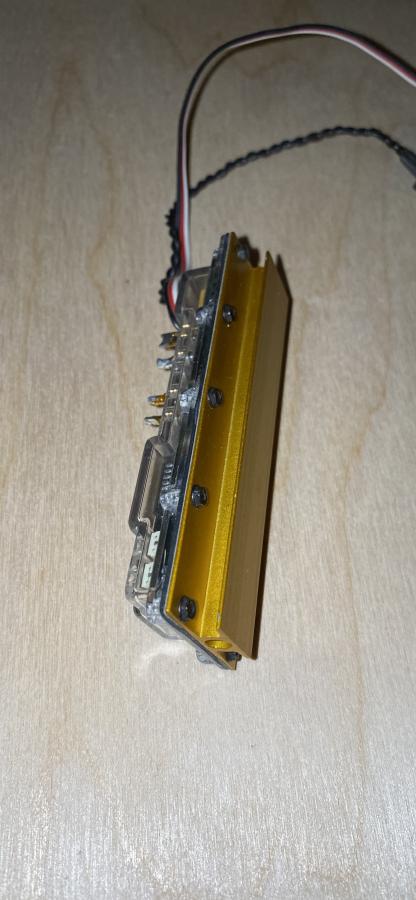

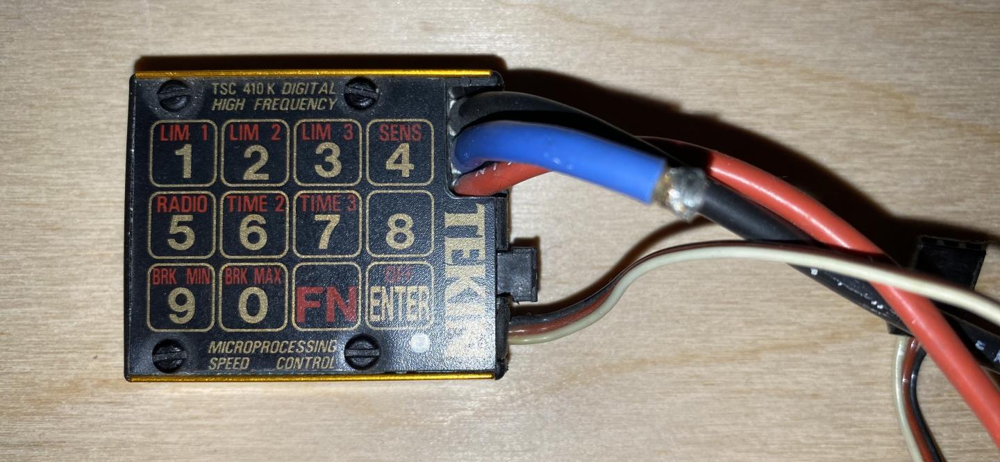

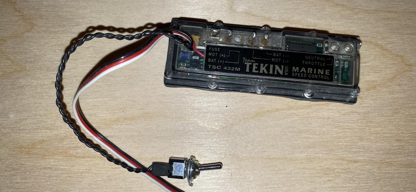

                              Hi Hubert ,
                              i want to show you the old but very good esc from Tekin . First micro processing speed control and the bigger one for boats with watercooling heatsink.

                                Oh yes I had a few and novaks too. Those were the days.

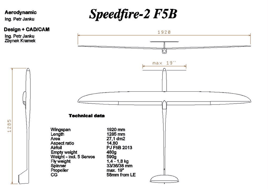

                                  the plane is a winner. Sleek aerodynamic right made. How is the dia of the fuselage and how many space inside for batteries ?

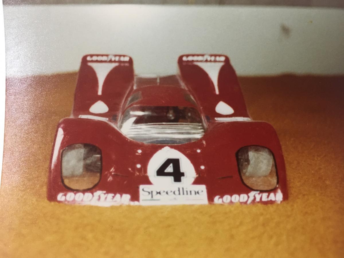

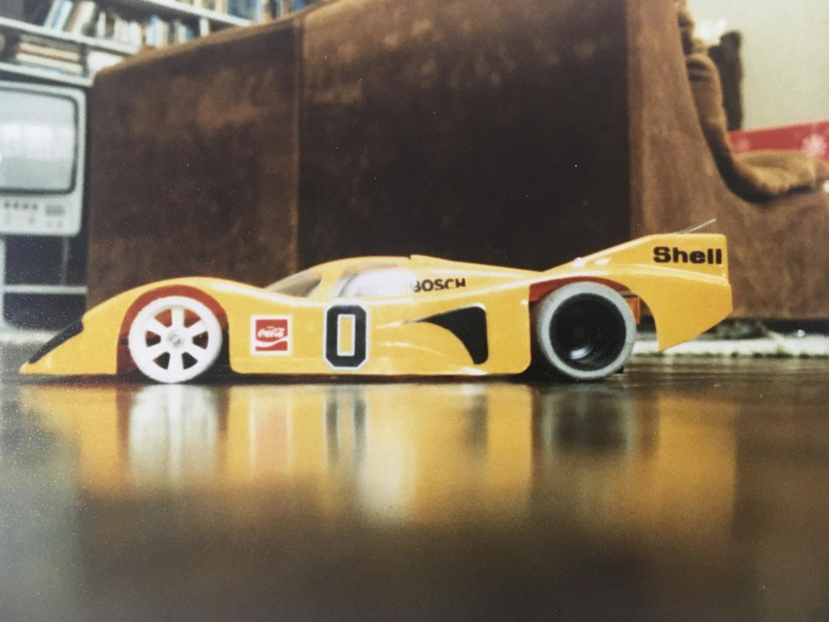

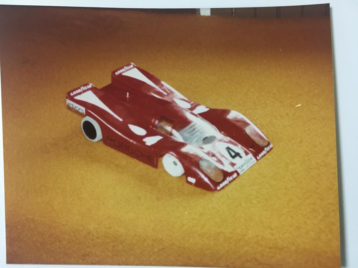

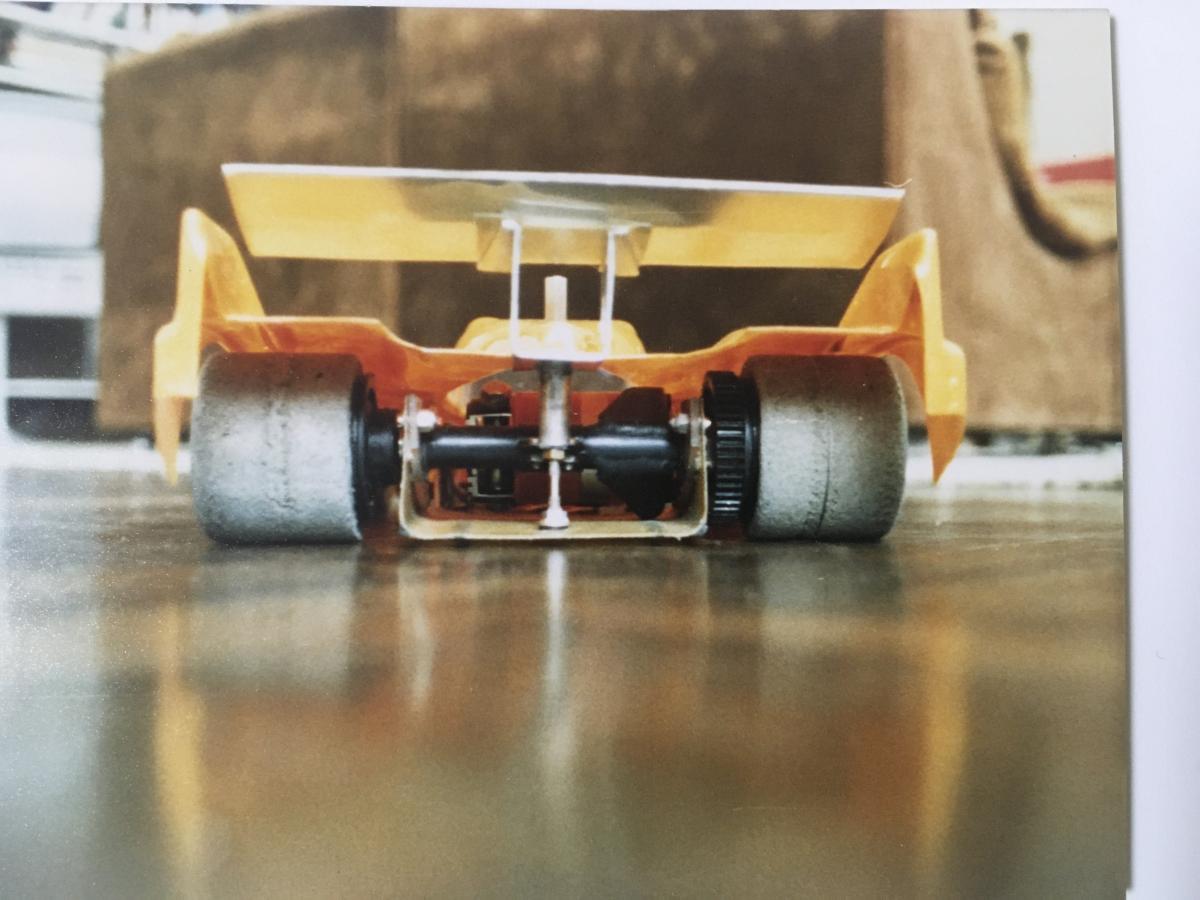

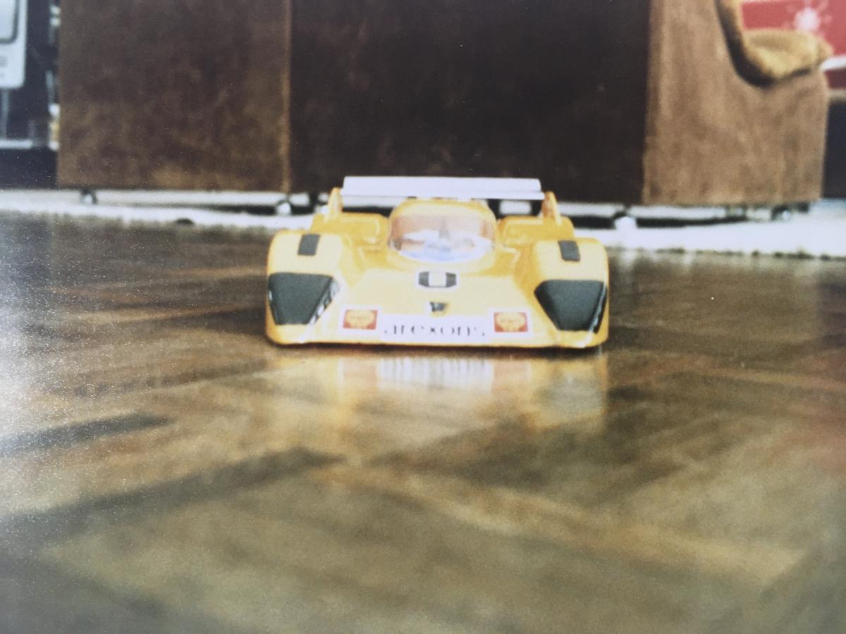

                                  The Asso 10th Scale inroad car was the best 1:10 inroad race car. I have run in winter indoor 1:12 inroad cars. My friend was director of the Highschool in Starnberg where we can use the gym .
                                  The cars are very low and i used my owen designed 540 motor size with samarium cobalt magnets that has much smaler dia and less waight and was much stronger because of the higher magnet flux. Nice time , we have this year a new location where we can run for fun.

                                    Hallo Christian, das Flugzeug ist ohne Zweifel großartig. Petr ist ein großartiger Ingenieur. Wenn ich es in den Händen halte, bekomme ich eine hervorragende Vorstellung davon, wie man es baut. Es ist eines der schönsten Modelle aus allen RC-Sportarten, die ich je besessen habe. Die Verbundarbeit ist 100 % einwandfrei. Er hat die oberen KSTs in den Flügel eingebaut und der Flügel sieht absolut aus einem Stück aus und ist dünn wie eine Messerklinge. Man würde nicht denken, dass hier ein Servo hineinpassen würde. Ich würde es hassen, Petr einen Hydro im Maßstab 1/8 bauen zu sehen. Der Bohemian ist ein böser Bruder. WOW! Das native F5B-Flugzeug kann 10 Zellen aufnehmen. Ich habe den doppelten Carbon und den verstärkten Holm und das Gurtband, . Dies ist seine stärkste Version, die Petr baut. Ich kann mir nicht vorstellen, dass ein 35er-Außenläufer in den Rahmen passt, aber ein 32er-Außenläufer auf dem Getriebe würde passen. Der Motor hat laut Geben und Heiko ungefähr das richtige Gewicht für den Wettbewerb. Ich denke, sie wissen es. Heiko ist im Moment der absolute Gewinner in F5B und Gerben braucht keine Einführung. Die Motoren der 32er-Serie haben eine Dauerleistung von etwa 2000 Watt. Der 260 gram Pyro, den ich einsetze, der Brenner-Gegenantrieb ist der 10S-Motor. Ich weiß aus der Praxis, dass er bei Ausdauerwettbewerben mit vielen Anstiegen etwa 4000 Watt und 90 Ampere leistet. Er läuft dort kühl und effizient, daher denke ich, dass er ein großartiger 10S-F5B-Antrieb auf einem Maxon P32 3,7:1 wäre, und er ist auch ein F3A-Motor auf dem 7:1. Also ist das cool für mich. Ein HK COTS der 35er-Serie hat eine Dauerleistung von 2900 Watt und wiegt etwa 365 Gramm. Wissen Sie, einige der besten Motoren der Welt dafür sind die 40-mm-Motoren aus Amerika. Ich würde also vergleichsweise einen 1521 drehen. Ich bin mir nur nicht sicher, ob ich 10 s maximale Spannung wählen oder die Vierteldrehung machen und die 6,7-1 in 2 s mit einem 1000-Ampere-Antrieb wie dem Tekin für maximalen Strom laufen lassen würde. Die Arbeit an den 44-Pitch-Propellern erfordert etwas weniger als 5 Nm. Ich habe es irgendwo aufgeschrieben und gepostet. Ich genieße 1 Prozent der Ninja-Geschwindigkeit. Und ich denke bereits darüber nach, was ich tun muss, um einen 1,8-2 Meter großen Flügel für ein 16-s-Geschwindigkeitsflugzeug mit einem schlanken Rumpfprofil wie dem von Petr zu entwerfen. Ich bin ziemlich sicher, dass ich mit Hilfe von 3dp und einigen meiner Tricks und Erfahrungen aus dem Bau von Tragflügeln einen Verbundflügel bauen kann, der stark genug ist. Ich habe da ungefähr 35 Jahre Erfahrung. Ich werde ein paar dieser Getriebeantriebssysteme für die Flugzeuge bauen und sie hier in die Kleinanzeigenrubriken stellen. Ein Flugzeug von Grund auf zu bauen, das sie fliegen können, könnte den Sport wachsen lassen. Aber wie ich sagte, der kleine Pyro mit Getriebe sollte mit seinem Gewicht und 4000 Watt Spitzenleistung einen extrem schnellen F5B > 70 m/s bauen. Der Propeller müsste optimiert werden. Vielleicht gekürzt. Für 160 m/s in einer Zündschnur dieser Größe scheinen, wenn möglich, Steves 40 mm die effizienteste Option zu sein, und auf den Rechnern sehen sie ausgezeichnet aus. Eine 45 mm passt nicht. Eine längere 19er-Serie mit etwa 360-460 Gramm scheint eine weitere großartige Option zu sein. Für eine große Zündschnur wie die Monsters nehmen Sie einfach Ihre 41er-Serie. Sie ist zwar größer, bringt aber wahrscheinlich 18 kW im Getriebe. Das Ziel für die großen Flugzeuge scheint bei 2500 kg zu liegen, während ein Speedfire fertig bei etwa 1700 kg liegen sollte. Es ist also nicht beabsichtigt, gegen ein Flugzeug mit einer doppelt so großen Zündschnur und einem dreimal so großen Motor anzutreten. In den unteren Klassen unter F42 und darunter könnte es etwas bewirken. Ich arbeite fleißig an Zahlen für den perfekten Innenläufer für ein Getriebe. Es wird kein Scorpio sein, und was auch immer es ist, es wird den Scorpio bei weitem übertreffen. Die Effizienz ist mit dem Powerturd einfach nicht gegeben, und Durchsatz und Batterieverbrauch werden beeinträchtigt. So oder so, das ist ein verdammt guter Ort, um sich die Füße nass zu machen, und ich will verdammt sein, wenn es nicht schön ist.
                                    Click image for larger version  Name:	My Plane.png Views:	0 Size:	1.58 MB ID:	413998

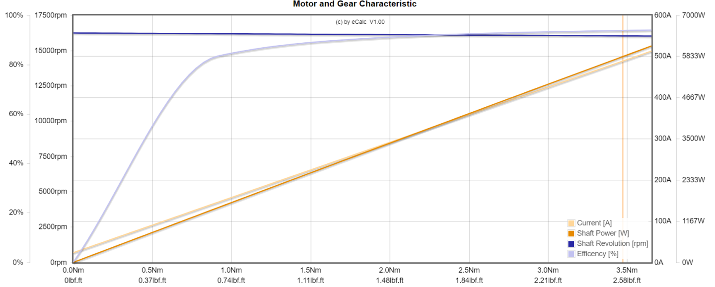

                                      Hi Ralph,
                                      A 1530 .5D TL4 Vierteldrehungsdelta auf 3s Lipo kann einen GM 11x23 mit 15.419 U/min auf einem Maxon P32 6.7-1 Planetengetriebe drehen. Dort ist der Motor zu 95 % effizient, der Gesamtantrieb mit Getriebe beträgt 93,78, die Stromaufnahme beträgt 470 Ampere. Ralphs Direktantriebe und YGE-Wechselrichter würden da durchbrennen und sein Motor kann das bei 50 °C auf keinen Fall schaffen. Sein Thumper müsste auch in ein Gehäuse für einen 33-mm-Spinner passen und ihm 3,7 Nm bei 15.419 U/min liefern.
                                      Click image for larger version  Name:	fetch?id=413614.png Views:	0 Size:	144.2 KB ID:	414003
                                      We dont need to consume 14 kW to fly as fast and fit under a 33mm spinner

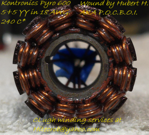

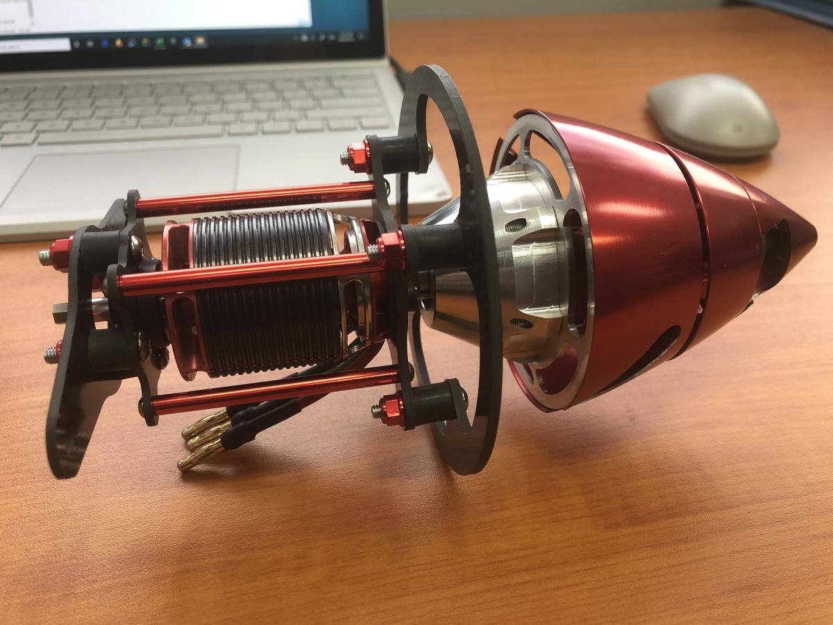

                                        Click image for larger version  Name:	img_4512_3a0ce0182ac5d2af2e0f7f43172a9e64d5dea62f.jpg Views:	0 Size:	127.5 KB ID:	414014
                                        Hello Christian,
                                        Well..Thomas weiß es am besten. Sie sind sicherlich die besten Ingenieure.
                                        Mir scheint, dass ein besserer Schmittyspeed 4:1 ein 3240 UETW-Schnitt wäre, der sich für mehr Geschwindigkeit im Speedfire2 ideal eignet. Da er intern im Rahmen montiert ist, muss man nur eine Welle verwenden, die über das andere Ende hinausragt, und sie mit einer weiteren im Rumpf montierten Kohlefaserplatte stützen, die ein zusätzliches viertes geflanschtes Keramik-Hybridlager aufnimmt. Für mich klingt das nicht so, als ob sie die Dinge durchdacht hätten. Ein längerer Glockenmotor ist in diesem Fall kein Problem.
                                        Click image for larger version  Name:	IMG_0944 (1).jpg Views:	0 Size:	129.5 KB ID:	414015
                                        So traurig um die Goofy-Truppe und ihre beiden Regisseure.
                                        Keine Lösungen.....
                                        dumm 🐊
                                        Hubert

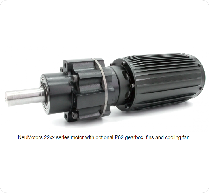

                                          Click image for larger version  Name:	fetch?id=414014&d=1711657807.jpg Views:	0 Size:	182.5 KB ID:	414022
                                          They are crazy Chris,
                                          I'll simply have Brenner revise the gear housing to accept liquid or gas cooling. Ferrofluid wouldn't need a pump to create a cooling flow loop. Were already several steps ahead here as the drive is already up to a 7:1 and ready for the high speed outrunner or inrunner😀
